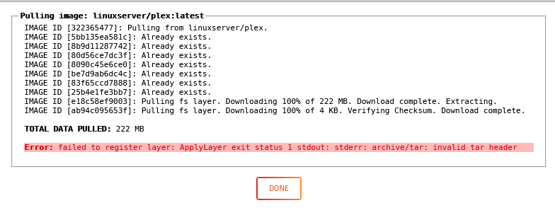

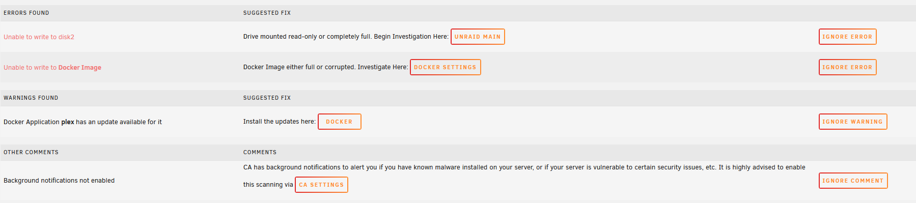

August 12, 20215 yr I have been using unRAID mostly to run a 24/7 Plex server for the past couple of years without any issue at all. Today, suddenly my Plex server wasn't reachable. I first tried to reboot my router and then reboot the unRAID server and since both didn't help, I had a closer look. I realised that there was a new notification about "Fix Common Problems" which was new (I check every day). There was a "Unable to write to disk2" and a "Background notifications not enabled" error / other comment. I didn't really know what to do. I went to the docker tab and checked for updates and there was indeed an update for the Plex docker. I tried running it but there was another error message - see attachement. I let it be for a bit and checked later again and now there is a second error message "Unable to write to Docker Image" - see other attachment. When I follow the "unraid main" or the "docker settings" button showed in the suggested fix, I don't really know what I'm supposed to do. The disk2 is indeed full (but there are 3 other disks which still have plenty of space). I don't know how the Docker Image is full or corrupted and what I'm supposed to do about it.

August 12, 20215 yr Community Expert Your system share has files on disk2 instead of all on cache as it should be. Don't know how you got into that state. Perhaps you enabled dockers when you didn't have cache at some point. You shouldn't let any of your disks run out of space or you may corrupt it. Each user share has a Minimum Free setting. Unraid has no way to know how large a file will become when it chooses a disk for it. If a disk has less than Minimum, it will choose another disk. You should set Minimum Free to larger than the largest file you expect to write to the share. Each pool (cache) has a Minimum setting that works in a similar manner. If the pool has less than Minimum, it will choose an array disk when writing a cache-prefer or cache-yes user share (overflow). You should delete and recreate docker.img https://wiki.unraid.net/Manual/Troubleshooting#How_do_I_recreate_docker.img.3F Before enabling dockers again or indeed using your server for anything you should take care of your disk full situation.
