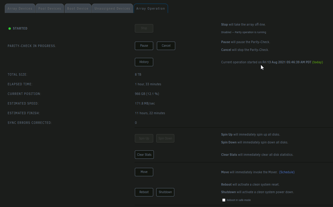

Is it ok to let parity check finish? I will have to remove one of my drives/ pcie card to put a video card in.
It's OK, but if it's a correcting check and there is a RAM issue it can corrupt parity, no problem if it's non correcting.
Yeah, everything looks good so far. I am hoping it is ram related, that would be an easy fix. I had some Corruption issues a few weeks ago too. (you can see my other posts) however this isn't as bad because I don't think any data was lost, and I am pretty sure it was bad drive related.
