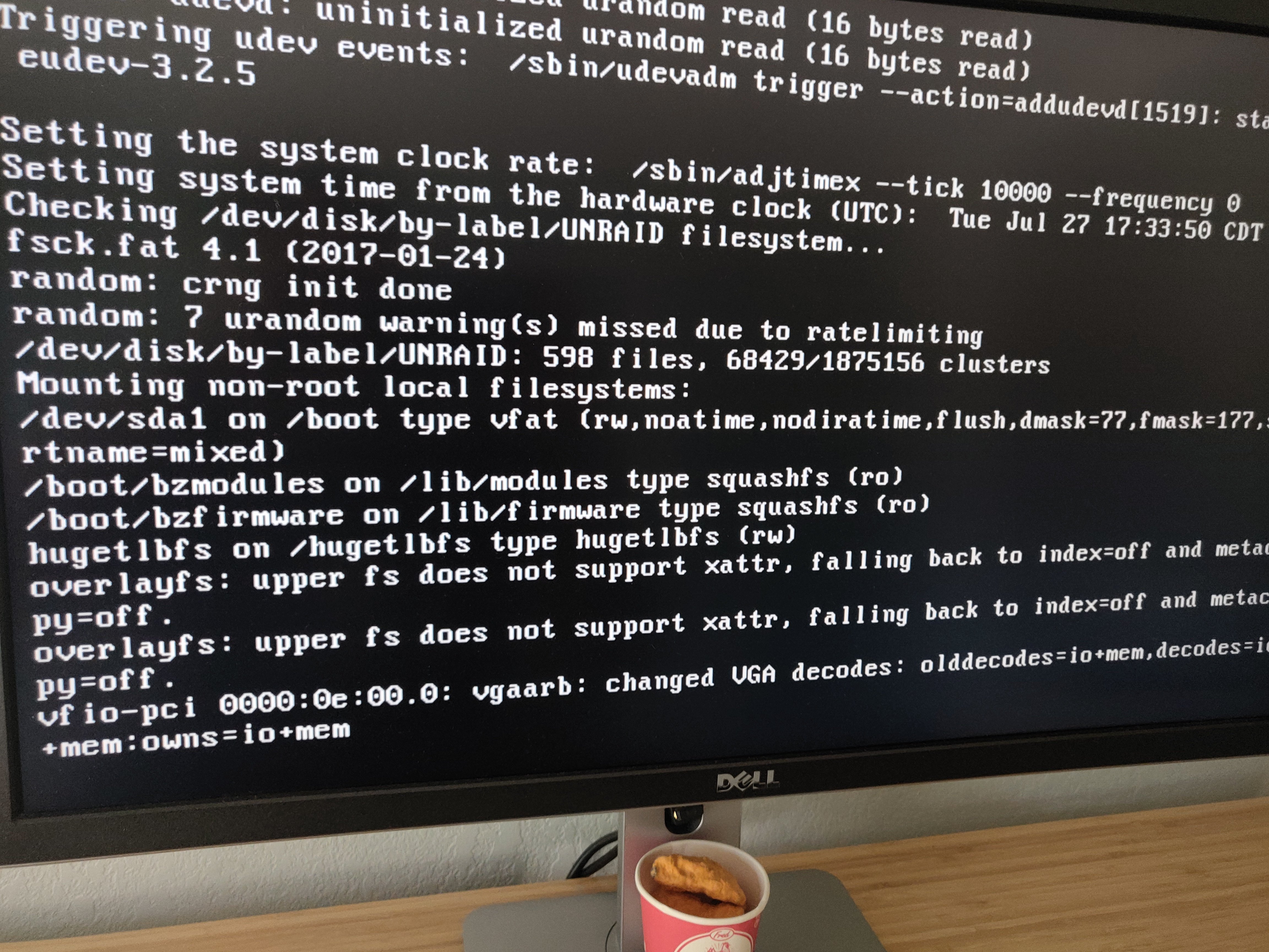

August 13, 20215 yr At the end of Unraid boot, I'm not seeing an IP and login info. Can anyone provide any assistance? Thanks!

August 13, 20215 yr That was the end on my on screen updates also. That is caused by the video being selected in Tools->System Devices and then having the Video bound to VFIO-PCI. If your not actually passing thru the Graphics card to a VM, then you probably don't need that to be selected there. Once the system gets to that point in boot, it no longer has access to the video card and does not continue logging boot process to the screen. Good luck!!
August 13, 20215 yr Community Expert If that's the problem deleting/renaming vfio-pci.cfg on the flash drive (config folder) will fix it.
August 13, 20215 yr Author Just now, Trucking Geek said: That was the end on my on screen updates also. That is caused by the video being selected in Tools->System Devices and then having the Video bound to VFIO-PCI. If your not actually passing thru the Graphics card to a VM, then you probably don't need that to be selected there. Once the system gets to that point in boot, it no longer has access to the video card and does not continue logging boot process to the screen. Good luck!! Got it. I have also been having issues with pass thru for VM since upgrading to 6.9.2. Will try this. Thanks!
