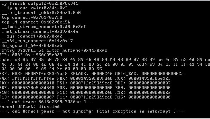

August 15, 20215 yr I've been suffering some strange crashes recently completely at random on 6.9.1. This morning it was at 00:46 The system can't be accessed at all via web or SSH. I did find this section in the log, can anyone tell what's happened here? New Text Document (4).txt
August 19, 20214 yr Community Expert Previous syslog shows many call traces, can't see the reason for them though, could be hardware or kernel related, try upgrading to v6.10 to see if the newer kernel helps, if it doesn't could be hardware.

August 30, 20214 yr Author Upgrade to 6.10RC Two crashes this week so far. ultron-diagnostics-20210830-1554.zip

August 30, 20214 yr Community Expert Problems with multiple disks. Probably controller or maybe power, splitter.
August 30, 20214 yr Author 1 minute ago, trurl said: Problems with multiple disks. Probably controller or maybe power, splitter. Yeah I know about that issue. Some of these disks (particular model) don't like being spun down, that's only a recent change though as this strange crash was happening before I set the to spin down. I have a post on the HD subject
August 30, 20214 yr Community Expert 16 minutes ago, Mr_Jay84 said: Yeah I know about that issue. Seems unusable until you get that fixed.

November 1, 20214 yr Author It may have been down to the C6 power state in the BIOS. Now disabled, it's been stable so far.
December 17, 20214 yr Author UPDATE: So the disabling the C states in the BIOS only worked for a few days. It's crashing almost daily now. Also added "rcu_nocbs=0-47" to the flash boot procedure. Still doesn't help. It's definitely related to the CPUs.
December 17, 20214 yr What CPU are you running??? First time I've ever seen this without it actually stating what it is.... Vendor ID: GenuineIntel Model name: Genuine Intel(R) CPU @ 2.00GHz It's obviously a Xeon, but what model and what stepping? Does the system event log happen to show anything (in the BIOS)
