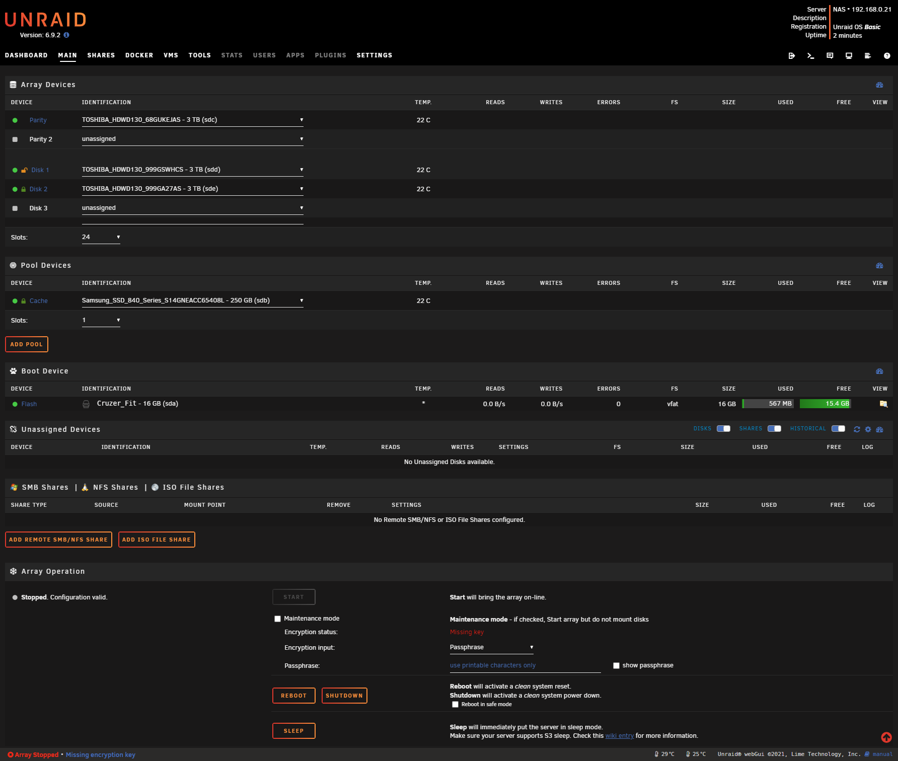

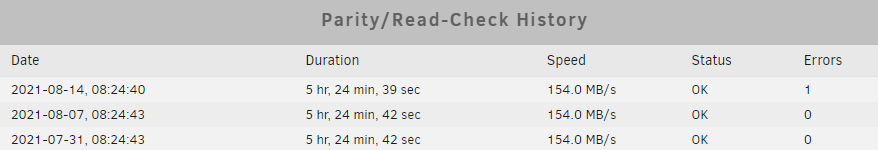

August 15, 20215 yr Hi guys  While in the middle of attempting to backup my nas with Duplicati over USB (with Unassigned Devices) for the past week, one of the disks (xfs) in my array seems to have been corrupted (great timing 😟). After almost 2 years of no issues it seems I got my first parity error last night. When I rebooted the server this morning Disk 1 started showing up as "Device to be encrypted". (Tangent: strangely enough the same thing was happening to my backups after 8h/~1TB of writes. Suddenly the disk became unmountable independent of formatting.) (Tangent 2: could the parity correction have caused this?)  I have tried to repair the disk with the included "Check Filesystem Status" tool: first I tried with, then without the -n parameter, then adding -L as the logs prompted me to do so. When this didn't work I got scared and cloned the device using a hdd dock. (Tangent 3: I probably should've done this before adding the -L option? Not sure as I cannot find a clear answer what this actually does.)  Unfortunately I do not have another 3TB disk on hand (only the 4TB I was trying to backup to) which means I cannot attempt to repair the file system on the cloned disk as the array won't let me start with a bigger data than parity disk. When I try to remove the disk and attempt to access my data via "emulated mode" , Disk 2 also shows up with "Device to be encrypted" and I am unable to fill in the keyphrase. However this clears when I reinsert the corrupt Disk 1. However, all files from Disk 1 are still missing when I browse the mounted array.  I've included 3 diagnostics zips: before the issue occured (downloaded this zip to debug the backup issue, that issue can be ignored for now) nas-diagnostics-20210814-0052.zip directly after the issue occured nas-diagnostics-20210815-1239.zip when I unplug the corrupt disk nas-diagnostics-20210815-1944.zip  How can I go about fixing this? Do I spend another €80 to buy a 3TB disk that I have no further use for to attempt a repair that way? Can I somehow fix the corrupt disk with the parity disk (read in a few posts this isn't possible, but it's not clear to me why?) Perhaps I can fix and mount the cloned corrupted drive somehow and access everything that way? Â
August 15, 20215 yr Community Expert Should have asked before doing anything.  49 minutes ago, Tuur said: (Tangent 2: could the parity correction have caused this?) Parity has none of your data. Non-correcting parity check doesn't change any disk. Correcting parity check, or even parity rebuild, only writes parity, and will not affect any of your data disks.  None of your attachments are working for some reason (I think I have seen reports that "drag and drop" isn't working at the moment).  Attach them to your NEXT post in this thread and wait on further advice.  Â

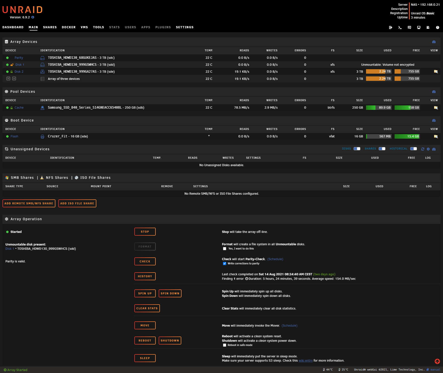

August 15, 20215 yr Community Expert Are you sure disk1 is encrypted? Â Now that you have removed it probably Unraid is going to want to rebuild it if you put it back in, so don't do that yet. Â Can you start the array and post new diagnostics?
August 15, 20215 yr Author Yes, I'm 100% certain both disks were encrypted. Since I started questioning it myself, I found some screenshots from early 2020 that show they were. Also something I forgot to mention in my first post: I swapped sata cables (same port on mobo) but that didn't change anything. nas-diagnostics-20210815-2220.zip
