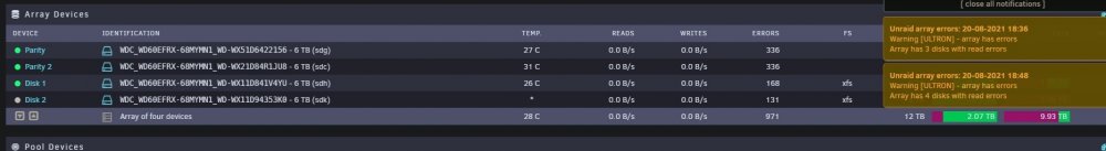

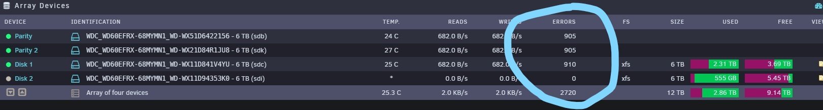

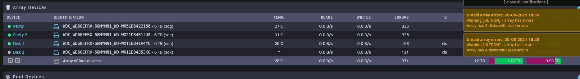

August 19, 20215 yr Author No joy. I'll try changing the SATA cables. The other consideration is replacing some of the WD60EFRX-68MYMN1 drives with WD60EFRX-68L0BN1 drives. Apparently these are all the same drive model with different firmware. There's two 68L0BN1 acting as a download cache. These have no issue when spinning up when tested and error free. I'll know more when the new cables come. Edited August 20, 20215 yr by Mr_Jay84
August 20, 20215 yr Author New SATA cables, different power chains still with read errors. I've also upgraded to 6.9.10 RC Next thing to try will be moving to an LSI card or swapping the drives for 68L0BN1 versions. Edited August 20, 20215 yr by Mr_Jay84
