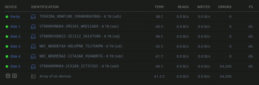

August 15, 20215 yr Just added a 8tb hdd to my 5 disk stash, the disk was all good when in disclosure. after two days the disk appeared disable, so I did a parity check on it. 54,250 Errors! but theres little to nothing data on the disk yet. Checked the SMART test and all passed. Should I be worried? Anything I need to do? unraid-diagnostics-20210815-1649.zip

August 16, 20215 yr Community Expert 18 hours ago, dotSlash said: after two days the disk appeared disable, so I did a parity check on it. Seems like you left out some things in that description. Aug 12 19:45:00 unraid kernel: md: import_slot: 5 replaced ... Aug 12 19:45:32 unraid kernel: md: recovery thread: recon D5 ... Aug 12 19:45:40 unraid kernel: mdcmd (37): nocheck Cancel Aug 12 19:45:40 unraid kernel: md: recovery thread: exit status: -4 ... Aug 12 19:46:16 unraid kernel: md: recovery thread: recon D5 ... ... Aug 12 21:35:14 unraid kernel: ata10: hard resetting link Aug 12 21:35:16 unraid kernel: ata3: link is slow to respond, please be patient (ready=0) ... Aug 13 14:46:56 unraid kernel: md: recovery thread: exit status: 0 Despite connection problems on multiple disks, disk5 rebuild (not at all the same thing as a parity check) was finally completed successfully, and disk5 is mounted. Possibly it is out-of-sync though due to problems. 18 hours ago, dotSlash said: 54,250 Errors! Where did you see this number?
August 16, 20215 yr Author Quote after two days the disk appeared disable, so I did a parity check on it. I mean the server was running fine for about 2 days before I discovered the new added disk was disable. Here is the errors.

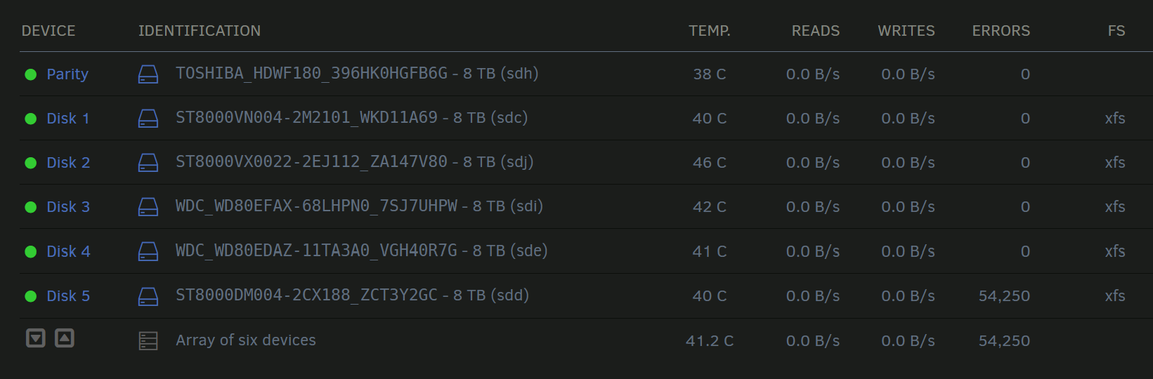

August 17, 20215 yr Author 1 hour ago, trurl said: All disks mount so that is good. so I run another parity check, and the error number is getting higher and higher.
