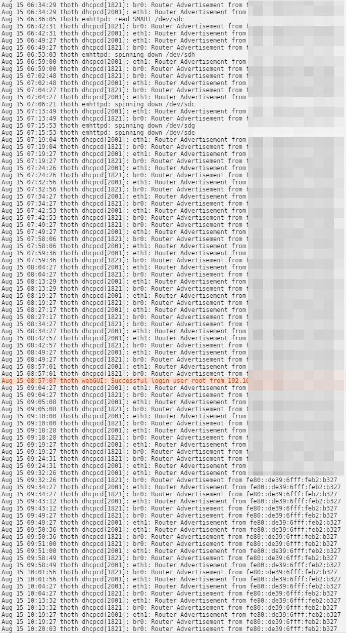

dhcpcd[xxxx]: br0/eth1: Router Advertisement from <IPv6> floods syslog
It creates a new log entry every 5 to 10 minutes:

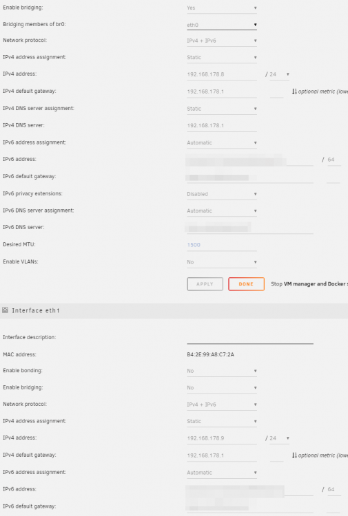

These are my network settings:

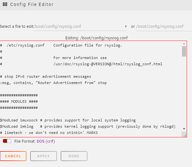

So I tried to solved this issue by adding this to the /boot/config/rsyslog.conf
# stop IPv6 router advertisement messages
:msg, contains, "Router Advertisement from" stop
And restarting the rsyslog daemon:
/etc/rc.d/rc.rsyslogd restart
But the messages were still added to the logs 🤷‍♂️
The rsyslog.conf on your USB stick is copied at system start up to /etc/rsyslog.conf, which is the actual configuration file.
To make your configuration changes work, you will need to restart the server.
Good to know, but does not work either. I even tried to add the filter to the top of the file because I thought it could be related to this bug:
EDIT:
It works only if the rule is added after the "$RuleSet local" line, so I added this to my Go file:
# Suppress IPv6 Router Advertisement logs
sed -i '/$RuleSet local/a:msg,contains,"Router Advertisement from" stop' /etc/rsyslog.conf
/etc/rc.d/rc.rsyslogd reload
