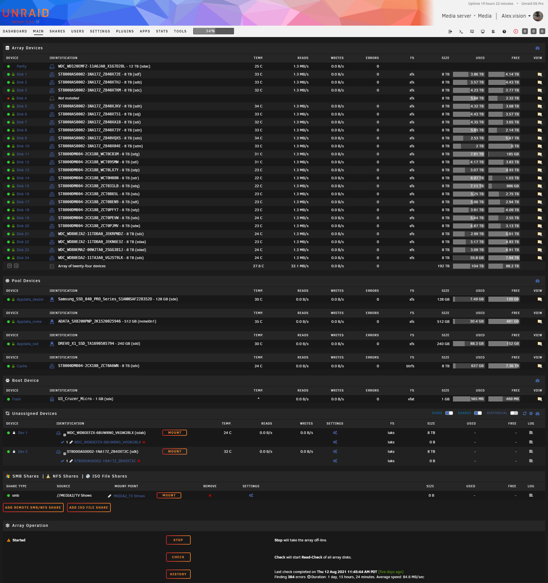

The array finished the rebuild/replace for the Disk 4 failure, but we had a heat wave roll through, so before I could look into everything I shutdown the system so it wouldn't overheat. I also bought a new drive to replace Disk 1 with and it just came in.
I started up the server, getting ready to replace Disk 1, when I saw that the system had tried to use my old Disk 4 ST8000AS0002-1NA17Z_Z840XT2C instead of the new Disk 4 WDC_WD80EFZX-68UW8N0_VKGW28LX.
When I tried to put the correct drive that the array had rebuilt upon, Unraid said it was wrong.  I didn't want to start anything with out finding out what I should do.

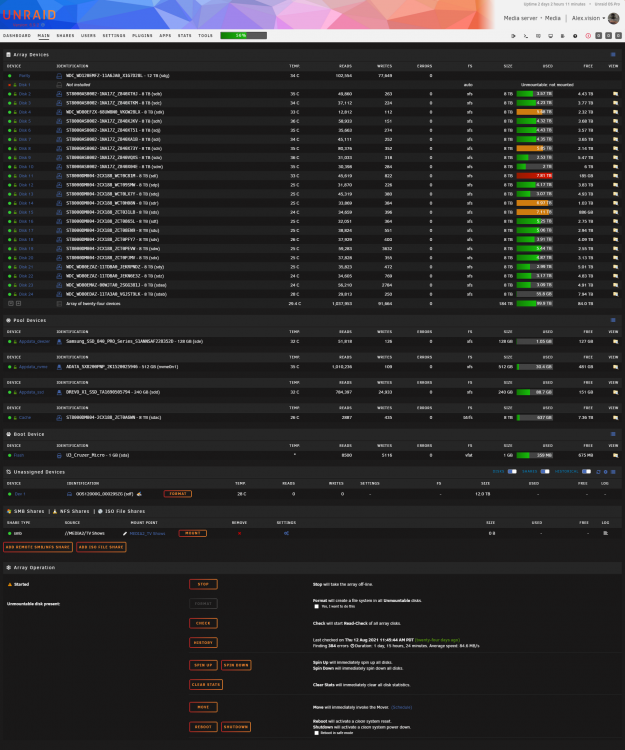

Can you unassign disk4 then start the array? If so, post new diagnostics and a screenshot of Main - Array Devices.
Trurl I understand what your are saying about the parity. That makes sense.
I was able to unassign disk4 and start the array. Attached in the diagnostic file and a screenshot of the array.
media-diagnostics-20210817-0907.zip
105443683_FireShotCapture015-Media_Main-8af99fb17f3a3d4b30bea3897f04507a5a78ddc7.unraid_net.thumb.png.82848ffab8250c015fd5ffe43de1ec18.png
OK, emulated disk4 is mounted, you can take a look at its files just as if it was really there. The emulated contents are what would be rebuilt if you did the rebuild again.
What I really want to see though, is the original and the replacement for disk4 are showing in Unassigned Devices. If you click the Setting (gears) icon for each, you should be able to set them to Read-only and then if they mount, you can also look at the files on each of them.
See if you can decide which of these, emulated, original, replacement, looks most correct.
If the replacement looks good as an Unassigned Device, maybe we can use it as disk4 in a New Config with Parity Valid and then try to rebuild disk1 to a new disk. And, since you will have original disk4 and original disk1, if there are any problems maybe files can be copied from those.
OK, I will mount both drives in unassigned devices and look into their contents and try to see if it looks good..  Are you thinking I should compare the drives with something like Krusader, or should a quick look at the folder structure and layout with Midnight Commander be sufficient? I disabled SMB, Docker and VM's before starting the array as I wanted to minimize anything writing to the array.  If I should use Krusader, I will need to stop the array and re-enable Docker.
