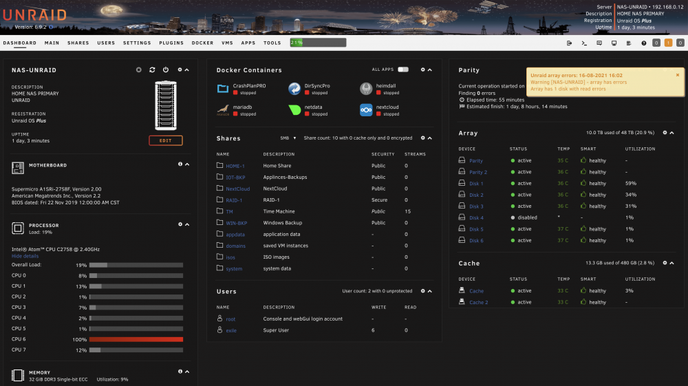

I just manually started my parity check with "Write corrections to parity"  disabled.  As it was running parity check, one of my Disk went in disabled state and I get "Array Disk Have Errors"   See attached screenshot.
In the syslog I get a lot of these:
[83311.219240] md: disk4 write error, sector=307985352
[83311.219244] md: disk4 write error, sector=307985360
[83311.219247] md: disk4 write error, sector=307985368
  • Should I stop the parity check or let it continue?
  • And how do I fix this the right way?  What are the next steps please?

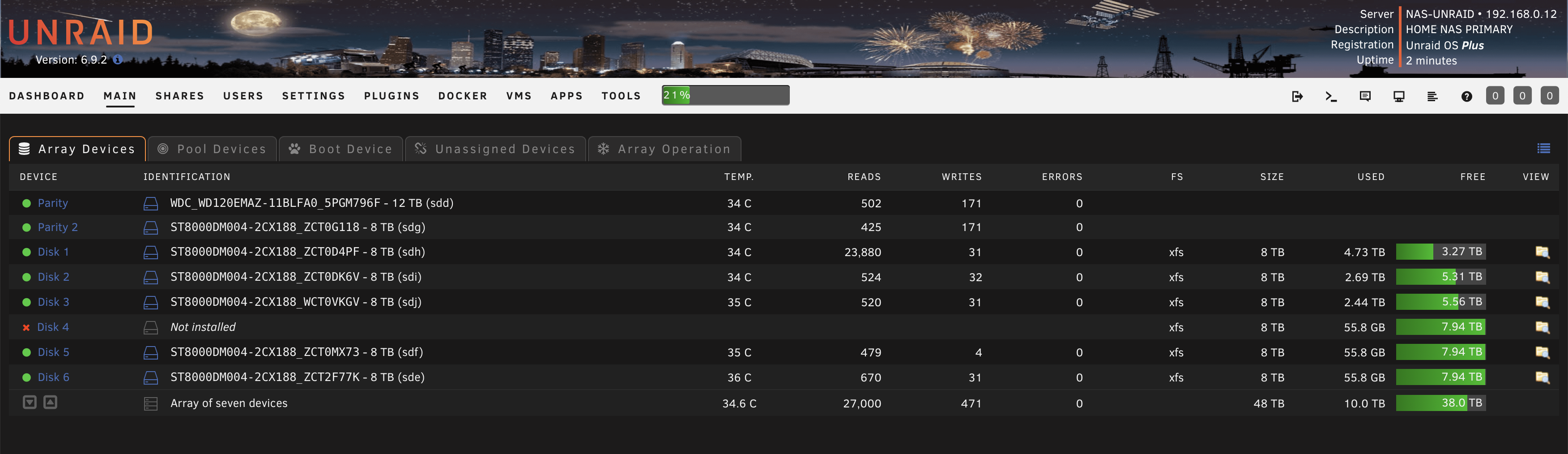

Very strange.  Rebooted and DISK4 is completely gone from the device list and from "array" menu? But I see no errors that the disk is not longer available?
I did check the connections.  Perhaps need to pull the disk out and see if is dead?  There is no light on.

The disk is completely DEAD.  I pulled it out and try it in a different system and it tries to starts, clanking noises and it dies. Is DEAD
So the Array didn't throw any errors?  Is that normal? I didn't have any data on that disk looks like.  This is my first disk failure so still learning

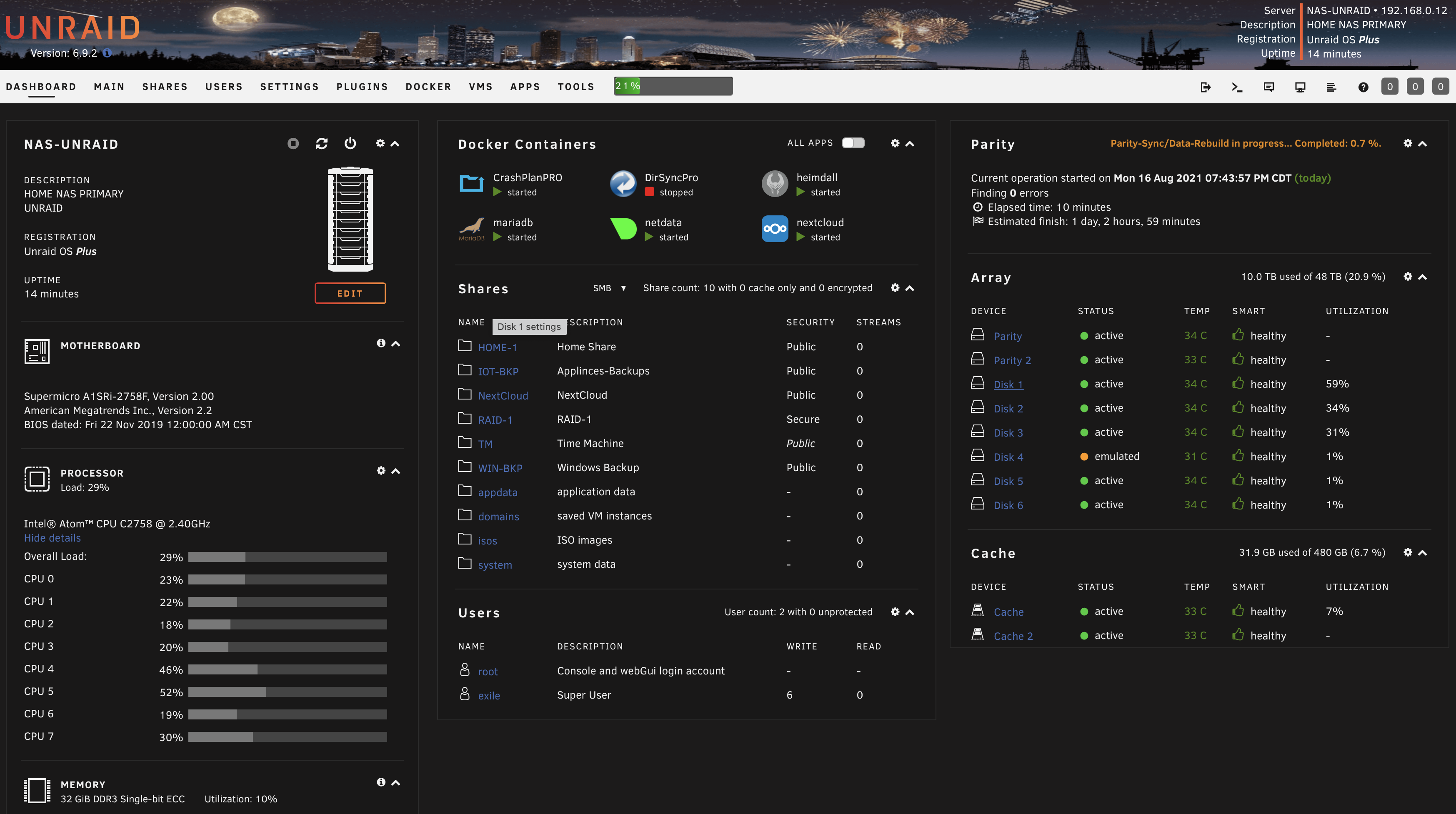

I robbed a disk from my spare / backup uNraid server and my array in this one is rebuilding as we speak.

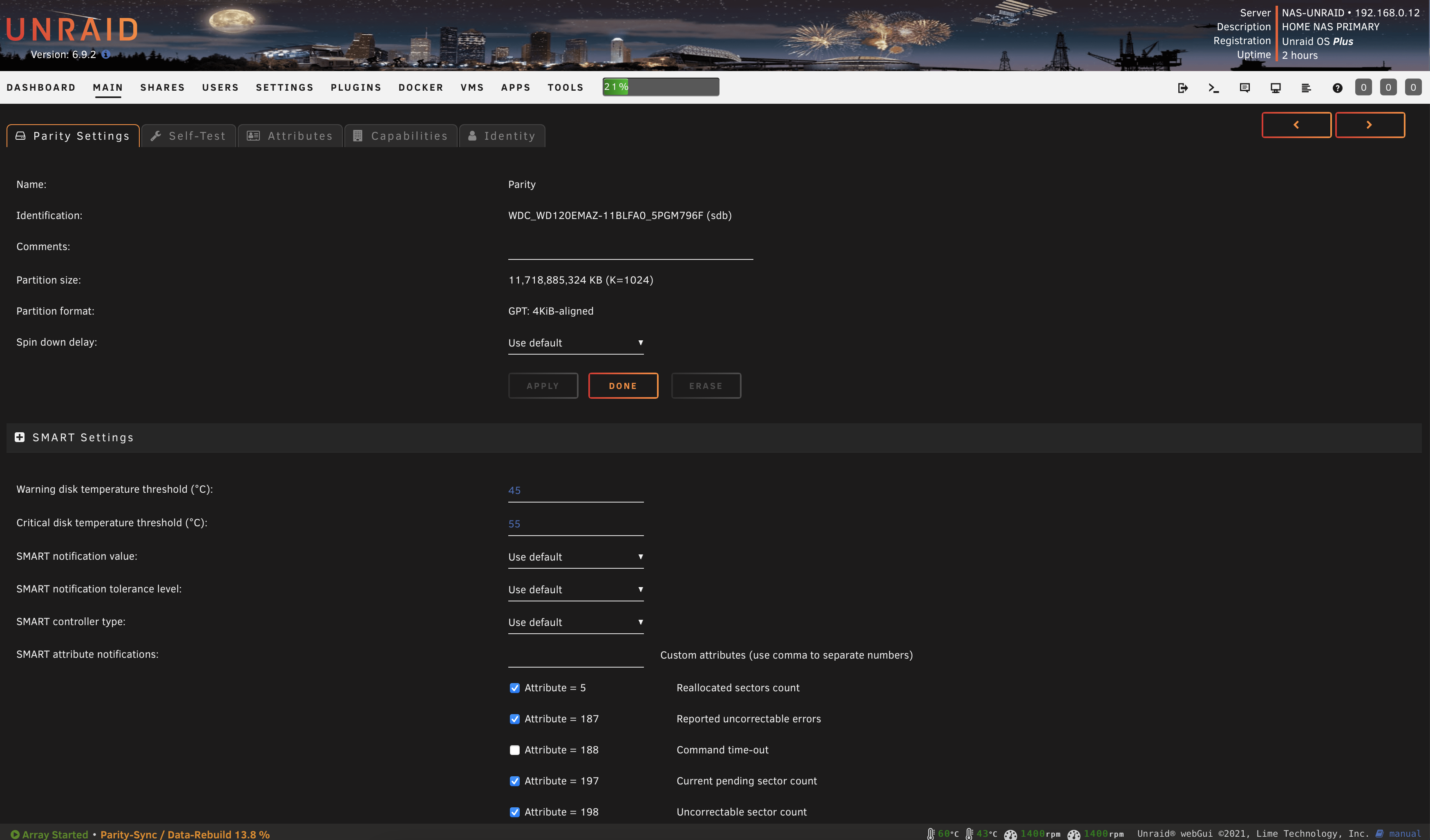

Whatever the default install gives me?  Where do I check the SMART notification settings?  I will check and report back.    Thanks Sir
I looked under Main and I have "Use Default"
Edited by johnwhicker
46 minutes ago, trurl said:
Notifications setup to alert you immediately by email
Settings - Notification Settings
Copy that Sir.  Thanks
