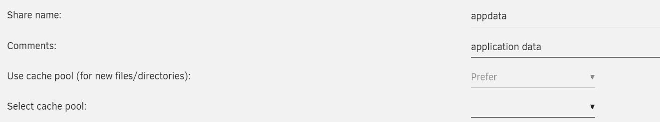

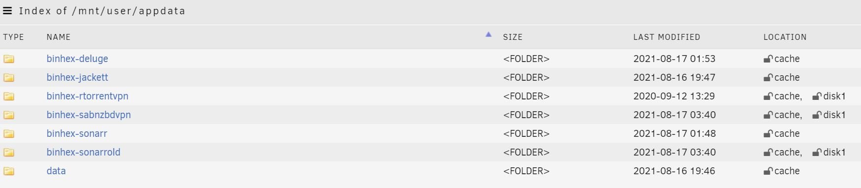

August 17, 20215 yr Running Unraid 6.9.2. My docker apps were acting a little funny, so rebooted the server, and then discovered all my docker apps had lost config. No idea how, I hadn't updated, or changed anything recently. I was looking at the appdata share and noticed settings for cache. (cache pool has nothing to select.) Don't have a cache drive, never have, not even briefly. I'm very confused as to where all my dockers settings went. All my data in binhex-sonarr, gone, same with binhex-sabnzbdvpn, as far as I can tell back to factory. binhex-sabnzbdvpn won't even boot because no ovpn file. I don't know linux, I'm a windows sys admin, so I'm comfortable fiddling with computers but don't know much about linux. Is that cache a linux thing and normal for unraid without a cache drive? Why when I browse the share does a lot of it sit on a cache? Is that a red herring and some other thing caused my settings to go away? Apologise for my linux ignorance and for posting at all, I searched google and the forums and couldn't find anyone else with this exact problem or any clear explanation on those cache settings being normal or not. Any insight would be greatly appreciated, it's going to be a lot of work for me to redo all my settings. Edited August 17, 20215 yr by SquishyDave

August 17, 20215 yr Community Expert Having a user share setting of Use Cache=Prefer is perfectly OK without a cache drive as the system then just reverts to using the array. If you later add a cache pool it can then switch to using it for that share. I suspect that your problem is caused by one or more of your docker containers having a mapping that refers to /mnt/cache (when it should refer to /mnt/user) and this is creating the location /mnt/cache (in RAM) which the system then subsequently treats as though the cache drive WAS present so starts writing to it. This means that the contents of /mnt/cache do not survive a reboot, and also start filling up RAM until the system runs out and stops working correctly. Makes me think that the Docker Manager should have a check that will not let you set up a mapping directly under /mnt that does not refer to a physical drive to stop users being able make configurion mistakes of this sort.
August 17, 20215 yr Author 7 minutes ago, itimpi said: Having a user share setting of Use Cache=Prefer is perfectly OK without a cache drive as the system then just reverts to using the array. If you later add a cache pool it can then switch to using it for that share. I suspect that your problem is caused by one or more of your docker containers having a mapping that refers to /mnt/cache (when it should refer to /mnt/user) and this is creating the location /mnt/cache (in RAM) which the system then subsequently treats as though the cache drive WAS present so starts writing to it. This means that the contents of /mnt/cache do not survive a reboot, and also start filling up RAM until the system runs out and stops working correctly. Makes me think that the Docker Manager should have a check that will not let you set up a mapping directly under /mnt that does not refer to a physical drive to stop users being able make configurion mistakes of this sort. Thank you very much for the reply. Stepping through it myself, I thought something like that might be the case. I'm sure I mapped it wrong way back when I set it up. I understand now, but didn't then. However binhex-sabnzbdvpn only has user mappings, and it lost config. Also why is all of binhex-deluge, jacket and sonarr being listed as located on cache after a reboot? (see first post) All three of deluge, jacket and sonarr have the incorrect cache mapping for data, but the correct user mapping for config, so the config at least should be on the array. And sabnzbvpn has the correct user mapping for both, but some of it's tree is still on the cache somehow.
August 17, 20215 yr Community Expert 47 minutes ago, SquishyDave said: Thank you very much for the reply. Stepping through it myself, I thought something like that might be the case. I'm sure I mapped it wrong way back when I set it up. I understand now, but didn't then. However binhex-sabnzbdvpn only has user mappings, and it lost config. Also why is all of binhex-deluge, jacket and sonarr being listed as located on cache after a reboot? (see first post) All three of deluge, jacket and sonarr have the incorrect cache mapping for data, but the correct user mapping for config, so the config at least should be on the array. And sabnzbvpn has the correct user mapping for both, but some of it's tree is still on the cache somehow. If ANY mapping refers to /mnt/cache then this will get created when the container is started thus causing this to get created in RAM which will have undesirable side-effect of fooling the system into thinking it has a cache drive and san start putting files there (and these do not survive a reboot)
August 17, 20215 yr Author Ah I see, so it moved files to the cache afterwards even though they were created under user. Thank you for your knowledge. You've been a massive help, I've learned a lot, and now I can fix up my mappings and spend the time to recreate everything knowing it won't disappear again. I really appreciate you taking the time to explain to me what happened here. Thank you.
August 17, 20215 yr Community Expert 1 hour ago, SquishyDave said: Ah I see, so it moved files to the cache afterwards even though they were created under user. T Yes /mnt/user is an amalgamated view of all top level folders on all physical drives under /mnt including any pools In this case you have 'fooled' the system into thinking that there is a cache device. You need to be aware of this that as any time you decide to operate in Unraid at the physical drive level y/u will find that files/folders show up at both the drive level and the User Share level - they are simply two views of the same folders/files.

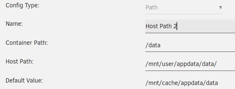

August 17, 20215 yr Author Thanks again. I'll just say that I think at least the binhex dockers by default point to cache for data, maybe other dockers do too, not sure. See the default value below. And it worked fine for literal years before this issue showed up. If anyone is searching for this issue and comes across this thread they'll know why at least. I'm not sure I actively chose to browse to cache, it seems like that's how they came out of the box. I'll go back and double check these dockers and see if I missed a note telling me to make sure to change this path if I don't have a cache drive. I almost certainly did miss such a note, but if not I'll see if I can let the binhex guys know, but I'm guessing I didn't RTFM closely enough. Thanks again for all your help.
