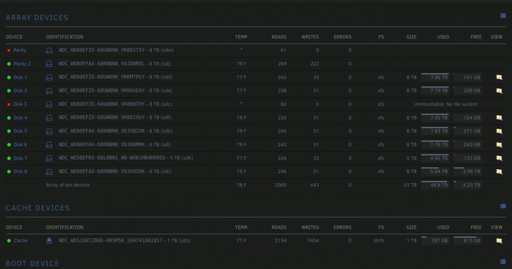

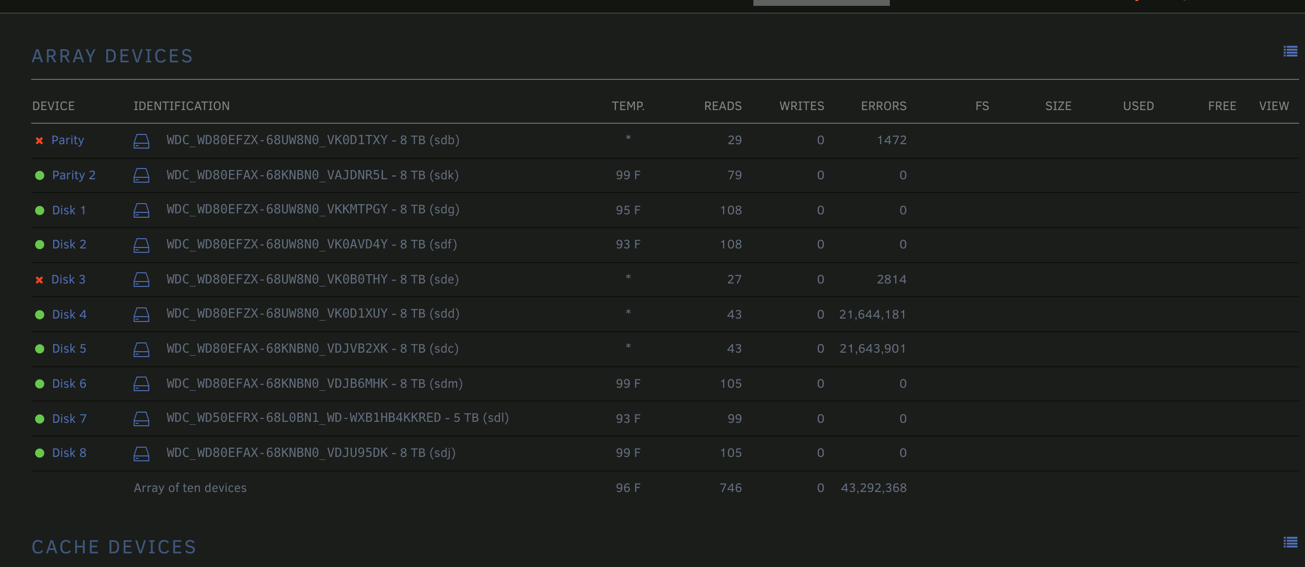

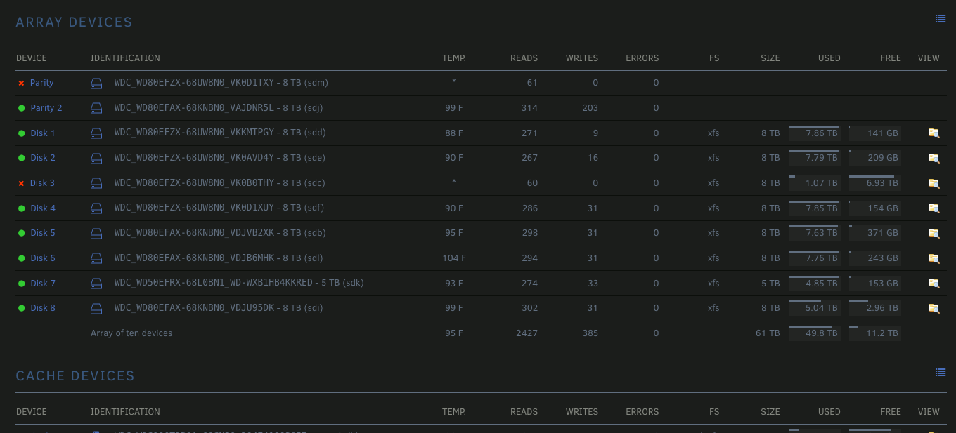

August 17, 20215 yr Diagnostics attached. Got a warning yesterday morning which I forgot about until I tried to use plex. Logged in to find two drives disabled and a lot of errors on other drives. I rebooted, one drive was the missing and the other parity was still disabled. Decided to shutdown to be safe and ordered two new drives. What should I try before just swapping in the new drives? cylon-diagnostics-20210816-2028.zip
August 17, 20215 yr Community Expert Do the diagnostics correspond to the screenshot as the screenshot does not show any drive missing, but the diagnostics suggest it is not online. Since the diagnostics show parity and disks 4 and 5 are also offline I would suspect the disks are fine but that there is a problem with something common to those 4 drives such as SATA or Power cabling. I would suggest powering down; checking all cabling; reboot; start the array; and post new diagnostics. That might give a better clue on how to advise you to continue.
August 17, 20215 yr Community Expert Looks like the common AMD controller issue that happens with some Ryzen boards, best bet is to not use the SATA ports, or use a different board.

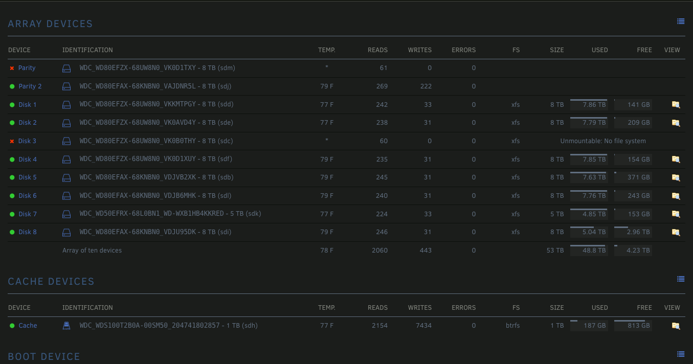

August 17, 20215 yr Community Expert 3 hours ago, itimpi said: Do the diagnostics correspond to the screenshot as the screenshot does not show any drive missing, but the diagnostics suggest it is not online. Is that screenshot perhaps with the array started in Maintenance mode? No disk is showing a filesystem or size, for example.
August 17, 20215 yr Author Shutdown, rechecked everything (even changed some of the cables around to see if other drives would report bad) and I have the same results. It wasn't missing, it was Unmountable, sorry. I rate smart on each (fast) and the both checked okay. They also show fine clicking on the disk info icon for each. Should I just start a rebuild? I'm assuming it's a controller issue and will be researching a new one as both of these were on the motherboard controller. cylon-diagnostics-20210817-1233.zip Edited August 17, 20215 yr by detz

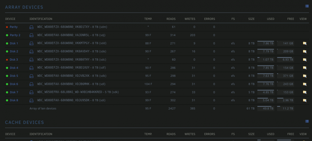

August 17, 20215 yr Author oof, there is a lot (TB) of data in the lost in found and free space is now almost 7 TB where the drive was almost full before. I'm assuming this means it wasn't able to repair? What other options do I have here? 😞 Edited August 17, 20215 yr by detz
August 17, 20215 yr Community Expert 35 minutes ago, detz said: oof, there is a lot (TB) of data in the lost in found and free space is now almost 7 TB where the drive was almost full before. I'm assuming this means it wasn't able to repair? What other options do I have here? 😞 one option is to try and mount the original disk using the UD plugin to see if is in a better state than the emulated one (one reason not to rush into a rebuild over its contents). You may have to use the option in the UD settings to change the UUID on the drive to avoid it clashing with the emulated dtive.
August 17, 20215 yr Author 10 minutes ago, itimpi said: one option is to try and mount the original disk using the UD plugin to see if is in a better state than the emulated one (one reason not to rush into a rebuild over its contents). You may have to use the option in the UD settings to change the UUID on the drive to avoid it clashing with the emulated dtive. If the lost and found is showing everything I can live with it being gone, but I'm confused why I'm losing data if I should be able to withstand a 2 drive failure. What did I do wrong here?
August 17, 20215 yr Community Expert 2 minutes ago, detz said: If the lost and found is showing everything I can live with it being gone, but I'm confused why I'm losing data if I should be able to withstand a 2 drive failure. What did I do wrong here? The problem is that a drive going unmountable means there is file system corruption (basically a write appeared to work, but the data written was wrong for some reason) and parity does not protect against this.

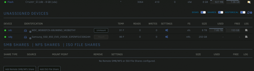

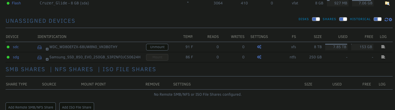

August 17, 20215 yr Author 56 minutes ago, itimpi said: one option is to try and mount the original disk using the UD plugin to see if is in a better state than the emulated one (one reason not to rush into a rebuild over its contents). You may have to use the option in the UD settings to change the UUID on the drive to avoid it clashing with the emulated dtive. I use UD to just mount with the array stopped and I can browse the drive without issues. It's hard to tell if anything is gone though as files are so fragmented on the drives I'm not sure what should be here. Is there a way to put this drive back in operation and see what happens?
August 17, 20215 yr Author So after I did the UD I added it back to the array and it's unmountable again. 😞 Where should I go from here? Disk, controller, try a rebuild?
August 17, 20215 yr Community Expert 1 hour ago, itimpi said: free space is now almost 7 TB 1 hour ago, detz said: If the lost and found is showing everything I can live with it being gone The lost+found would have been created on that same disk which you say has a lot more free space than before so it must not have everything you thought was there. 2 minutes ago, detz said: So after I did the UD I added it back to the array and it's unmountable again. What exactly do you mean by "added it back to the array"? There is more than one way to interpret that and I'm not sure any of them are good ideas.
August 17, 20215 yr Community Expert 3 minutes ago, detz said: So after I did the UD I added it back to the array and it's unmountable again A bit worried that you said this. Simply adding the disk back into the array is likely to have lost its contents as it probably triggered a rebuild - thus destroying its current contents and putting the emulated contents there instead.

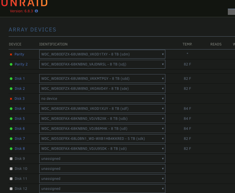

August 17, 20215 yr Author I stopped the array and unassigned it (using the dropdown) I then mounted it in UD and browsed around in ssh (pushed the Mount button as it showed up down there when I unselected it above) I didn't start the array though. I then re-selected it back in the dropdown "added it back" and started the array Its unmountable Edited August 17, 20215 yr by detz
August 17, 20215 yr Community Expert 9 hours ago, detz said: I stopped the array and unassigned it (using the dropdown) I then mounted it in UD and browsed around in ssh (pushed the Mount button as it showed up down there when I unselected it above) I didn't start the array though. I then re-selected it back in the dropdown "added it back" and started the array Its unmountable That was not the right thing to do - and you have probably caused the physical drive (that was OK) to be overwritten with the contents of the emulated drive (which was not). EDIT: actually on reading more carefully if you did not start the array with the disk unassigned you may be OK as that is the point at which Unraid commits drive assignments, and you also did not mention a rebuild starting on he drive. I would try unassigning it again and checking that it can still be mounted by UD. If so keep it unassigned until you get further advice.
August 17, 20215 yr Community Expert 19 minutes ago, detz said: I stopped the array and unassigned it (using the dropdown) I then mounted it in UD and browsed around in ssh (pushed the Mount button as it showed up down there when I unselected it above) I didn't start the array though. I then re-selected it back in the dropdown "added it back" and started the array Its unmountable Can you mount Unassigned Disks without the array started? I've never tried. If the array was never started while the disk was Unassigned then maybe it doesn't start rebuild. Unless you mounted it read-only in UD it will be slightly out-of-sync though. Post a screenshot and new diagnostics.
August 18, 20215 yr Community Expert 8 hours ago, trurl said: Can you mount Unassigned Disks without the array started? Yep.
August 18, 20215 yr Author 9 hours ago, itimpi said: That was not the right thing to do - and you have probably caused the physical drive (that was OK) to be overwritten with the contents of the emulated drive (which was not). EDIT: actually on reading more carefully if you did not start the array with the disk unassigned you may be OK as that is the point at which Unraid commits drive assignments, and you also did not mention a rebuild starting on he drive. I would try unassigning it again and checking that it can still be mounted by UD. If so keep it unassigned until you get further advice. Stopped array again, changed to 'no device' in dropdown (didn't start array) and the drive was mounted in UD correctly. I can browse the drive fine in ssh. I copied some files around and scp'd one locally and it was fine. Again, not sure if everything is there but it appears to be working. 9 hours ago, trurl said: Can you mount Unassigned Disks without the array started? I've never tried. If the array was never started while the disk was Unassigned then maybe it doesn't start rebuild. Unless you mounted it read-only in UD it will be slightly out-of-sync though. Post a screenshot and new diagnostics. I didn't mount it read-only but it doesn't appear to be re-built. cylon-diagnostics-20210818-0321.zip
