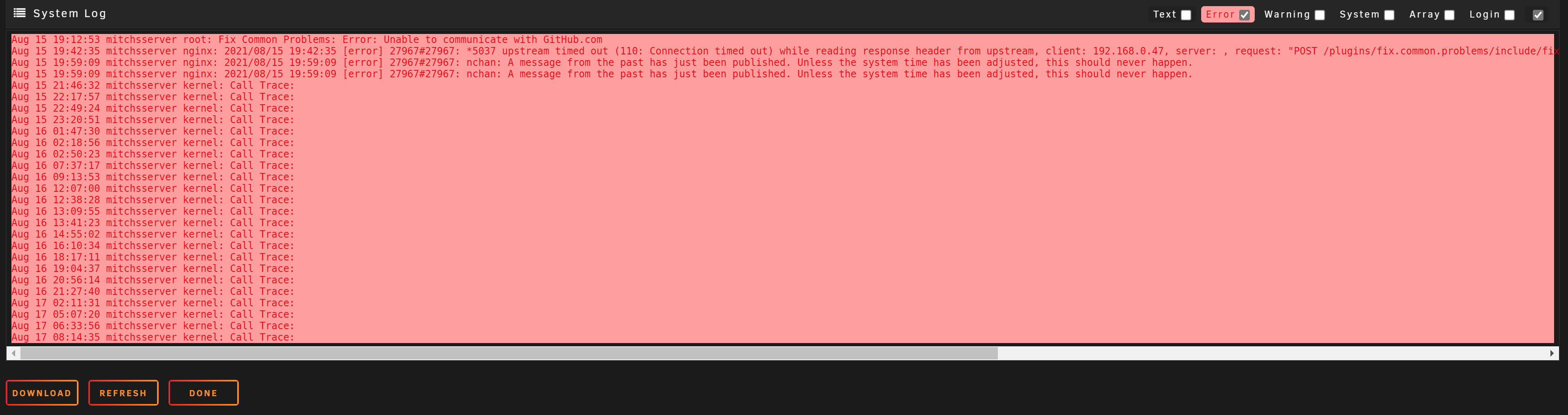

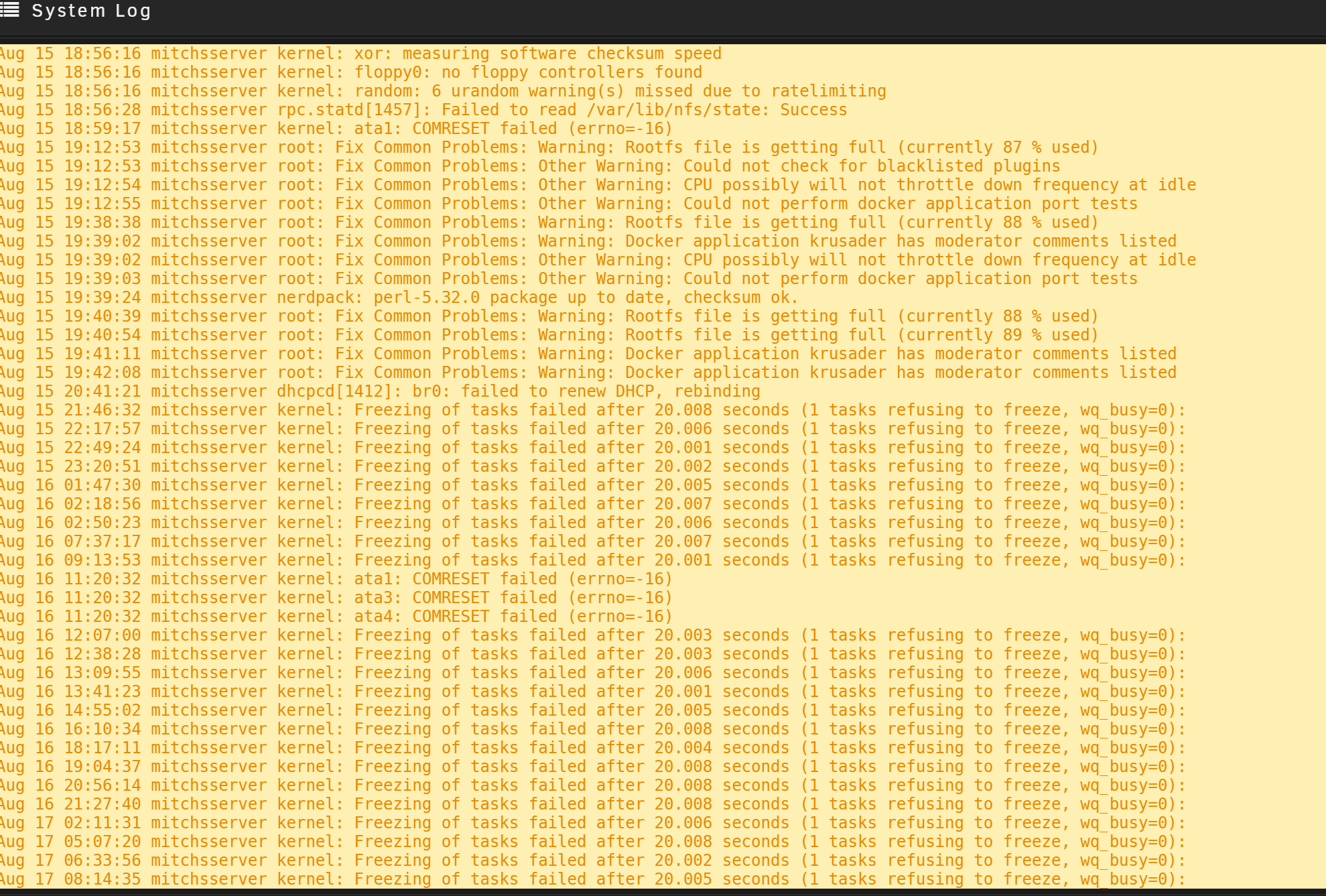

the errors i just mentioned arent they in the system log???   Call Trace Error.. and Freezing of tasks failed warning..  i thought the diagnostics supposed to show you the system log's
but here is a pic
its been 3 days no one replied in the Fix Common  Issues plugin.. when i asked why did Fix Common issues pluggin freeze and i posted diagnostics..  but
now i posting the System Logs   i wanna know if its soemthing else
All those errors appear to come from the plugin, please use the existing support thread or remove it.
3 minutes ago, JorgeB said:
All those errors
Except these:
ug 16 11:20:32 mitchsserver kernel: ata1: link is slow to respond, please be patient (ready=0)
Aug 16 11:20:32 mitchsserver kernel: ata4: link is slow to respond, please be patient (ready=0)
Aug 16 11:20:32 mitchsserver kernel: ata3: link is slow to respond, please be patient (ready=0)
Aug 16 11:20:32 mitchsserver kernel: ata2: link is slow to respond, please be patient (ready=0)
Aug 16 11:20:32 mitchsserver kernel: ata2: SATA link up 3.0 Gbps (SStatus 123 SControl 300)
Aug 16 11:20:32 mitchsserver kernel: ata2.00: configured for UDMA/133
Aug 16 11:20:32 mitchsserver kernel: ata1: COMRESET failed (errno=-16)
Aug 16 11:20:32 mitchsserver kernel: ata3: COMRESET failed (errno=-16)
Aug 16 11:20:32 mitchsserver kernel: ata4: COMRESET failed (errno=-16)
Aug 16 11:20:32 mitchsserver kernel: ata1: SATA link up 3.0 Gbps (SStatus 123 SControl 300)
Aug 16 11:20:32 mitchsserver kernel: ata4: SATA link up 3.0 Gbps (SStatus 123 SControl 300)
Aug 16 11:20:32 mitchsserver kernel: ata3: SATA link up 3.0 Gbps (SStatus 123 SControl 300)
Aug 16 11:20:32 mitchsserver kernel: ata1.00: configured for UDMA/133
Aug 16 11:20:32 mitchsserver kernel: ata4.00: configured for UDMA/133
Aug 16 11:20:32 mitchsserver kernel: ata3.00: configured for UDMA/133
This are hardware, usually power or controller related.
