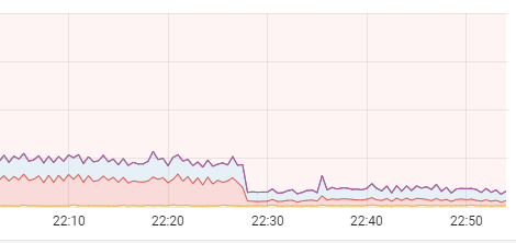

August 18, 20215 yr I notice my unraid server continuously have about 50% CPU load (not sure if it's common) and "unraid-api" is always the top one. Any guidance on what this for and how I can lower the CPU load. See attached screenshot.
August 19, 20214 yr That's our API that's installed when you install the my servers plugin. I'd expect it to be using a lot less CPU usage though. Could you confirm you're on the latest version of the plugin and can I get a copy of your diagnostics.zip ?
August 19, 20214 yr Author Thanks for replying. The plugin seems to be up-to-date and attached diagnostics.zip.
August 19, 20214 yr Thank you. In a terminal on that server can you run "unraid-api restart" and just see if that makes any difference.
August 19, 20214 yr This isn't related to your issue, but I'd recommend going to Settings -> Scheduler -> Mover Settings and disabling "Mover logging". That is only meant to be on if you are troubleshooting issues with mover.
August 19, 20214 yr Author 49 minutes ago, ljm42 said: This isn't related to your issue, but I'd recommend going to Settings -> Scheduler -> Mover Settings and disabling "Mover logging". That is only meant to be on if you are troubleshooting issues with mover. Interesting. I just checked my settings and "Mover logging" is already disabled. 1 hour ago, OmgImAlexis said: Thank you. In a terminal on that server can you run "unraid-api restart" and just see if that makes any difference. Restarting seems to work for now. I need keep monitoring to see if it goes up again. Thank you! Edited August 19, 20214 yr by icodesign

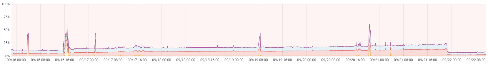

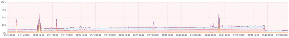

September 22, 20214 yr Just had a look into Grafana. It looks like that is a slow process and some process is just need more resource over the time. You can see the increase here: Edited September 22, 20214 yr by der.max
September 22, 20214 yr Author 9 minutes ago, der.max said: Just had a look into Grafana. It looks like that is a slow process and some process is just need more resource over the time. You can see the increase here: Guess we should add a cron job to restart the process? LOL...
September 22, 20214 yr Just now, icodesign said: Guess we should add a cron job to restart the process? LOL... That was also my idea. But this is just a workaround
