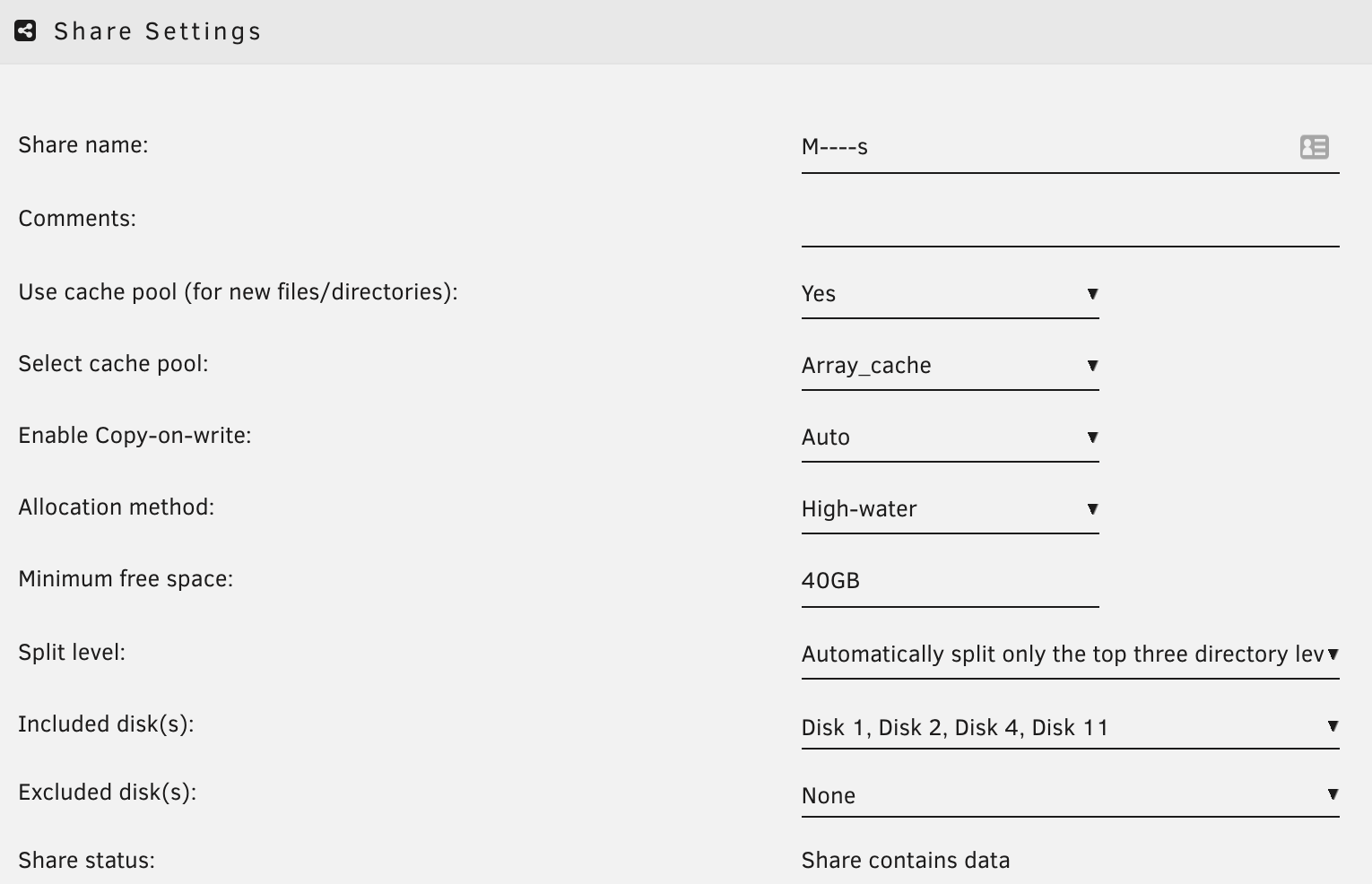

It doesn't look like your M----s share specifies which pool to use.

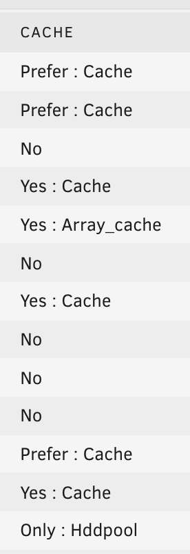

So, it's set to use the original cache pool from pre-6.9, however I renamed it once I created the other pools. Could the rename of the cache pool have screwed it up, even though the GUI says it's correct?
Try changing it then change it back and apply to see if that fixes it. You might take a look at your other shares that use that pool also since it looks like several of your shares don't have a pool specified in .cfg
Yup, that's exactly what happened. Inside the share settings, it shows what I want, but in the share overview, it shows the old share name (You can see where the new share (Share A) I created shows "Array_cache". I toggle it to another cache pool and back, and now I'm writing to the cache correctly (well, for some reason it's moving the files in and back out through the VM instead of just moving it within the NAS. Previously, I was able to move at around 200MB/s while putting no strain on the VM NIC (something like NFS Offload). I'm assuming that's just how I have the shares mapped in the VM?)
