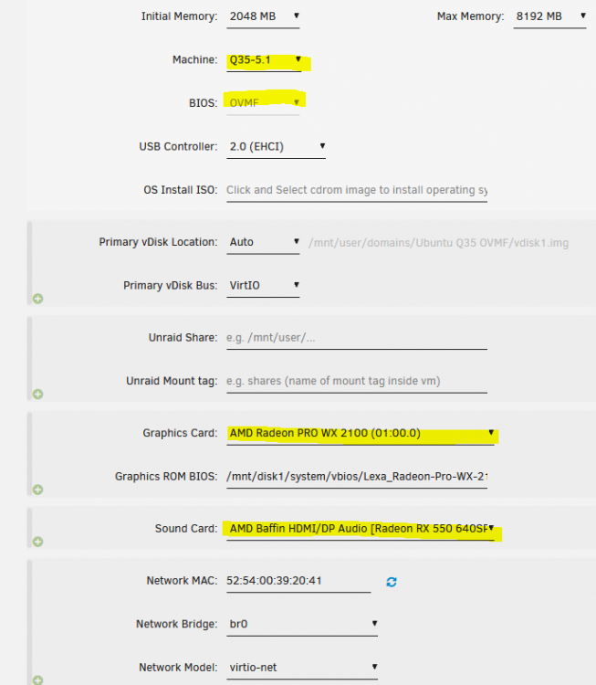

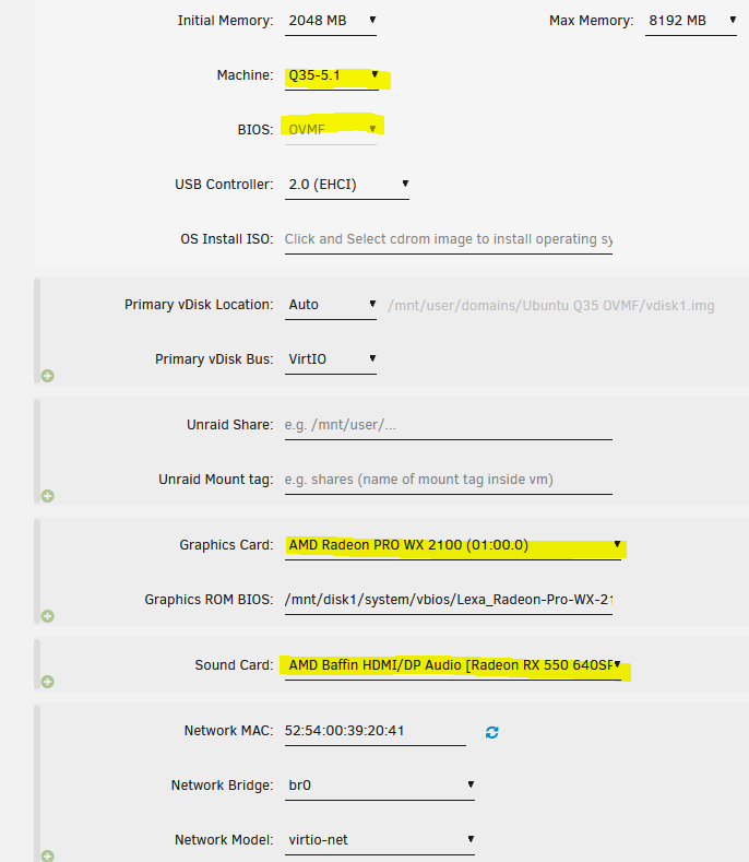

GPU passthrough not working when sound card is added
I was able to boot a Ubuntu VM (OVMF Q35 5.1) with only the video device passed through (no sound counterpart) and the system worked for 2 subsequent boots with 3D acceleration (but no sound). I then added the sound device pass-through and it stopped booting. I made the Space Invader special XML tweak that seems to be a long-standing bug that isn't fixed yet. The system looks like it boots and I can even see the teamviewer alias pop into the list but it is inaccessible and the GPU has no output. I can get it back to booting by removing the sound device and restarting unraid (tested once - I maybe had to boot with VNC vga once first too before reassigning the passthrough GPU).
  • I am booting unraid in UEFI (tried legacy boot also)
  • System has an APU (Ryzen 5 2400G) as primary GPU & passthrough GPU in first PCIe slot
  • IOMMU forced enabled in bios (GPU reserved in unraid for vfio)
  • I have tried with or without the specified ROM vbios file (pulled manually from a bare metal windows boot and the techpowerup utility)

All of IOMMU group 8:
Edited by Econaut
Unraid log for VM startup:

Is there any other information I can provide to help figure out why it's not working?
  • Unsealed0019 changed the title to GPU passthrough not working when sound card is added
Is it possible I am missing some of the components to the GPU that may be in another IOMMU group? I cannot tell myself:

Seems like it should be just group 8 but why would it work when I don't have the sound card and not work when I add the sound card unless it's not the right mix... maybe?
AMD-based GPUs are notorious for having more problems with GPU passthrough.  When issues like these occur, you can try doing some online research for your specific GPU to see if there are any additional quirks you can apply, but generally speaking it is far easier to just replace your AMD GPU with an NVIDIA one and use that instead as it tends to have far better success with pass through.
All the best,
Jon
Oh wow your kidding! Everything I read seemed to indicate that AMD GPUs were the easier option because they weren't locked down leading to error 43 and others.
I am trying to use a rather rare and probably unpopular card to be sure but I figured since it was enterprise/professional grade it may have better chances. https://www.amd.com/en/products/professional-graphics/radeon-pro-wx-2100
Is there anymore diagnostics that I could provide that may help determine why/what is failing? Like I mentioned, it actually works with pass-through until I add the sound component which seems to be strange and the opposite of what all the other information suggests.
