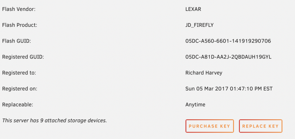

Had the same idea, took an old back up and recreated it using the newest version, copied over the /config folder from the original (maybe bad) USB and darn if it didn't boot right up.  Via the GUI it looks like my pro key did not work but that could be because I was a couple of versions back before.  It also looks like my shares did not make it over either.  Any thoughts on how to get it back to normal...?
OK yes the pro-key and the USB GUID are wrong so I need a new key how do I get that..?
Try making a full backup of the files on the key that's currently working and put them back on the original key that the license actually links to.
You're are a smart man my friend, not sure why I didn't think of that.  Did exactly as you suggested and it looks like I'm 100% back and my pro key is valid again, array started and all looks normal again.  Wonder what happened, I think I'm going to request a pro-key for my backup USB stick just in case something is bad in the original.  If it fails again the back up USB will just work.
