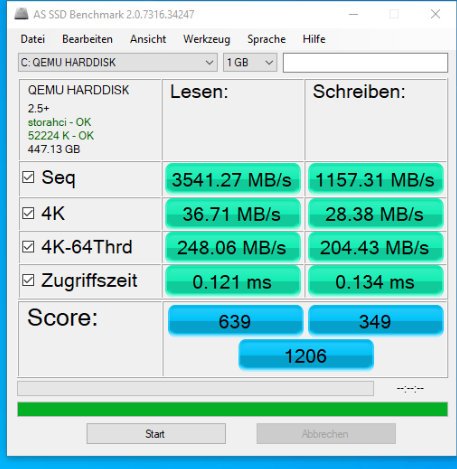

UEFI - Sata Vbus
Seabios - Sata Vbus

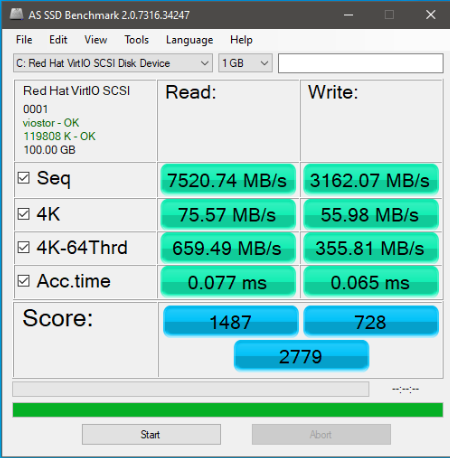

Fresh Install -OVMF Virtio

> Then i created a new VM with OVMF , i440 and the same disk i used , but this time with VirtIO bus. everything like u would regularly do. booted the VM and it "just" worked.
Checked the performance (attached) and i was right , VirtIO drivers are much better for NVME disks performance (twice better from my testing)
So its all working now , and thanks for tremendous help!

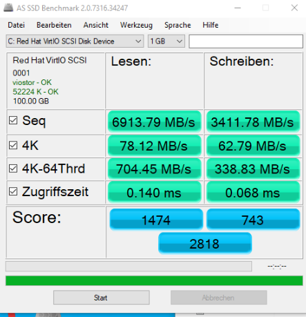

On 8/20/2021 at 2:56 PM, ghost82 said:
1. Open cmd as admin and type:
bcdedit /set {current} safeboot minimal
4. Reset the bcedit settings to not boot again in safe mode, but in normal mode:
bcdedit /deletevalue {current} safeboot
Thanks, this fixed my Windows 11 VM performance passing an ADATA SX8200PNP 1TB NVMe:
