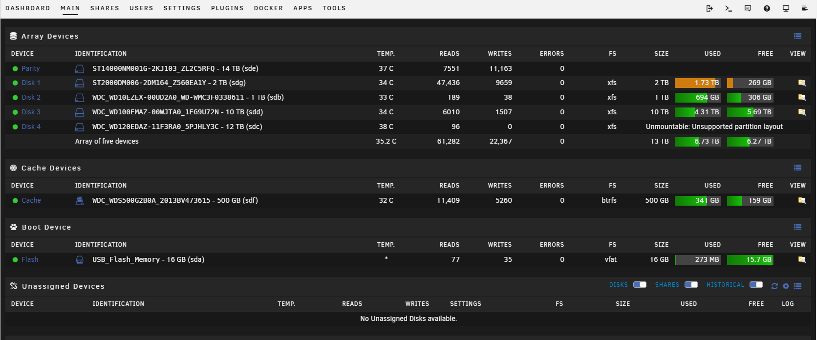

I upgraded from 6.8.3 to 6.9.2 and noticed my disk4 is giving the message, "Unmountable: Unsupported partition layout". I haven't made any hardware changes recently. I've tried the following to no avail:

Anyone know how to fix this, or is the best option going to be to try to format & rebuild from parity? I've attached diagnostics.

Update, I ran gdisk on this as a hunch and here's the results.
root@Tower:~# gdisk /dev/sdc
GPT fdisk (gdisk) version 1.0.4
Caution: invalid main GPT header, but valid backup; regenerating main header
from backup!
Warning: Invalid CRC on main header data; loaded backup partition table.
Warning! One or more CRCs don't match. You should repair the disk!
Main header: ERROR
Backup header: OK
Main partition table: OK
Backup partition table: OK
Partition table scan:
  MBR: protective
  BSD: not present
  APM: not present
  GPT: damaged
Caution: Found protective or hybrid MBR and corrupt GPT. Using GPT, but disk
verification and recovery are STRONGLY recommended.
Command (? for help):   q
Is it a good idea to proceed to write the table to the disk? I'm not super familiar with gdisk, but saw this as a fix for someone with the same issue here:
Yes, that might fix it, and if it doesn't there's the rebuild option.
Won't writing the partitions using gdisk screw up screw up parity?
Edit, is this the process to follow?
1. Stop array
2. Run gdisk
3. Assign drive back
4. Start array
5. Maybe everything is fine?
6. If not, how do I get Unraid to be able to mount the disk?
Edited by mehappy
No, partiton info is outside parity.
What do you mean? You never unassign the drive, just run gdisk with the array stopped, reboot and start array normally.
