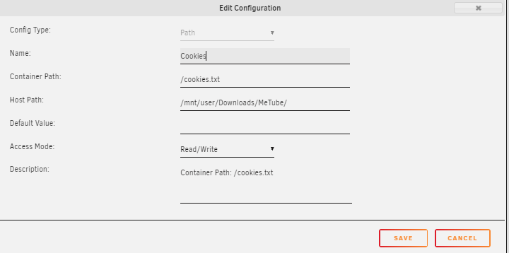

Requesting assistance from anyone familiar with how to set up environment variables for Metube.  Here's what I am trying to accomplish.  I need to "mount" a cookies.txt file so Metube knows how to properly pull the cookies file when retrieving video.  I have a cookies.txt file generated I just need to set an environment variable to recognize it.  Below are instructions from the Dev but I am lost on a couple points.
But the idea is that just as you mount your /downloads folder as a docker volume, you need to mount the cookies file into the container in the same way (as a volume). Let's say you mount it in the root directory as /cookies.txt in the container. Then you can instruct the yt-dlp copy that MeTube runs to use this cookie file. That you will have to do via the YTDL_OPTIONS environment variable. You'll have to set it to {"cookiefile":"/cookies.txt"}. If you're doing it directly via YAML, make sure you properly escape this string.
I am not sure how to set up the environment variable to recognize the cookies file since Metube doesn't have an appdata folder, etc.  Any assistance would be helpful.
Based on the above, I mounted the path as follows (note the cookies.txt file is in the "/downloads/Metube/ directory:
And here is what I have for Env. Variable...What am I doing wrong??
Edited by Hawkins12
Hi guys! MeTube author here. Glad you like the software!
I'll be happy to assist where I can. I've never used Unraid so I know nothing about it, so I'll only be able to help with things that have to do with MeTube itself.
@Alex.b, I'm not sure how you're setting the user/group ID in the template (where can I see the template?), but if I'm understanding it right, and it's via PUID/PGID environment variables, then those don't have any effect in this docker image. The uid/gid are set via the docker daemon, as documented in the README. How this is configured in Unraid I don't know... But there's got to be a way!
@Hawkins12, as I said I know nothing about Unraid but still these don't look right... In the mount section, I think you want to use /mnt/user/Downloads/MeTube/cookies.txt as the host path. And in the environment variable section, you'll probably want YTDL_OPTIONS as the key, and the JSON string {"cookiefile":"/cookies.txt"} as the value.

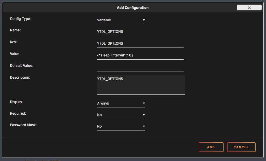

How would a person add the enviroment variable for --write-subs and --embed-subs, cant get it to work.. I have tried as a variable and under the extra parameters with the -e added.
TIA
It also says YTDL_OPTIONS is invalid
YTDL_OPTIONS is indeed how you would do it, if you post here your YTDL_OPTIONS, we can try to see if there's anything wrong with it.
This wasn't working, however when I change "Required" to yes it seems to work.
I looked at the doc for all other options, I tried:
{"writesubtitles"} as the value but I still get the "YTDL_OPTIONS is invalid" in the log (only thing it displays and then stops the container)
I also tried without quotes and braces with no success. Thanks.
I also didn't see an embed subs option either.
I seemed to figure it out...
{"writesubtitles":"SUBTITLES"}
this worked like a charm. Just no Embed option that I can see.
