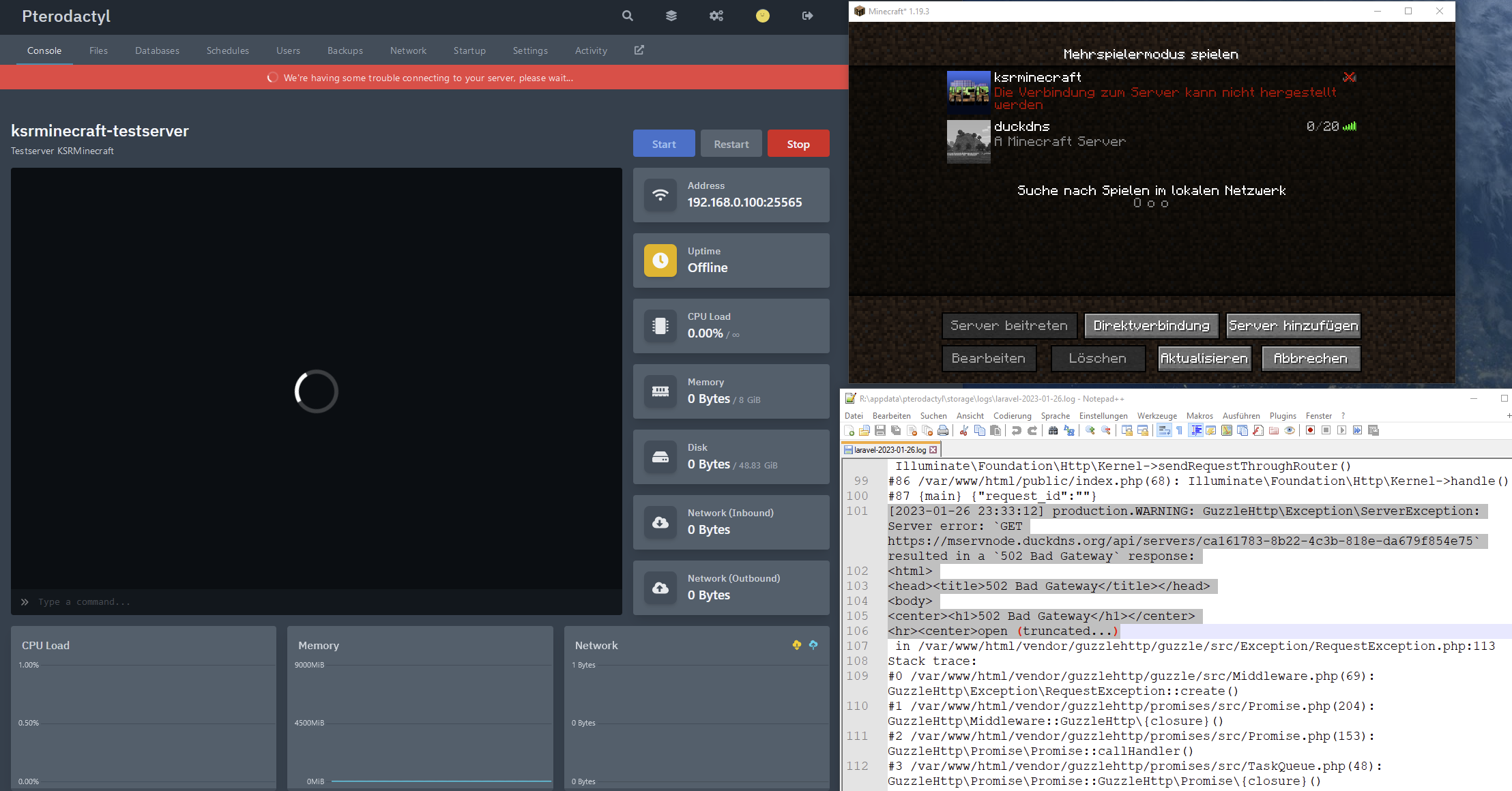

On 1/28/2023 at 9:08 AM, helomen said:
Hello everyone,
I need your help! I have successfully run pterodactyl exactly according to the great instructions of IBRACORP until almost the end. Unfortunately I have problems with the console in the game server (panel). I can access and play Minecraft on this server, but all the time I get the error message "We're having some trouble connecting to your server, please wait...". I also get a 502 error message in the log for the node. Does anyone have an idea how I can solve this problem? I am using the "NginxProxyManager". Thank you already for your help.
Dev-Tools ind FF shows this: Firefox cannot connect to the server at wss://xxxxxxnode.duckdns.org/api/servers/xxxxxxxx-8594-488d-86fb-c935583da9e7/ws.
I still have some understanding issues with forwarding ports. Currently I have the following setting:
Router:
TCP&UDP: 80 -> 1880 (for Nginx Proxy Manager).
TCP&UDP: 443 -> 18443 (for Nginx Proxy Manager)
Nginx Proxy Manager:
XXXXXX_node.duckdns.org -> 8002 (host port in wings to container port 8080)
XXXXXX_panel.duckdns.org -> 8001 (Port in panel to container port 80)
panel:
172.19.0.3:80/TCP <-> 192.168.0.100:8001
wings:
172.19.0.2:2022/TCP <-> 192.168.0.100:2022
172.19.0.2:8080/TCP <-> 192.168.0.100:8002 Is that correct?
XXXXXX_node.duckdns.org/ shows this message in the browser: {"error":"The required authorization heads were not present in the request."} -> So, wings seems to be reachable from the browser
I have already invested several hours without success and don't know what to do. Therefore I am glad about any help. Thank you very much!
How did you solve this?

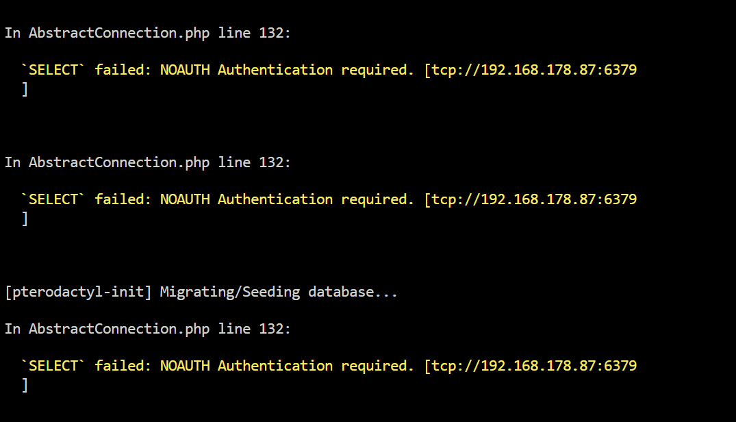

@Sycotix
how would i add a password for redis in this template?
my redis is set up with a password so i need to add it to the template:
On 4/16/2024 at 10:56 AM, derjp said:
@Sycotix
I was wondering about this too, i tried setting REDIS_PASSWORD as a variable with the correct password but i get stuck on login on the panel. Not sure if it's related or not, but when i hit login nothing happens. no logs it just get stuck loading.
