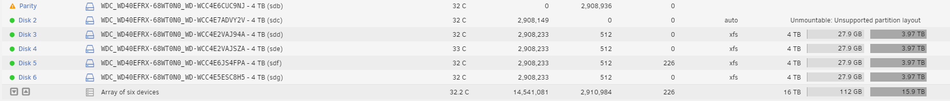

First Disk In Raid Appears as Unmountable
No Matter what I do, Disk 1 will not show (or the first disk listed) will not Mount.
Hardware Troubleshooting
I have replaced the Disk.  I have replaced the Sata Cable.  I have switched SATA ports on the Motherboard.  THese all returned the same result.
Software Troubleshooting.
I then tried making the unmountable disk the parity disk, and it then still lists the first disk in the array as Unmountable.  Doesn't matter what disk is in that slot, it lists as unmountable.
I then also tried skipping the first disk, and then it just shows disk 2 as unmountable.
I am new to Unraid.
Thanks for any help.

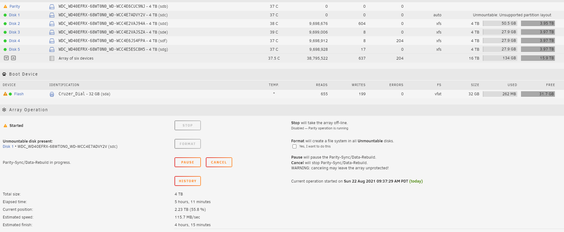

The server is doing a parity sync, I guess cause the drives were not zero'ed out before I used them.  I am going to wait till that finishes to continue troubleshooting unless you guys have any further idea's.
Current status...

Also, I suppose I should already be replacing the drive that has the read errors.
Disk4
Serial Number:    WD-WCC4E6JS4FPA
ID# ATTRIBUTE_NAME          FLAGS    VALUE WORST THRESH FAIL RAW_VALUE
  1 Raw_Read_Error_Rate     POSR-K   200   200   051    -    286
197 Current_Pending_Sector  -O--CK   200   200   000    -    6
You should configure WD disks to monitor attribute 1 and 200.
I would replace that disk.
Since you say no data needs to be recovered, you can fix the Unmountable by checking the Format box and clicking the button.

I apologize.  I thought I was being very specific with my original post, but I left out the most important part.  Every time I click Format, it runs the format for a few moments, maybe 30sec, and then goes back to telling me it is unmounted.  Doesn't matter what Drive i put into the disk 1 slot, the OS tells me it is unmountable and running format will not change that status.  All six drives have been slotted into the disk 1 slot with the same result.  I even Verified that it is not a hardware issue by changing the SATA cables and SATA ports (altho I have not ruled out hardware 100%, maybe a driver or device compatibility issue?).  The only time I have been able to get disk 1 (which ever physical disk it happens to be) mounted is when I configure the array with 2 parity drives.
I have used the "New Config" tool several times to make these changes, and even changed the version of Unraid to the latest stable version.
Nothing I have searched of online describes this issue perfectly, but I have read that Rebooting the server and then formatting can help, or starting the array in Maintenance mode would do the trick.  These still failed to work.
I format
It looks like this
Then back to this.

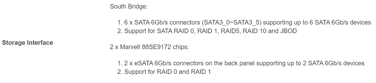

03:00.0 SATA controller [0106]: Marvell Technology Group Ltd. 88SE9172 SATA 6Gb/s Controller [1b4b:9172] (rev 12)
Marvell controllers are not recommended.

What model? Most motherboards have native chipset controllers for most of the ports, but may use marvell controllers for additional ports.
Marvell controllers don't seem to work well with many recent versions of linux, so if you can utilize the native controllers and leave the marvell ports disconnected things may work much better.

GA-990FXA-UD3 by Gigabyte.
https://www.gigabyte.com/Motherboard/GA-990FXA-UD3-rev-10#ov
There are 6 SATA ports stacked 2 high below the Heat sink.  All 6 are being used in my current configuration.  I would have to make the assumption that all 6 won't work, as I have cycled through using all 6 drives in the Drive 1 slot, and they all failed.
Looking at their support site, the BIOS version is about 10 years old.  I will look into updating that.  Also, Marvel seems to be a Built in hardware RAID.  I will also look into disabling that as I have read that UnRaid sometimes doesn't play nice with those, and it is unneeded.

Looks like the Marvell controller is only used for e-SATA.
You should be OK on that front. :)
