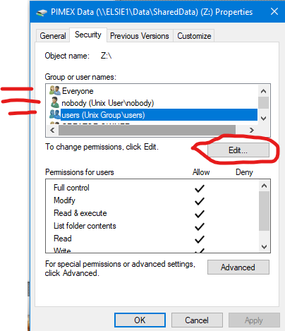

@Jules0815, on your Windows PC, right click on the mapped drive and select Properties.  Now select the Security Tab.  Give us screenshots for the 'Group or user names' of   Everyone    nobody     and   users     showing us the permissions for these three groups/users.

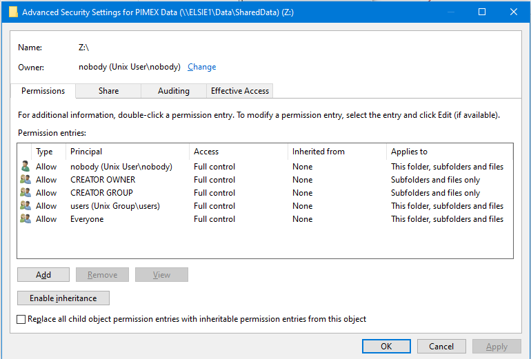

Twenty years ago I had a year of College German in preparation for a visit to Germany to visit my Wife's relatives.  I can assure you that your English will be better than my German!    🙂    However, I am attaching what my settings are
I am not sure why you ended up with your settings.  One thing to remember is that you want to set the security for share on your Unraid server on the server side of the equation and not on the Windows side.   (Adding security on the Windows PC for a mapped drive is not a topic that I am really that familiar with.  But I suspect that it can have some unintended consequences on the Unraid server.)
What I have set for permissions on my mapped drive are as follows.  The three Group or users marked have the permissions set (by clicking the circled 'Edit' button) to allow the full access to the share.  What the user is actually allowed to do is controlled by the permissions granted to (SMB) users on the Unraid Server!
