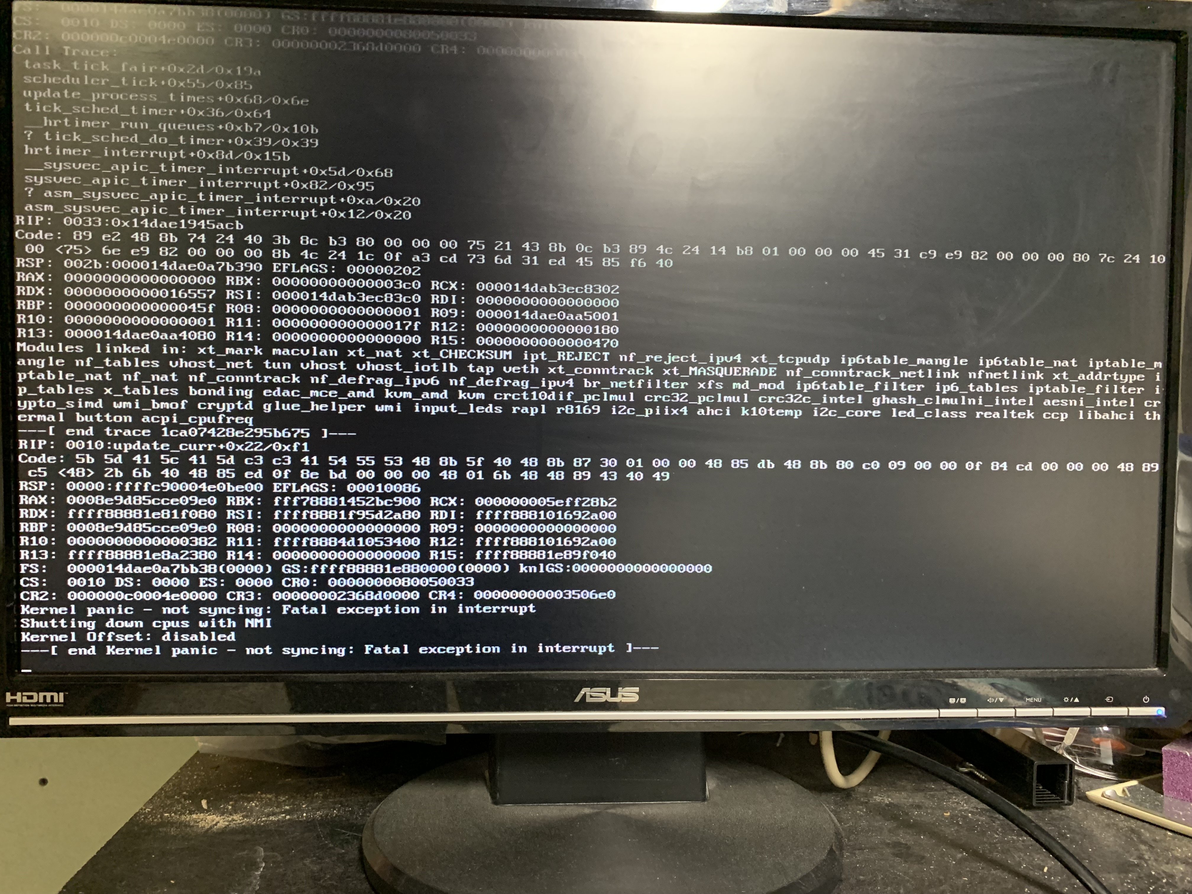

A few days ago my Unraid server stopped being accessible. When I went to check on it, the system crashed with a kernel panic. (see attached image) The system had been running for over two months so I assumed it just needed a reboot which it did fine. However, I did set up a schedule to have the system reboot once a week in the early AM to try and stop future kernel panics. Unfortunately it didn't help and the system got stuck trying to either shutdown or start up (I can't tell which). So I had to power down and back up and that got it working. I've attached the syslog to see if someone who can decipher this stuff better can assist in what happened. The kernel panic error seems to have occurred around Aug 20 21:04:30 while the hang up for the reboot happened around Aug 24 03:00:00. Any thoughts on what's going on is appreciated.

Only call traces I see are about the Realtek NIC:
Aug 24 10:52:40 Unraid kernel: NETDEV WATCHDOG: eth0 (r8169): transmit queue 0 timed out
It does appear to recover after a few seconds, but if issues persist try another NIC if available, Intel preferred.
