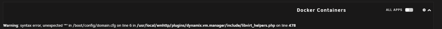

Warning Syntax Error, Unexpected in libvirt_helpers.php on line 478
I have been having an issue with my Unraid receiving this error on my Dashboard. Originally thought it was a bad flash drive but after changing to a new one the error has returned. I have attached my diagnostics for review. Thank you in advanced for any assistance.

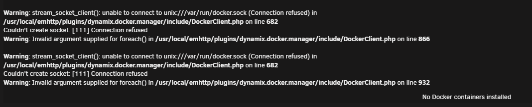

Bueller. Bueller. Bueller. Really need help. Now my entire docker and Unraid. That error persisted with no changes until now everything is broken and Unraid claims it is unreadable.
Really could use help. I have not been able to use Unraid without any errors since purchase and its making question why I didn't just use windows.
As it says in that red warning, you have a flash problem. Probably nothing wrong with the original flash drive or this one, you have some other problem causing it to disconnect.

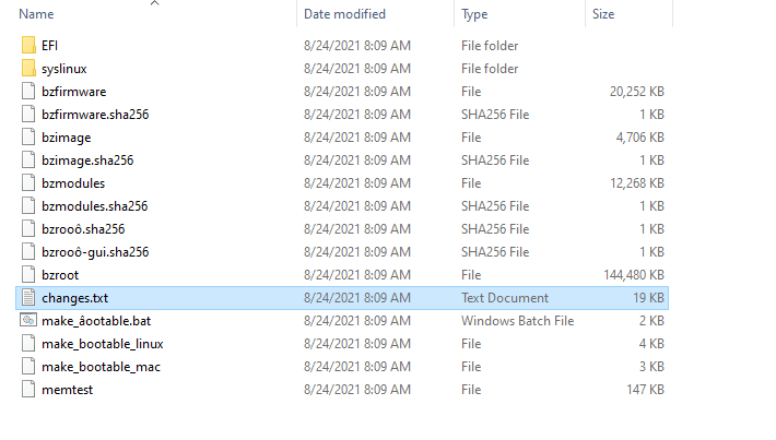

The flash drive is plugged into a USB 2.0 port. Here is the contents of the flash drive. Seems a little lacking:

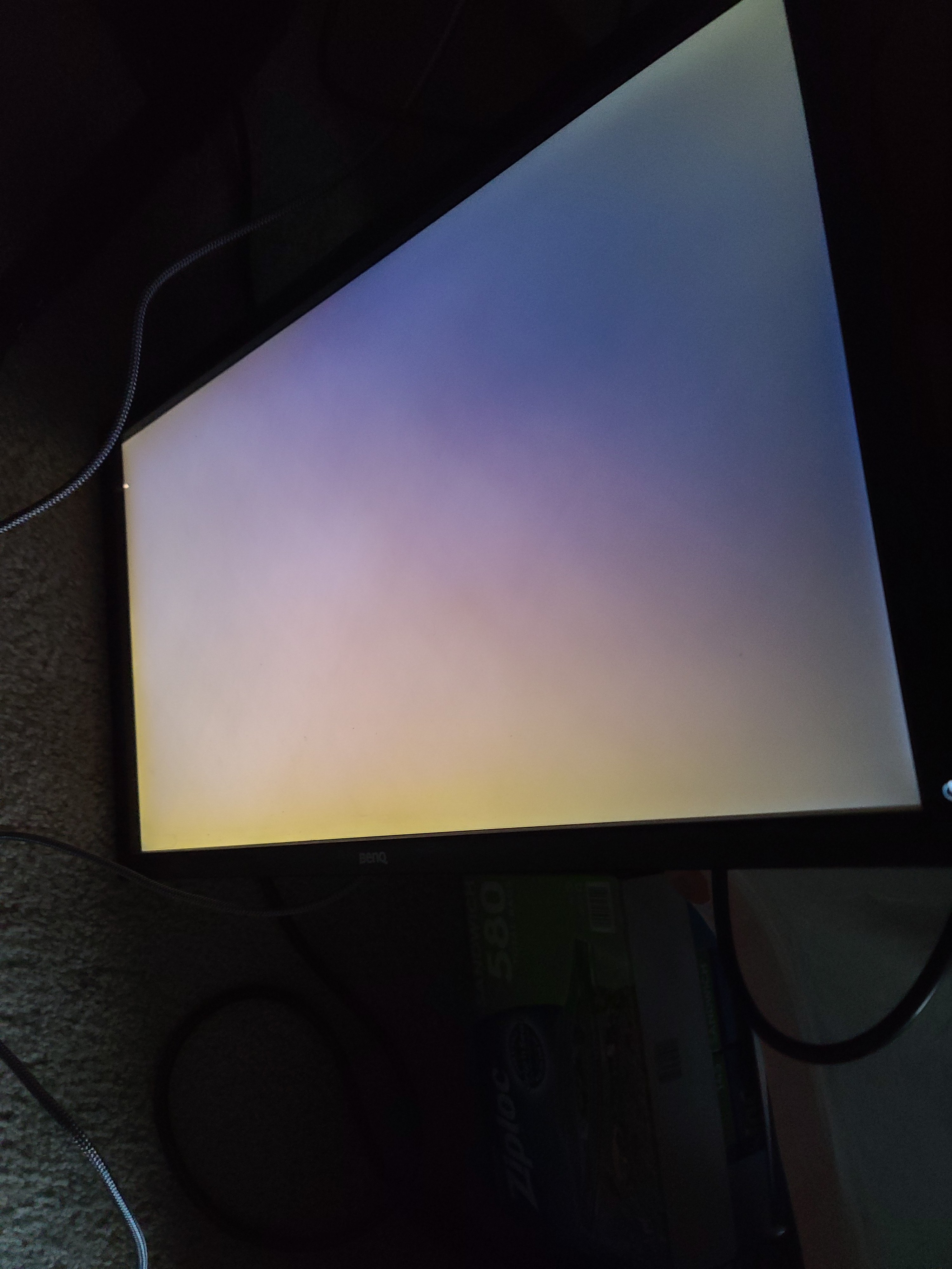

After plugging it in to a new USB2 slot I do not get past a blank post screen.
I do not mind remaking my dockers at all if this problem does not persist. I tried using the Unraid tool to make a new flash drive and place my pro.key in the Config folder. However, I get the same post screen as my previous flash drive.

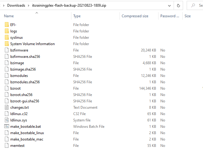

No I failed to grab a backup of the flash. Completely my fault, however last time I was having this same issue I grabbed a flash backup and it had the same missing contents of the config folder. Here is my previous backup that also failed. Every time I have pulled my flash drive and looked in it there was no config folder unless I had just run the Unraid creation tool on it.
How did you "grab" it?
You can download a backup of flash from Main - Boot Device - Flash - Flash Backup.
Yes that Is how I downloaded the backup shown above. If you see picture above I cannot get my Unraid server to post at all now. I tried using the following settings and putting my pro.key file inside the config folder:

Do you mean you can't even get to your BIOS?
Wow you are correct. I am not getting a BIOS screen. Any suggestions, I have never had this before. Faulty motherboard?? This is freaking me out because all the parts are only a month old and I believe just past the return date.
Edited by ItsRaining
