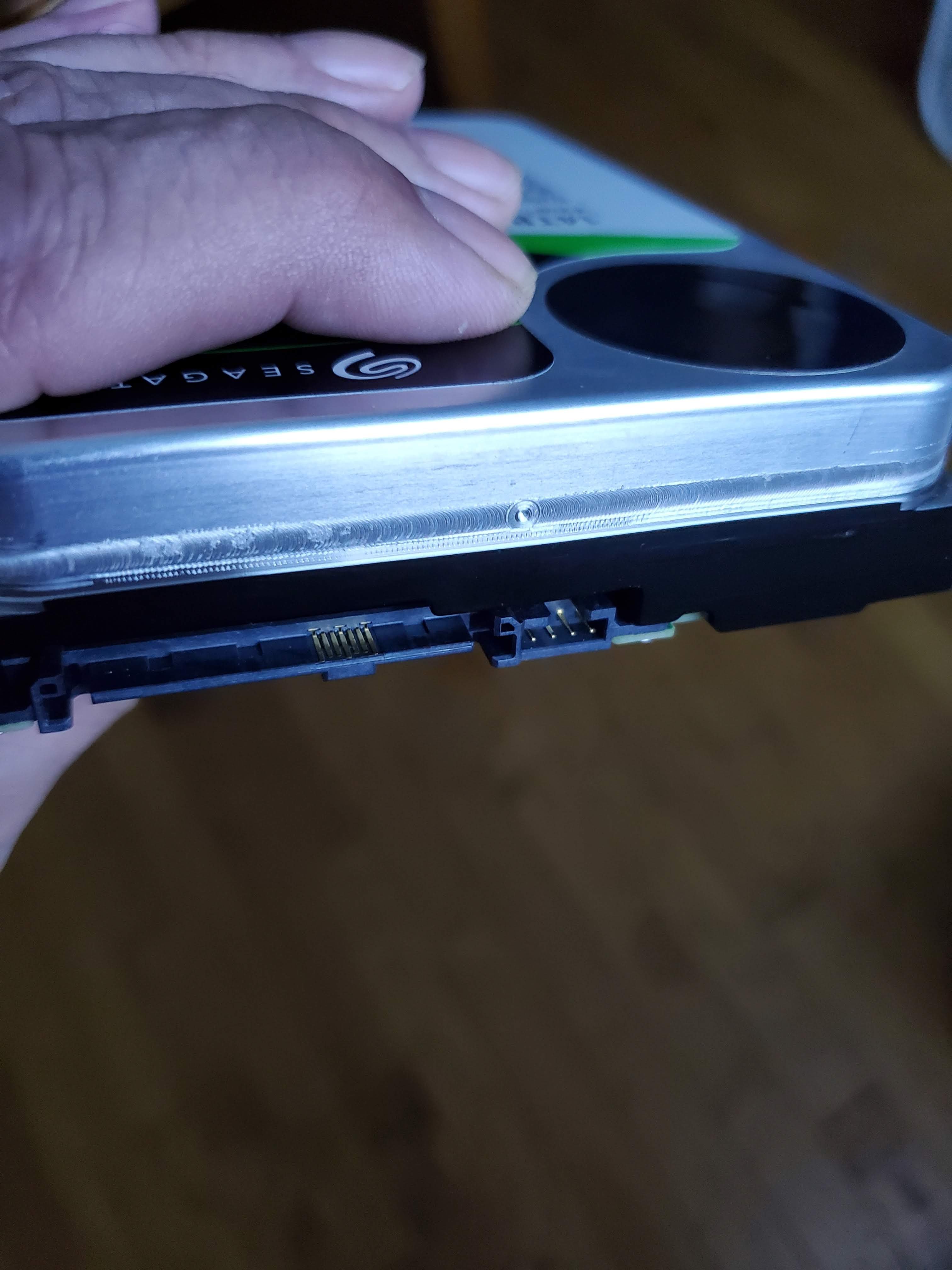

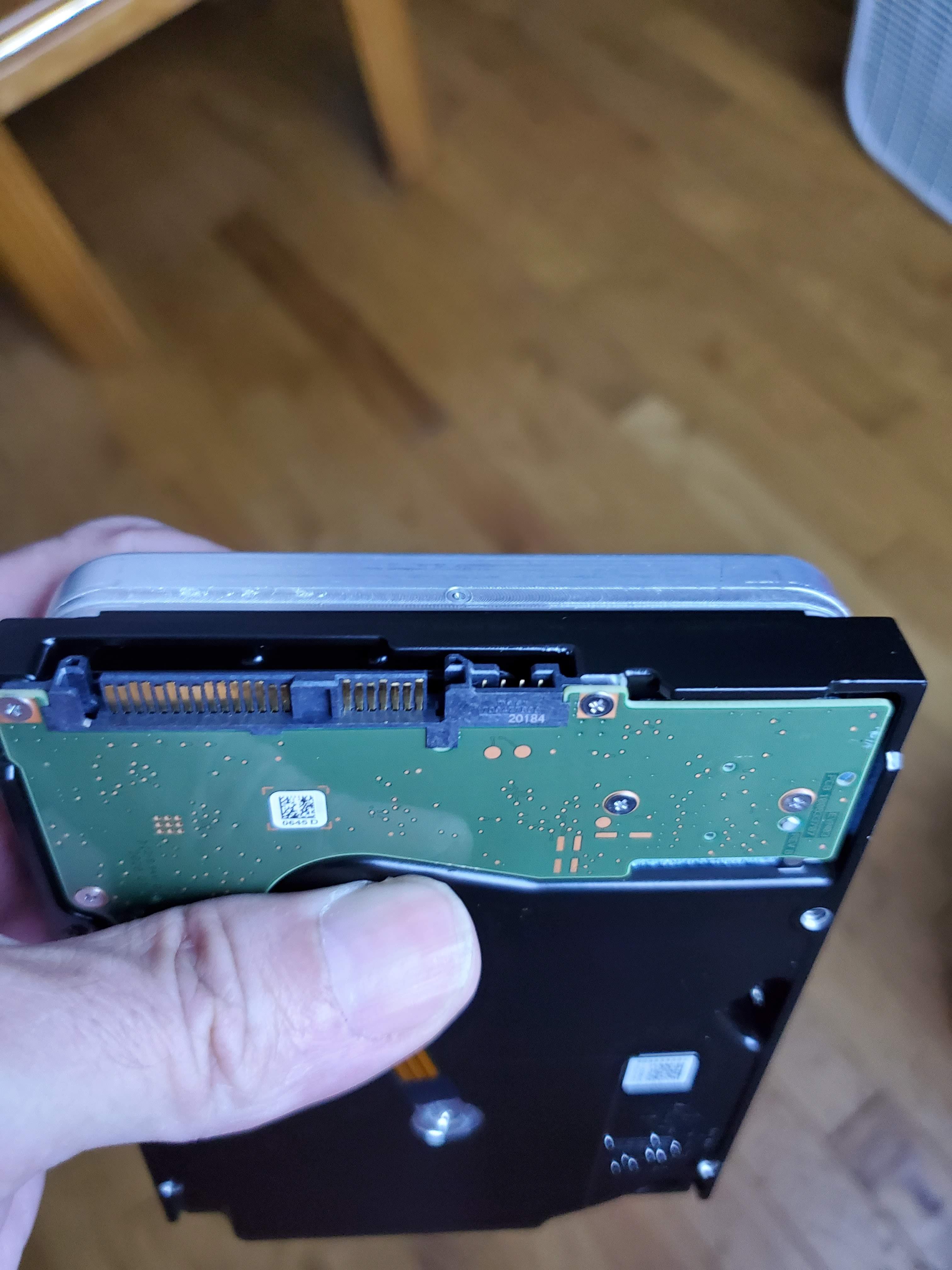

Thought it might be helpful to include some pics of the drive connector.
You need an SFF-8643 to SAS (SFF-8482) cable, doesn't matter if the power adapter is molex or SATA.
Thank you!!
1 hour ago, RichJacot said:
Others say something about having to block pin 3 and they claim it works fine.
Forgot to mention, if the power adapter is SATA you might need to do this, but this will depend on the disk, if it has the power disable feature.
