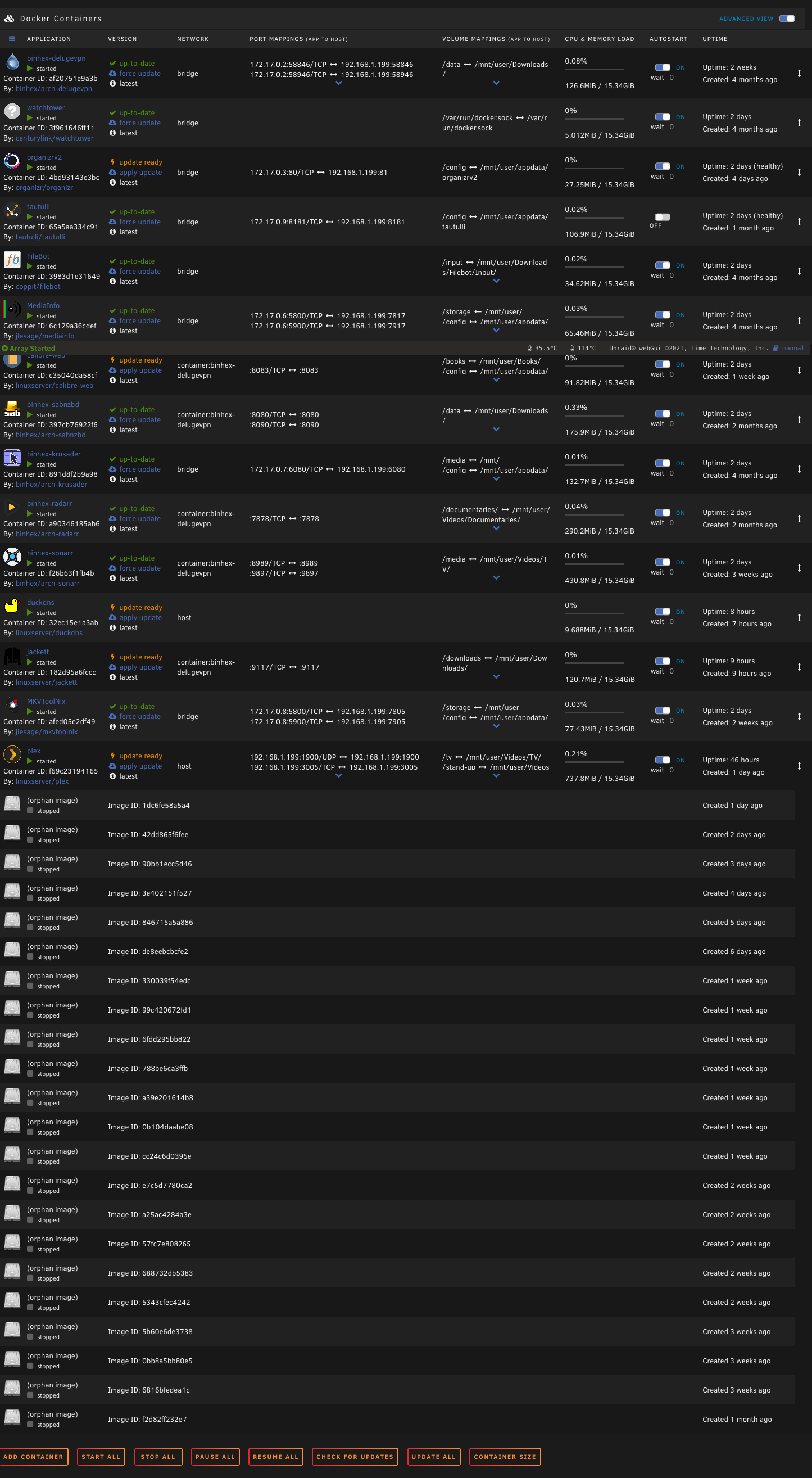

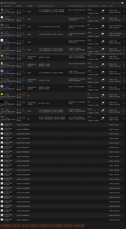

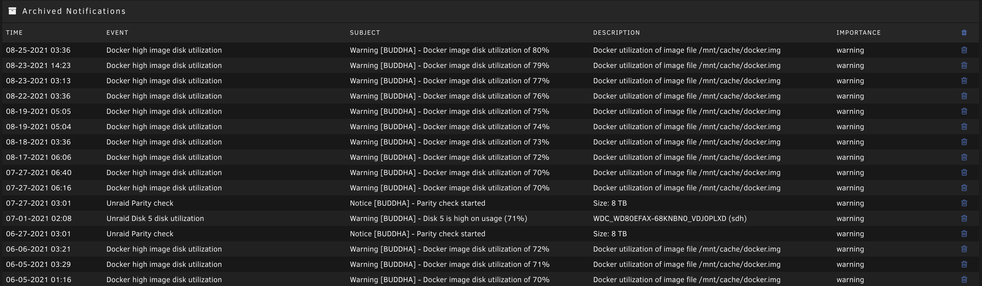

Whenever an update for one of my docker images becomes available, my unraid installtion ends up with orphan images which in turn creates high image disk utilization.
The only solution I've found is to log in every few days and delete the orphan images manually.
Attached are my diagnostics, as well as a notification list and my docker page. i  deleted those orphan images and applied the updates after collecting the diagnostics that are attached. Is it possible this is a bug?
