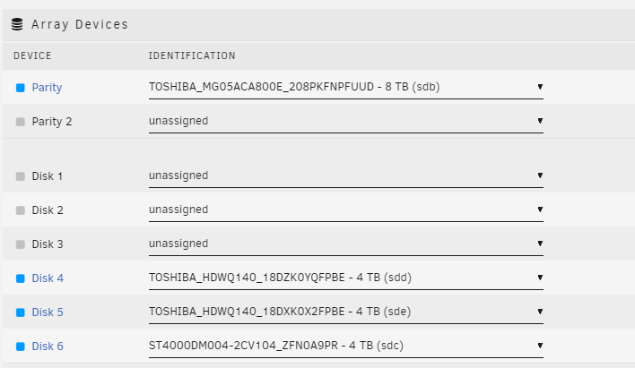

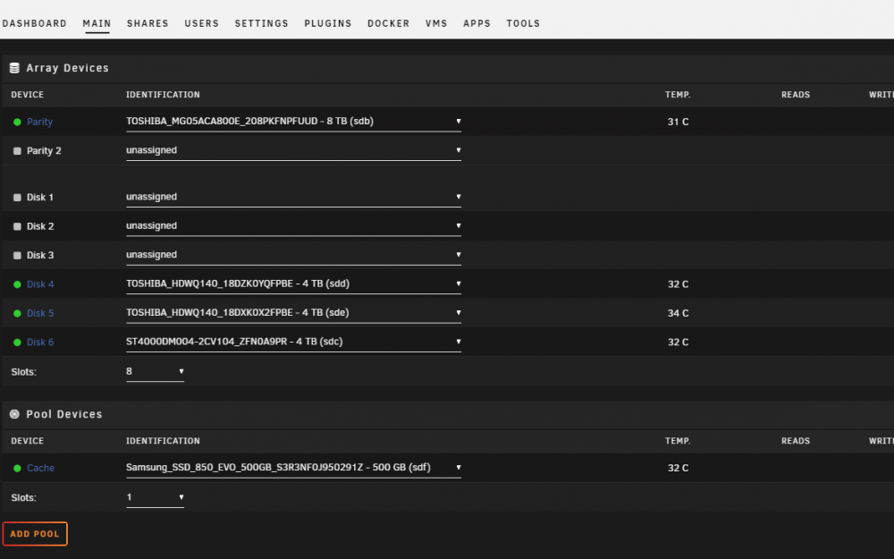

Thankfully i snagged photos of my setup a few days ago in case of FUBAR and i just wanna confirm with you guys here before i do something that will cause me to lose data.
If i put all disks back into the right slots then all should be fine and dandy, no data loss... right?
Yes, also, and if parity is valid, you can check "parity is already valid" before array start.
Aight, thank you! Been chewing my nails off panicking over dataloss... old family photos and such on there, can -not- afford to lose em.
You should have backups of anything important, many ways to lose data.
Everything is there, thank you!
