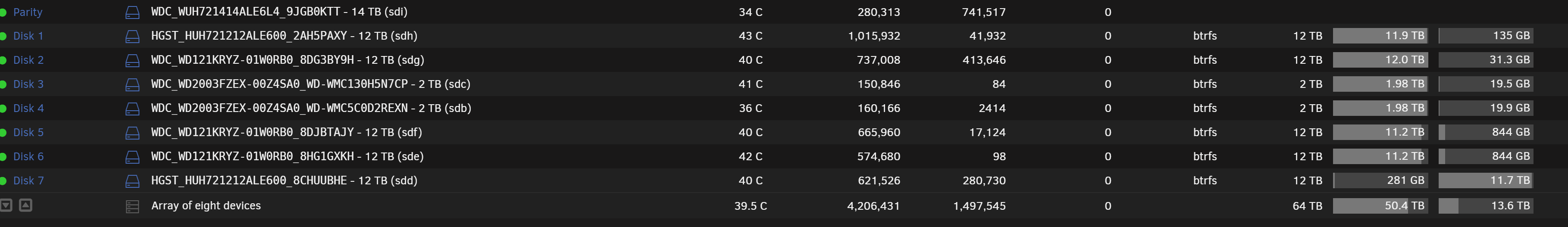

so right now  my free space
on disk 1  12gb   disk 2 25gb disk 3  19.5  disk4 19.5  disk 5 851gb    and the rest are higher
so how come  disk 1 3 4   not go back up over min 20gb

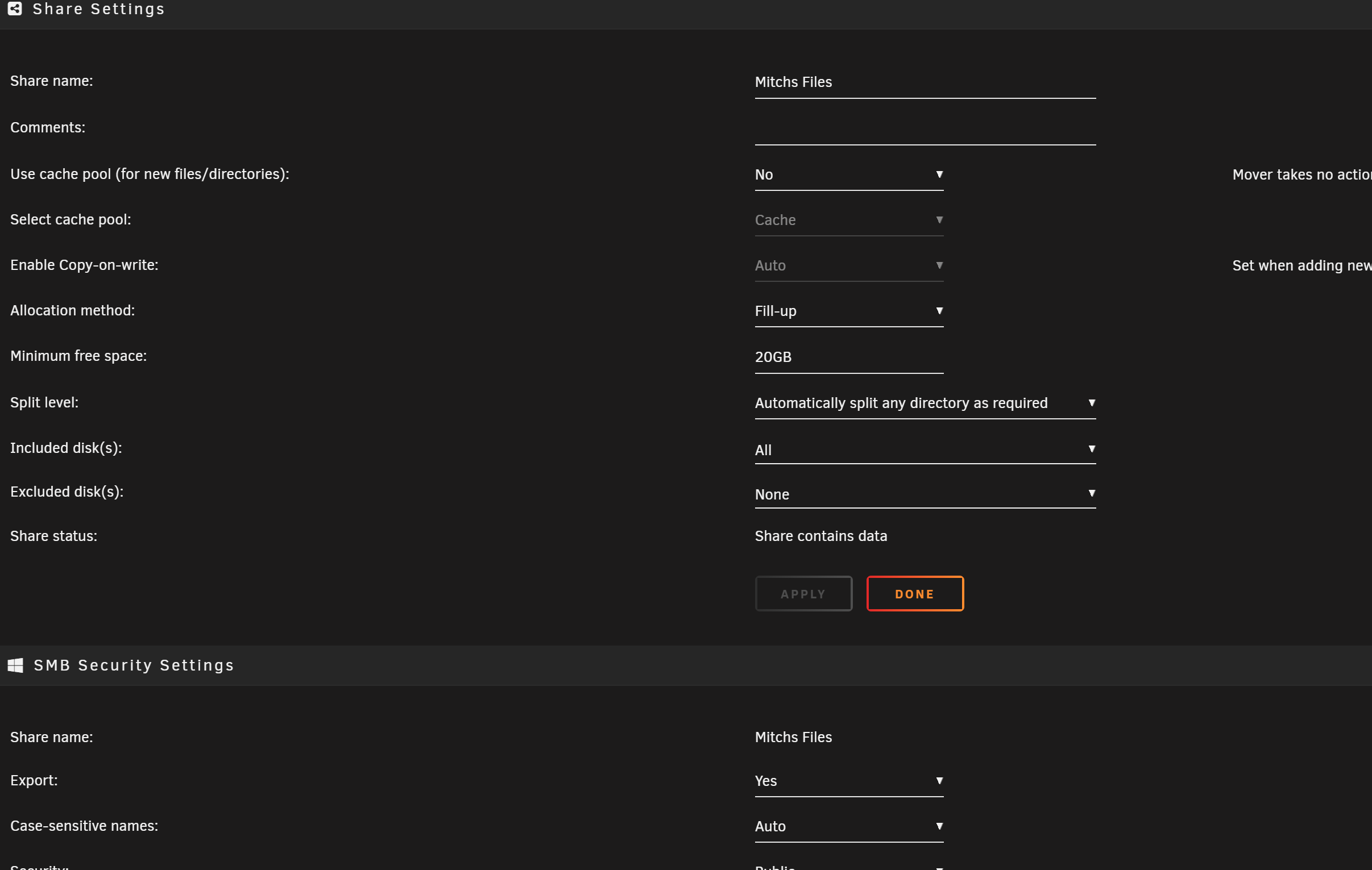

here is screen shot..  the only thing i changed is Disk 7.. before it was set to All
because when i was copying like i said 50gb  of files of 1kb - 100 meg in file size  it just ripped it down there.. but then i watched Free Space slowly going like 1gb  1.2gb till it hit 12gb free...  is my setting wrong then?
that when you hit 20gb free/min  it has to automacitlly goto next drive
so like the 2 disks theey are at 19.5  i using unbalance to move to disk 7  so my disk 1 doesnt show the 12gb free..
i wonder if there should be a different option.. instead a Min Folder/Disk  if there be a Minum  Disk min space
so Disk 1 cant go below 20gb  Disk 2 cant go below 100gb
but thats fine..    is my settings wrong

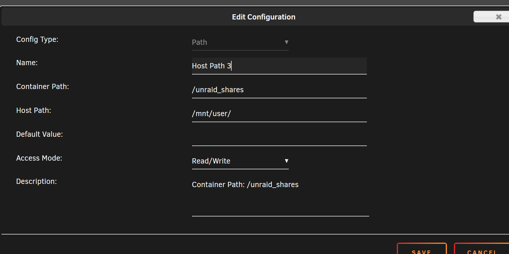

If unraid_shares is mapped to /mnt/user in the docker any data you copy to Mitchs Files will go to disk1 until there are less than 20GB free, then it will go to disk2, and so on.
so would the reason it was now stuck at 12gb free  is because 1 file was still big brought it below  20gb and left ti at 12gb.. but the other files brought it down to 100 megs free and then moved to disk 2 3 and so on...  cuz i not 100% sure it was working right then  as it shouldnt gone down to 100 megs free..  i wish i had screen shots or videos.. as im sure you think i crazy ..  but since now i moving things with unbalance i cant re create what i was experiencing..  i should taken pics...  its like  you experiencing computer problems you take to the computer store to them them show them it doesnt happen say way and they say your crazy there is no issues..... cuz least i could shown and then ud say yes working right or not it should never hit 100 meg free then go up to 12gb free and move to the next drive

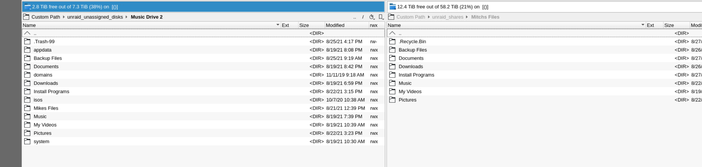

Edited by comet424
Disk1 has 135GB free according to your screenshot
thats because i mentioned above yur screen shot post  i using Unbalance to move files to disk7 to try to make it so like my sisters files are on 1 drive not 6, and unable to recreate  the issues now..  when i wrote the help this morning    Disk 1 had 12.1gb free  this morning at time of starting this post...
hopefully  with me moving files with unbalance.. and me setting all the drives to split automatic and 20gb min  it solves it all
as i trying to sort my drives now to fit certain things on 1 drive not span it over all the drives
so thats why it looks like 135gb   unbalance is running moving files from 6 disks to Disk 7... as i just added the 12tb  free space drive  last week to the array.. and figured may unbalance fix this..  going  down to 100meg..  like i mentioned i wish i had screen shots..  no one ever believes you  unless you got screen shots
