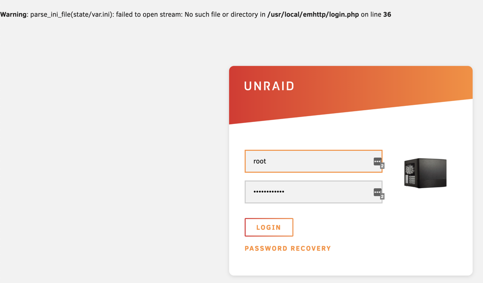

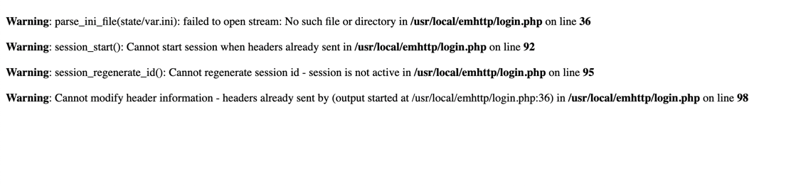

I got a new MacBook Air and upon the first day logging into unraid after I restored from a Time Machine backup I had on my shares in unraid I get the 2 messages below when hitting the GUI. All browsers give the same message.
SSH works so I ended up rebooting and the problem went away yesterday. Today my scheduled back up kicked off and then all of a sudden the same messages. Thought it might have been a fluke so rebooted again and then I could log in again. Now I started the backup again and around 50 of 80GB I'm back to this again.
