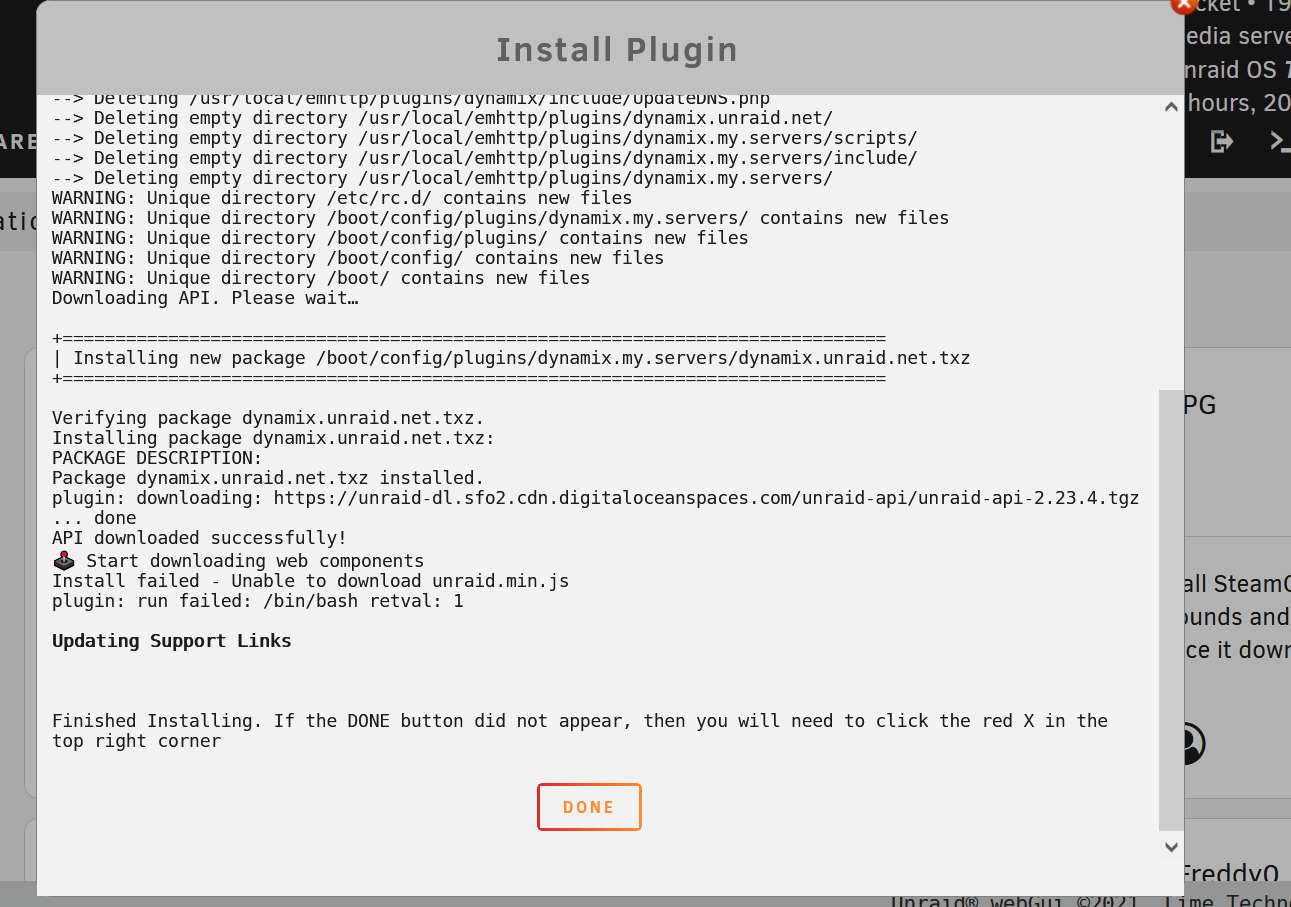

Hi all. First of all a question, does the my servers plugin not work with the trial key?
If it does...i get an error msg "install failed-unable to download unraid.min.js
Plugin: run failed bon/bash/ retval: 1"
Its a fresh install, the hardware is solid.
I can post the diagnostics log if needed..
Tried a different usb stick...
Anyone?
Hmm can you try again and post a screenshot of the whole installation screen?
Diagnostics would be good too, I suspect a networking issue

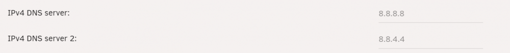

OK so your server is having DNS issues.
Looks like it is set to use this as the DNS server:
  192.168.0.1
I'd recommend going to Settings -> Network Settings and changing that to Google's public DNS servers: 8.8.8.8 and 8.8.4.4
I love you
Ok so yes...downloaded and successful install now.
