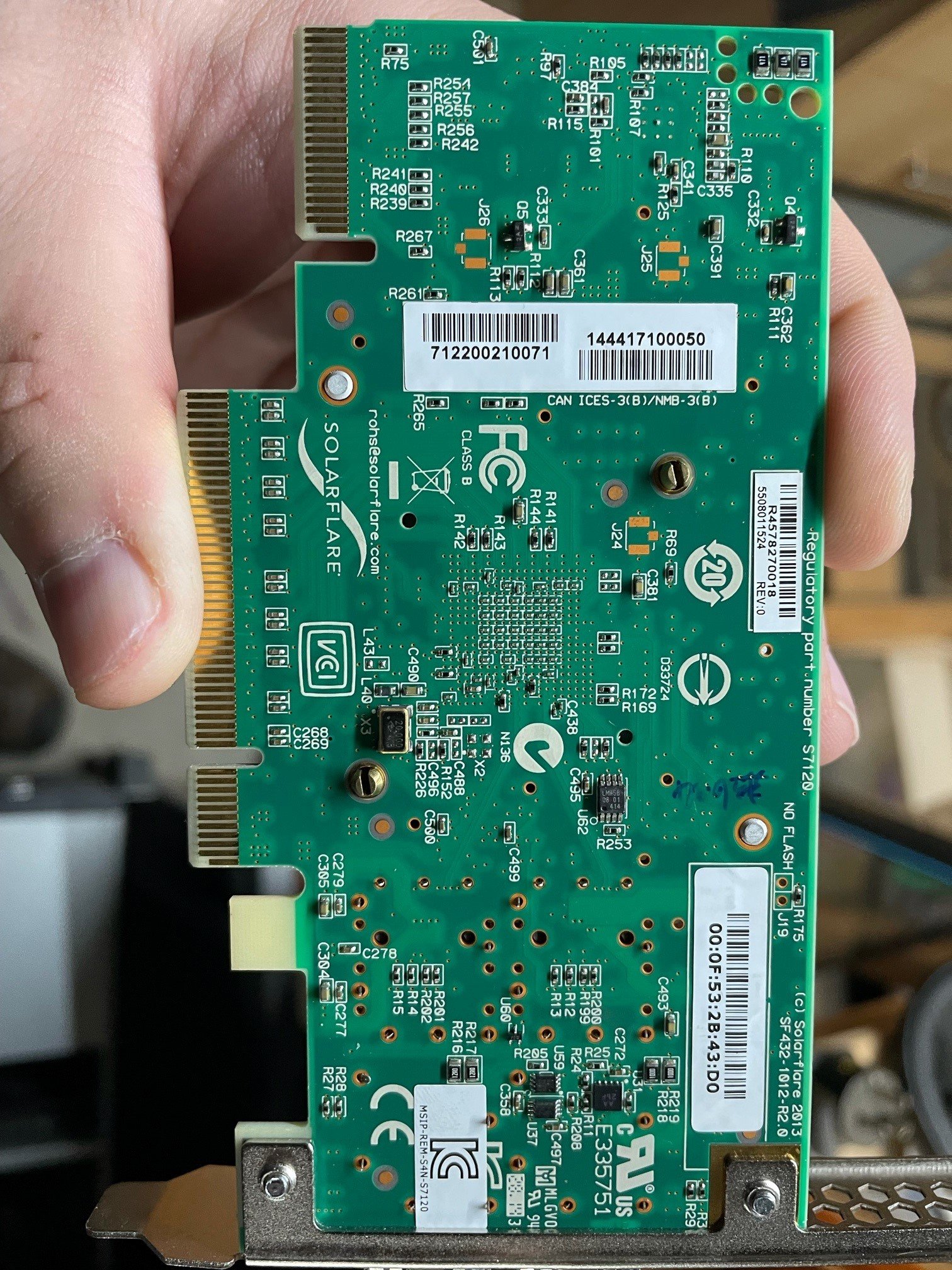

Here is the card. Nothing too obvious on the card from what i can see
so looks like VID is
1924 / 101404cc which isnt on the driver list on your command.
