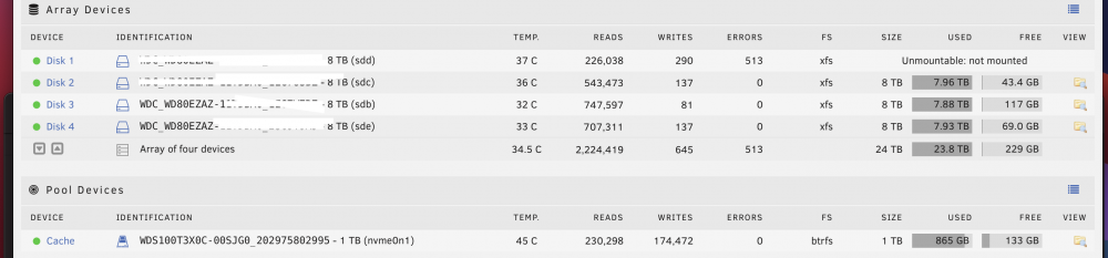

August 30, 20215 yr Hello! Im running a Unraid server with the following specs: x570 Aorus Master Ryzen 3900x RTX 3070 4x 8TB WD Red 1x Wd-black sn750 cache Yesterday I tried starting my Unraid array, it did start but the first disk is listed as 'unmountable: not mounted'. After that I ran xfs-repair -v from the gui, which finished without problems but the disk remained unmountable. Running that same command in an command line results in this output: root@Tower:~# xfs_repair -v /dev/sdd Phase 1 - find and verify superblock... bad primary superblock - bad magic number !!! attempting to find secondary superblock... .found candidate secondary superblock... unable to verify superblock, continuing... .found candidate secondary superblock... unable to verify superblock, continuing... .found candidate secondary superblock... unable to verify superblock, continuing... .found candidate secondary superblock... unable to verify superblock, continuing... .found candidate secondary superblock... unable to verify superblock, continuing... .found candidate secondary superblock... unable to verify superblock, continuing... .found candidate secondary superblock... unable to verify superblock, continuing... ............................................................................................................................................................................................................................................................................................................................................................................................................................................................................................................................................................................................................................................................................................................................................................................................................................................ this is then running forever. Then I ran a s.m.a.r.t extended self test which completed without error despite taking the whole night. Am I out of luck? Or are there other possible solutions which I should try? Thank you for your help
