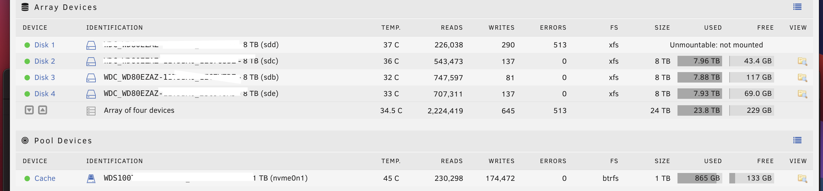

229524511_Bildschirmfoto2021-08-30um12_55_38.thumb.png.39c92f1e2d7371f346af5d75b9c24e5d.png
Yesterday I tried starting my Unraid array, it did start but the first disk is listed as 'unmountable: not mounted'.
After that I ran xfs-repair -v from the gui, which finished without problems but the disk remained unmountable. Running that same command in an command line results in this output:
root@Tower:~# xfs_repair -v /dev/sdd
Phase 1 - find and verify superblock...
bad primary superblock - bad magic number !!!
attempting to find secondary superblock...
.found candidate secondary superblock...
unable to verify superblock, continuing...
this is then running forever.
Then I ran a s.m.a.r.t extended self test which completed without error despite taking the whole night.
Am I out of luck? Or are there other possible solutions which I should try?
Thank you for your help :)
