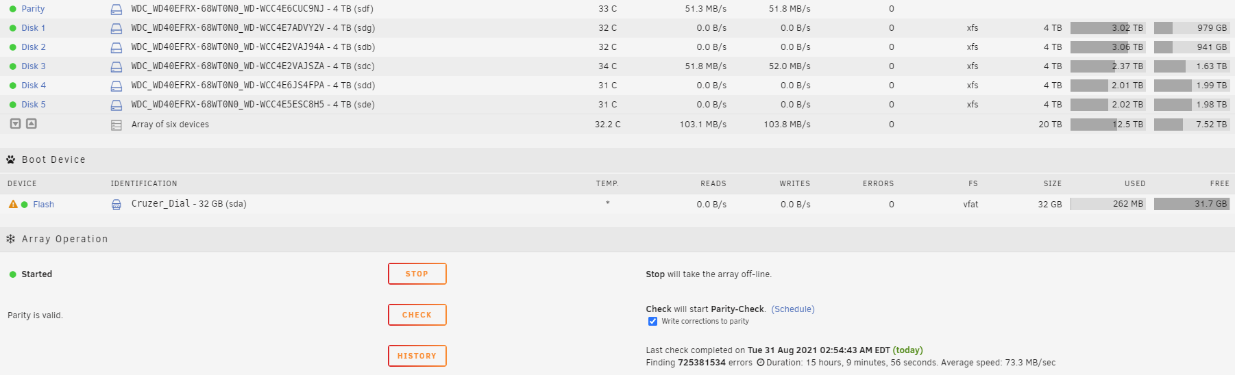

August 31, 20215 yr Author Yea the Drives were definitly used before I got them, so they definitly were not zero'ed out. 6 minutes ago, trurl said: Stop array Unassign parity disk Start array with parity disk unassigned Stop array Reassign parity disk Start array to begin parity rebuild Is there any risk of Data loss performing these Steps? And Should I wait until I finish moving my data over or stop moving Data and do these now?
August 31, 20215 yr Community Expert Parity contains none of your data and no disk except parity is written by parity rebuild, so no risk to rebuilding parity except for the fact that you don't currently have valid parity so if you do have a problem with a data disk you might not be able to recover it. Many people do the initial data load without parity since parity writes slows things down. If you have the original source data then not much risk to running without parity for the initial load. If you want to run without parity, just do steps 1-3, then when finished with the initial load, do steps 4-6.

September 1, 20215 yr Community Expert 1 minute ago, ZeroThirtySeven said: Is this Correct? No Device the same as Unassign? yes

September 1, 20215 yr Community Expert That screenshot is pretty soon after starting so might not be a good indicator of what the speed will be. I usually estimate 2-3 hours per TB of parity unless you have bottlenecks like port multipliers, so it should complete a lot sooner than it shows there. Just noticed a Marvell controller in your diagnostics. Those are not recommended but leave it for now and see how it goes. Is the Errors column on Main all zeros?
September 1, 20215 yr Author In My Previous issue with the DISK 1 slot not mounting/Formatting, the Marvel Controller was already brought up and I found that that Motherboard only uses thoes for the eSATA which are not being used in my configuration. I believe it is the standard AMD controller for the Motherboard SATA. The Speed definitely picked up after I posted. I have a bout 4 hours remaining. I will most likely not be awake when it finishes. I do not see it listing any errors as part of the Parity-check/Data-rebuild. There are also currently no disk errors listed. Edited September 1, 20215 yr by ZeroThirtySeven
September 1, 20215 yr Community Expert That's more writes than I would expect to the data drives. Nothing necessarily wrong with that. Are you still loading data while building parity? Nothing wrong with that either but it would slow things down.

September 1, 20215 yr Community Expert 1 hour ago, ZeroThirtySeven said: Upon booting back up, it started doing another Parity-sync/Data-Rebuild. Does it actually say that? Just want to make sure it isn't only doing a non-correcting parity check due to unclean shutdown.
September 1, 20215 yr Community Expert 46 minutes ago, ZeroThirtySeven said: I have gotten Errors on Disk 5 however. Unless that gets worse let it continue. We will do a parity check after anyway. Get us new diagnostics after rebuild completes (or if it looks like it is going bad) and don't reboot.
