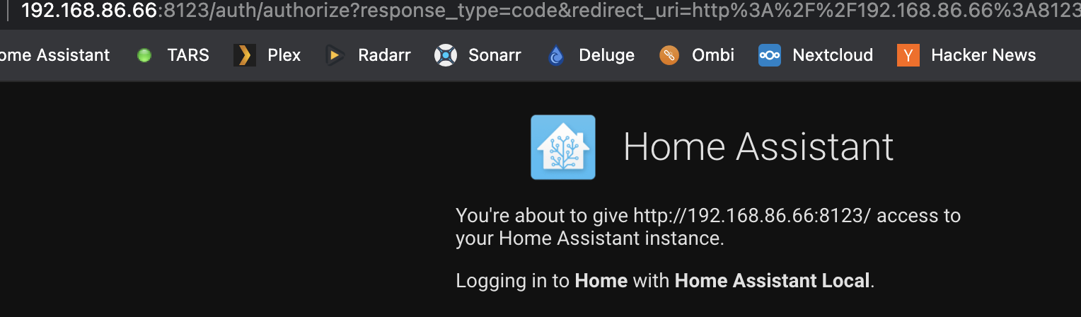

This was necessary to get things working in my set up, however, I can't access HA locally now!
