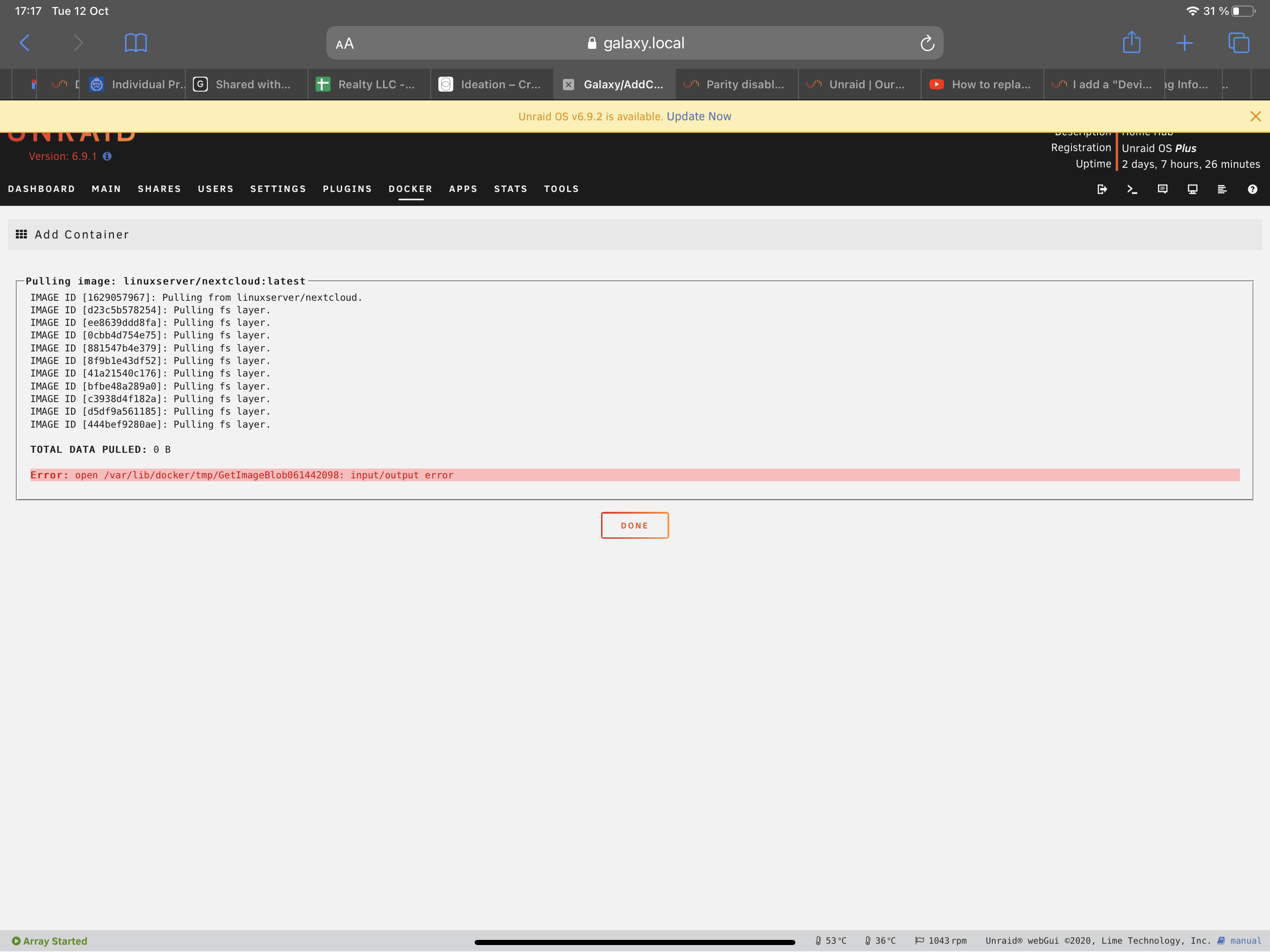

also I was able to start Dockers. But when I try to add the containers back I get the attached error.  If I can get over this maybe I can get my dockers working again.
UPDATE- A reboot after the fixing the hardware, re-adding the containers, the dockors are mostly back working. All except Nextcloud, but imam working on that.
Thanks for all your help and good wishes.I know I will be back soon with another sad story. ;-0
