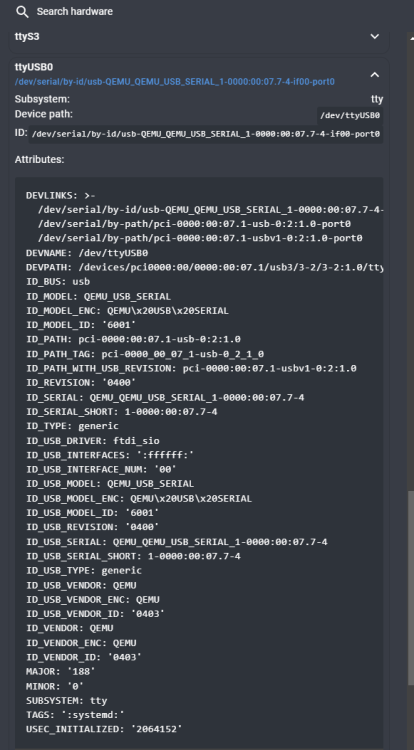

I added the USB using the unRAID VM GUI, like I imagine most would, by just checking the tick box next to the device. This didn't work. While Home Assistant found the device, the integration would not add (there were communication errors).
The trick was to add the device as a serial-usb device. AFAIK you cannot do this via the GUI. So I added the following code to my VM config:
    <serial type='dev'>
      <source path='/dev/serial/by-id/<yourusbid>'/>
      <target type='usb-serial' port='1'>
        <model name='usb-serial'/>
      </target>
      <alias name='serial1'/>
      <address type='usb' bus='0' port='4'/>
    </serial>
I was then able to add the integration easily. Interestingly, it didn't auto discover, but that's just an aside.

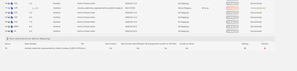

  • The latest release of my USB Manager plugin now supports Serial USB mappings when the VM Starts. I am still working on hotplug when the device is connected.   See this post for screen shots.
  • chris_netsmart
    chris_netsmart
    @SimonF  it looks to be OK, I haven't tested any of my devices at the moment, as I have few that are in some interesting places,  but one I had removed that the <hostdev> code and added the Zigb
  • After reverting back to 6.9.2 and using the "USB Manager" plugin, mine has been really stable even through HASS VM reboots.  Make sure the VM config itself is not set to auto mount the USB though and

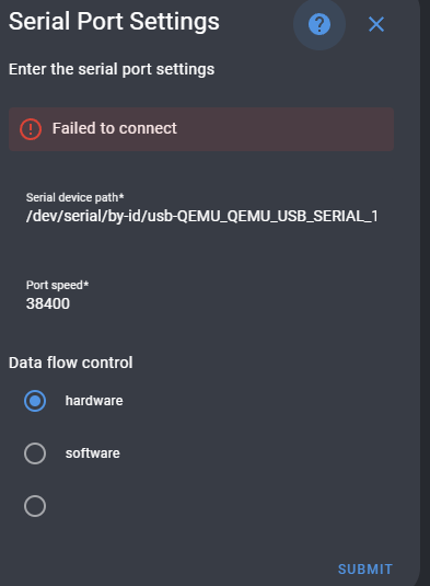

Hey everyone,
i bought a conbee II a few days ago and the passthrough to the VM in Unraid is only pain.
i started with adding the stick via the gui like @danioj. it got recognized from unraid, i set up the integration (Zigbee Home Automation) but i can't find a single zigbee device. I tried the Hue motion sensor and the multipurpose sensor from Aoetec. Nothing, just silence and devices blinking to oblivion... i began browsing the web and found several things i tried but they didn't work. and i found this posting. i passed the stick through, set up the integration but again...nothing. Yesterday i set up a raspi with home assistant to confirm that the stick is working because that stupid deconz thingy wouldn't work and find devices via windows... and it worked...he found both sensors within seconds...
So the problem is the passthrough of the stick, it's getting recognized but it's functionality isn't working...
i passed usb devices through in the past with other vms but i never noticed that some of their functions weren't working properly
i'm out of ideas what to do next, i don't see errors or something i can grab on and fix it
maybe some of you have
thanks in advance
I'm in the same situation as above. I can get the usb stick recognised but it doesn't find any other devices. The stick shows as "offline" in the topology.
Seems to me like it's broken.

Has anyone had any luck with a permanent fix recently? I'm on 6.9.2 and running HA in a VM and my conbee II stick disconnects via USB passthrough sometimes when updating or restarting HA. Right now the only fix is to shutdown the VM and then bring it back up. However, for the first time last Friday, it took me 2 attempts at shutting down the VM and bringing it back up. Wanted to check in before I tried the above.
After reverting back to 6.9.2 and using the "USB Manager" plugin, mine has been really stable even through HASS VM reboots.  Make sure the VM config itself is not set to auto mount the USB though and let the plugin handle it.
Is this still working for you? I just followed this tonight and after a restart of home assistant, the Conbee II disconnected. The hotplug feature makes it a lot easier to reattach it to the VM without restarting, but I'm uncertain about how to get it to persist after a HA or VM restart. Is that what "Enable HUB Processing" or "Enable USBIP" does by chance?
Edited by ThatTallGuy21
I have replied to you post on my plugin page you dont need those two options. Ignore question about which hotplug.
you should see USB on menu bar.
Wow thanks for responding to me here as well. I didn't even realize there was a USB tab added to the nav bar, nor did I know libvirt had a hotplug feature to begin with. (facepalm.. lol) Thanks for pointing this out here and in the response on how to configure it on the USB Manager plugin page. Thanks for all your efforts with this plugin and help here!

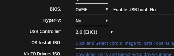

So I'm having the same issue.
I have a Sonoff 3.0 Zigbee USB Dongle. Works 100% if I have it attached to a usb extension cable, but if I remove it from the cable and plug into the exact same port on the mobo, broken. No zigbee devices are read or able to connect.
Also, it won't pass zigbee data through to the VM if I have it selected in the xml or if i hot plug the device during boot. If I let the VM come up, then hotplug, reload the integration, everything works. Thats the only way it will.
Anyone got any idea what to do to fix this?

I updated to 6.10 today and discovered I am having this issue now.
Upgrading my conbee II to the latest firmware did not help.
I also tried adding it as a serial usd device as described in the first post which also did not work.
Is there a solution for this problem?
From the description it seems that you are using a 3.x port on your mobo and a 2.0 cable, so your devices works in 2.0 mode; when attached directly to the port it's 3.x (?).
