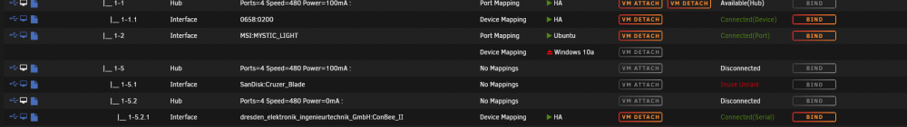

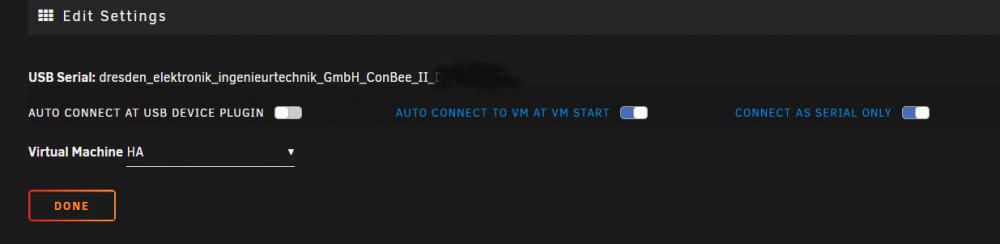

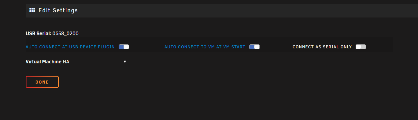

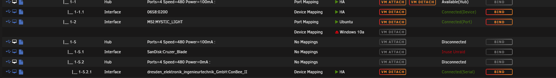

  • The latest release of my USB Manager plugin now supports Serial USB mappings when the VM Starts. I am still working on hotplug when the device is connected.   See this post for screen shots.

    @SimonF  it looks to be OK, I haven't tested any of my devices at the moment, as I have few that are in some interesting places,  but one I had removed that the <hostdev> code and added the Zigb
  • After reverting back to 6.9.2 and using the "USB Manager" plugin, mine has been really stable even through HASS VM reboots.  Make sure the VM config itself is not set to auto mount the USB though and

After updating the plugin, I now see the toggle for "Connect as Serial Only".  Thank you.

4 minutes ago, jgosnell said:
Is there a setting that we would need to change to specify the serial connection option or is it automatically determined somehow?
We you set the VM Mapping you enable connect as serial only.
For my ZWAVE Stick I can connect just as a normal device.
Edited by SimonF
