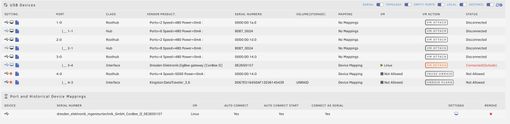

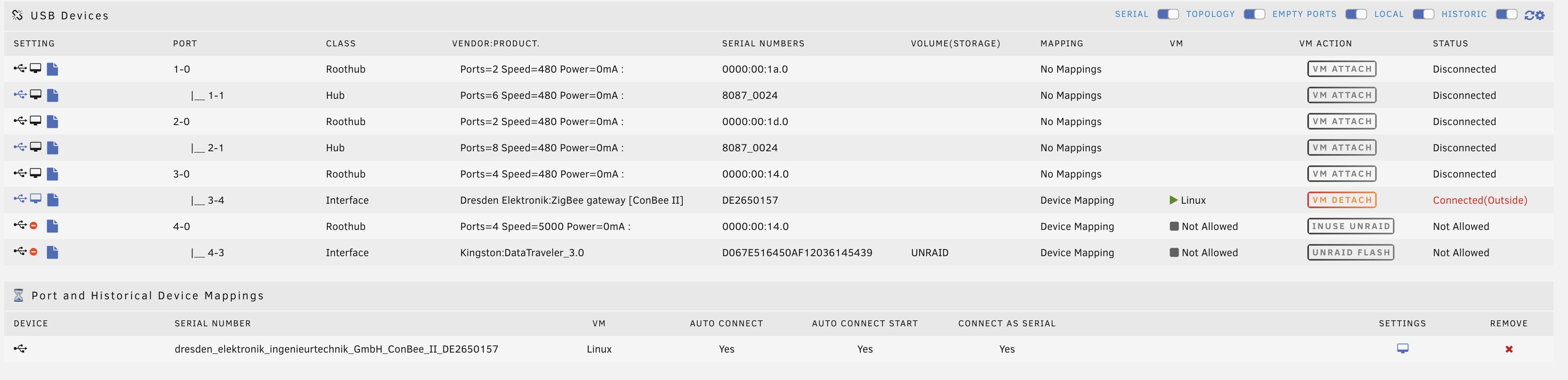

  • The latest release of my USB Manager plugin now supports Serial USB mappings when the VM Starts. I am still working on hotplug when the device is connected.   See this post for screen shots.

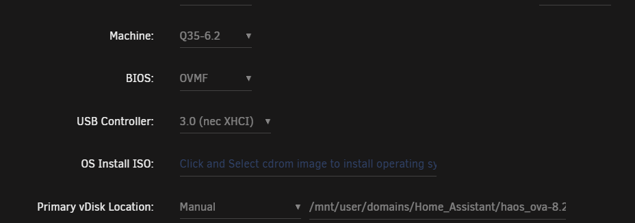

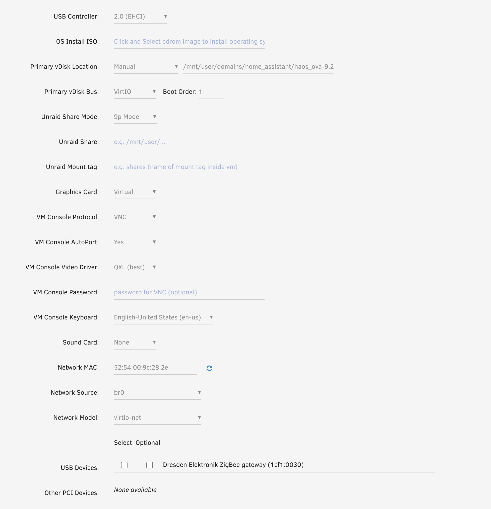

Running UnRaid 6.10.3 and VM as follows
After "upgrading" the VM machine type and usb controller type to match yours, HASS no longer can see the device.  Troubleshooting now.

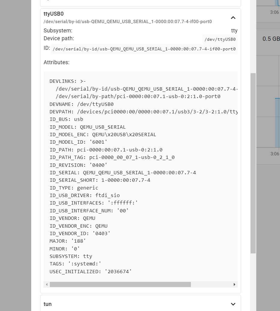

I had to edit the core.config_entries file is HASS to reflect a change in the device path.
Old path:    /dev/serial/by-id/usb-QEMU_QEMU_USB_SERIAL_1-0000:00:07.7-4-if00-port0
New path:  /dev/serial/by-id/usb-QEMU_QEMU_USB_SERIAL_1-0000:00:07.0-4-if00-port0
All is working again now.  I am still getting the serial and console entries but since everything seems to work I am not going to worry with it.

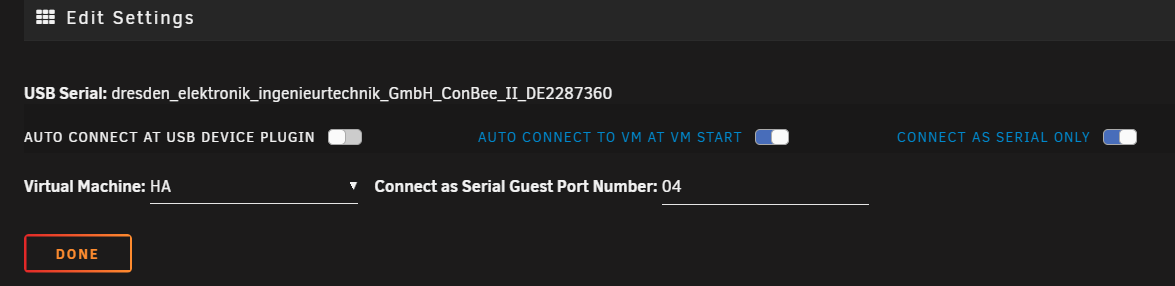

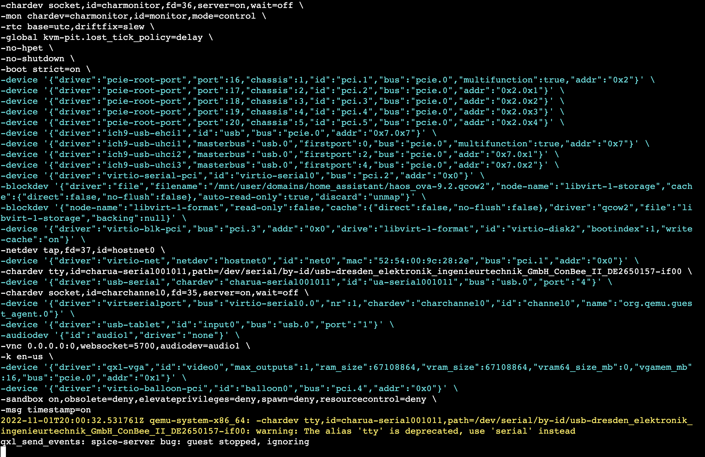

As every thing is working for you and I cannot recreate the issue I wont continue to investigate.
I have added support for hot plug of a serial attach device now and you can set the port number to be used on the address line on the edit settings page for the USB device, defaults to 4.
  • 4 weeks later...

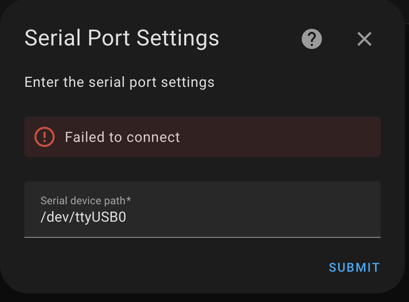

After struggling a little with getting this working, matching the target port on unraid did the trick:
Unraid > Tools > System Devices:
<serial type='dev'>
      <source path='/dev/serial/by-id/usb-dresden_elektronik_ingenieurtechnik_GmbH_ConBee_II_DEXXXXXXX-if00'/>
      <target type='usb-serial' port='2'>
        <model name='usb-serial'/>
      </target>
      <alias name='serial0'/>
      <address type='usb' bus='0' port='4'/>
</serial>
I then had to remap the z2m port in the Settings > Addons > Zigbee2MQTT > Configuration:

I had not to switch to q35 v4.2. I am using q35 v6.2 and it works for me ;)

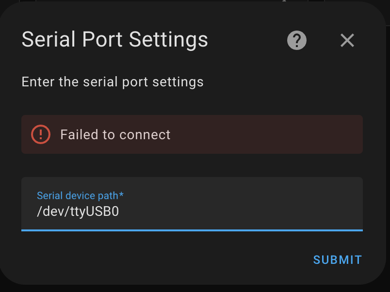

I had to update from 6.9 to 6.11 and I loss my ConBee device,  I followed the steps, but I am still no able to connected.
the steps I follow was to modify my VM Config by adding the following code
<serial type='dev'>
      <source path='/dev/serial/by-id/usb-dresden_elektronik_ingenieurtechnik_GmbH_ConBee_II_DE2496880-if00'/>
      <target type='usb-serial' port='1'>
      </target>
    </serial>
but when I when to find /config/hardware within HA HACS I was not able to find it.
where is it locate.

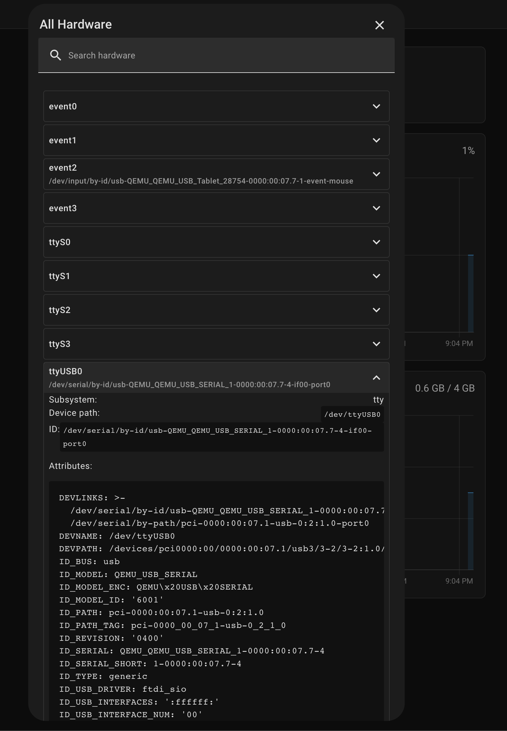

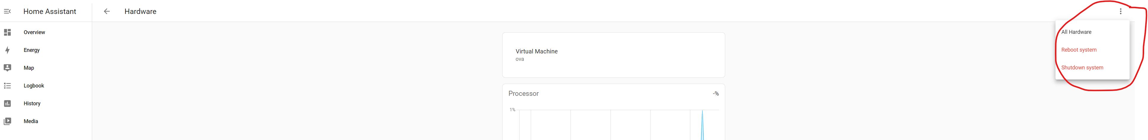

It will show like this.
have a think moment - how did you get that window.
settings->system->hardware.
For me it shows just Virtual Hardware ova.
There three vertical dots, click on that and select all hardware
OK I have found the information - Thanks @SimonF
but now here is the interesting bit.
here is a screenshot of my information page.
but when I go through the steps to set up my Zigbee Home Automation.  it is failing,  I will post my information and see if anyone can see my mistake and help me.
here I am guesting
results
here I am guesting
results

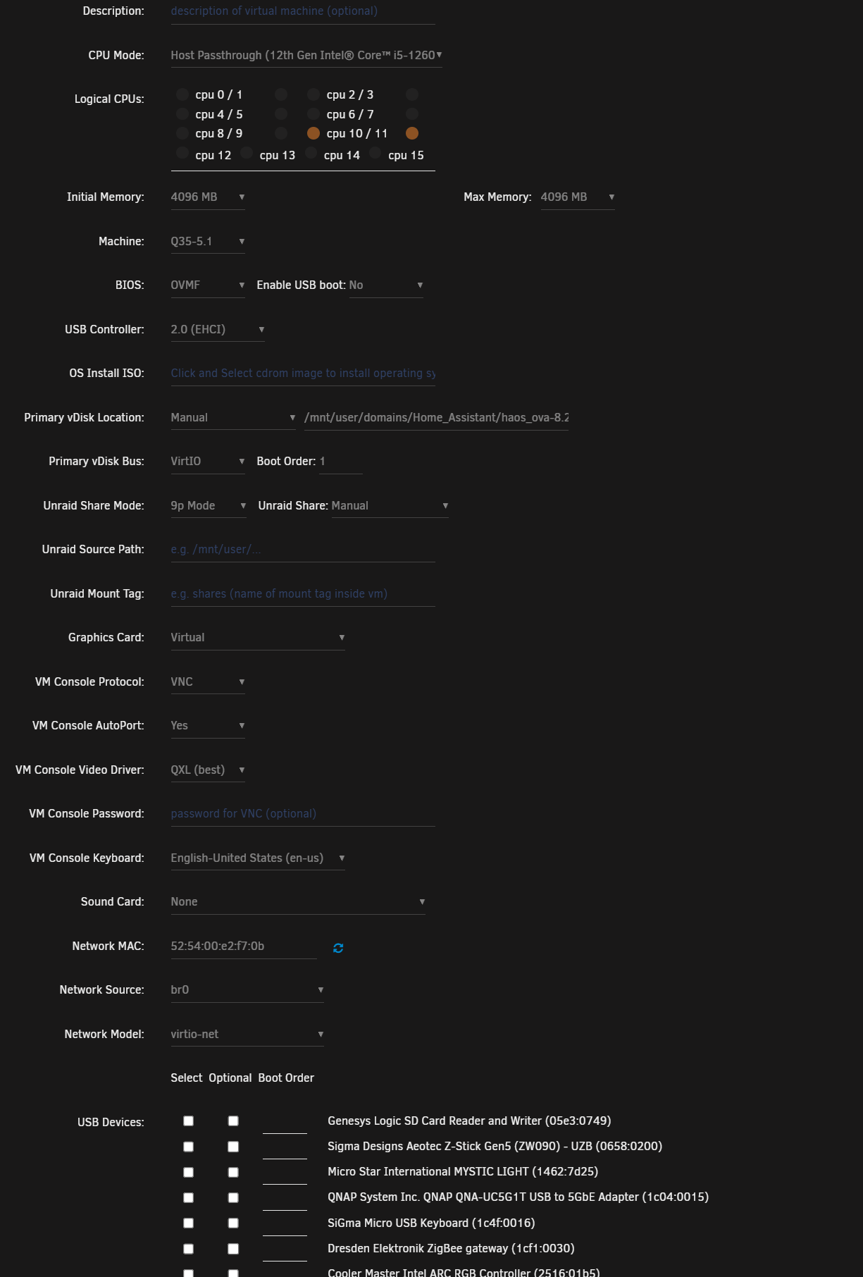

You should not see the dresden name if mapped as a serial USB. Can you post your XML for the VM? Did you remove the USB from the VM Template?
good morning. @SimonF is my XML for my VM
<domain type='kvm' id='9'>

But you need to remove this block or you can uncheck in the vmtemplate.
    <hostdev mode='subsystem' type='usb' managed='no'>
      <source startupPolicy='optional'>
        <vendor id='0x1cf1'/>
        <product id='0x0030'/>
        <address bus='1' device='39'/>
      </source>
      <alias name='hostdev0'/>
      <address type='usb' bus='0' port='2'/>
    </hostdev>

I've been having some trouble trying to setup my conbee 2 with homeassistant through unraid. I just bought it and thought it would be a breeze but after a quick search I found this forum thread. I've added some information about my struggles below and what I've tried from this thread. I hope someone finds the thing that I'm missing or has the solution to my problem.
I've used the usb plugin to connect it to my vm and it does show in homeassistant but when trying to connect it is giving errors
606204015_Screenshot2022-11-01at21_03_45.thumb.png.c1771885ed3e1f1d200a091dc4d5b223.png2092286093_Screenshot2022-11-01at21_04_15.thumb.png.7fe47cc751bb8d63bfd699eab1b4a57e.png2128240544_Screenshot2022-11-01at21_03_54.png.78edf74543191ca957aa38310b532a5d.png
I've also added the serial part to my VM XML as shown below

 I did notice it shows something about tty in the VM Logs as show below
1368836564_Screenshot2022-11-01at21_01_11.thumb.png.edc587990626c376dedaf8d707d952ea.png

Do you have it selected in the VM Template? it should be selected there either.
This is my template.
Edited by SimonF
No it's not selected in there either. I am running unraid 6.11.1 I don't know if that is giving any issues.

Just to check that you enabled the serial switch on the mappings? Also did you shutdown the vm and start?
Edited by SimonF
1993920490_Screenshot2022-11-02at20_04_56.thumb.png.c5d1d6792f568b51ee321f1cb1c70da7.png
I just tried it with the select and optional selected and it now shows Connected(Serial) in the usb tab but now its working if less in homeassistant.
