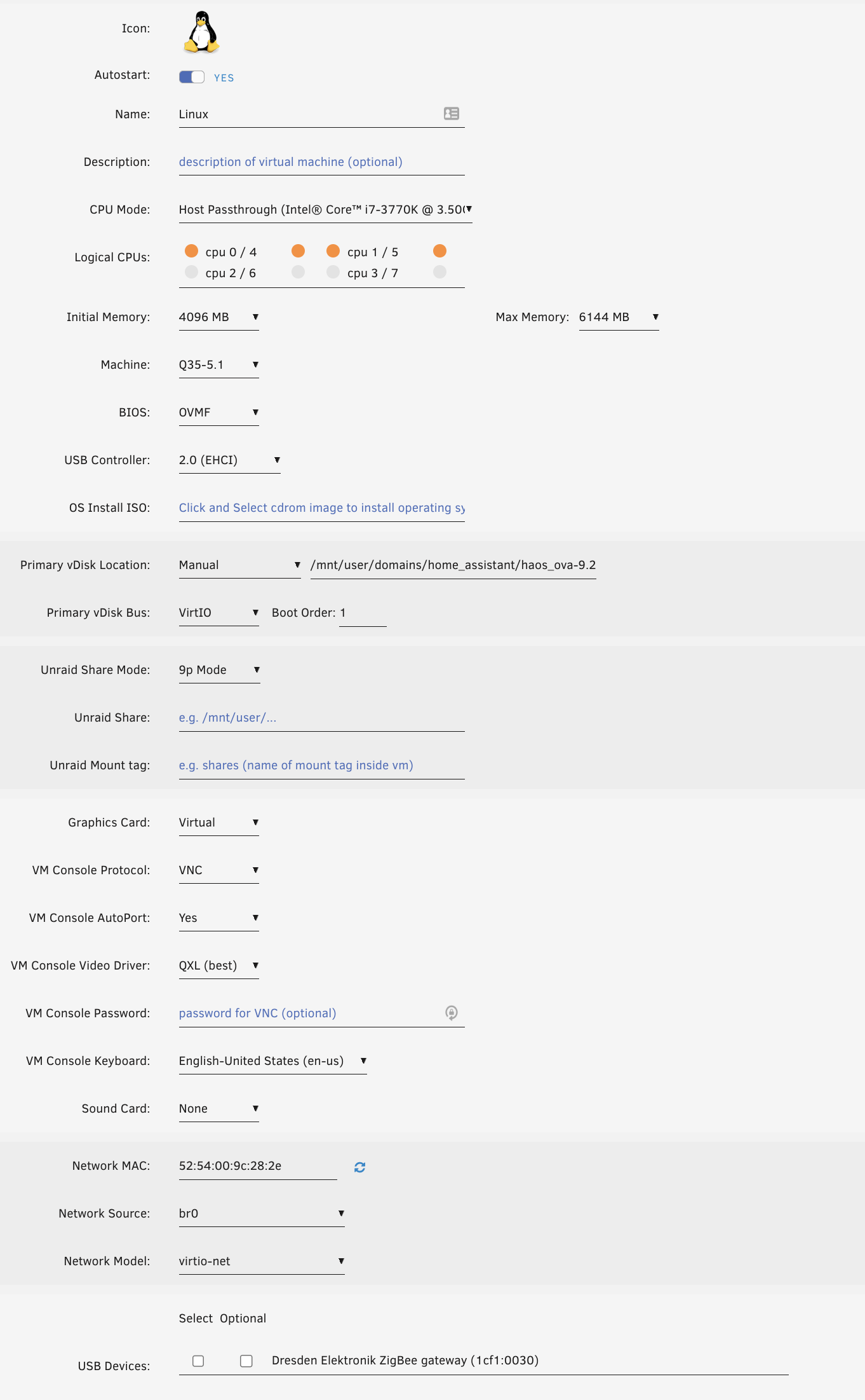

I just tried it with the select and optional selected and it now shows Connected(Serial) in the usb tab but now its working if less in homeassistant.
It should not be selected in the template.
You should select the /dev/serial/by-id/usb-QEM....... name in HA

my current settings are as show below. I've restarted a couple of times and in de serial device path I've tried both the prefilled and ID path you recommended but still is says Connected(Outside) in the USB tab and it won't connect trough ZHA.

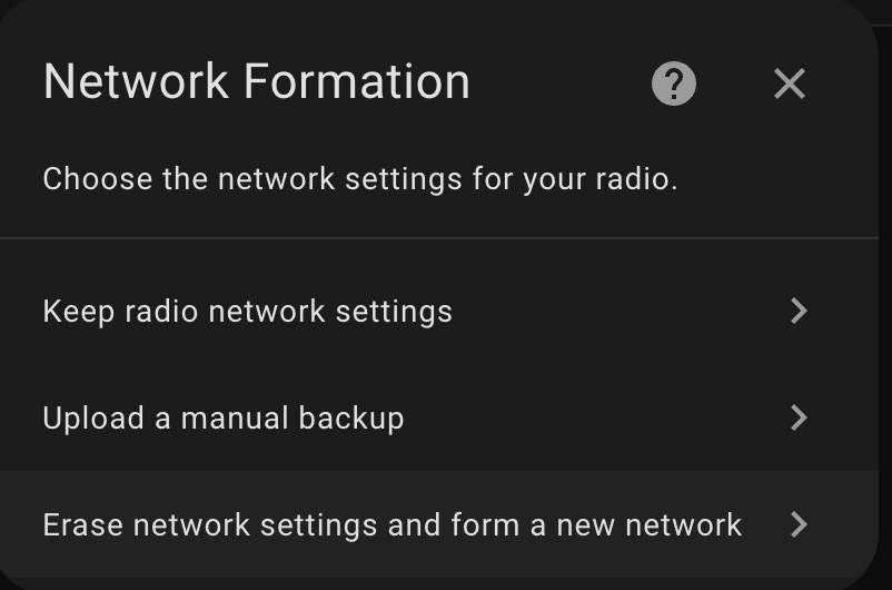

When I select keep radio network settings it will finish the setup but not work, and if i select erase network settings and form a new network, it says failed.

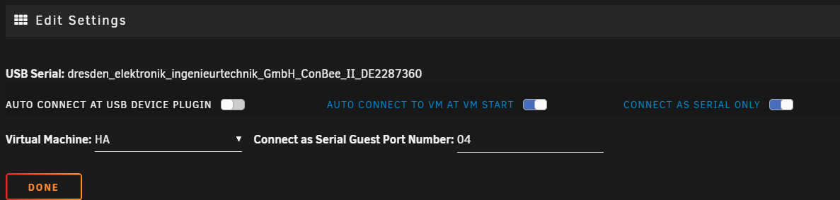

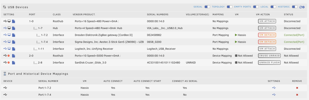

How are you mapping the USB device. You need to map as a serial device and will show in HA like this
If you are using my plug, mappings need to be as follows:
Yep that's the way I'm setup. Almost identical on the HA side.

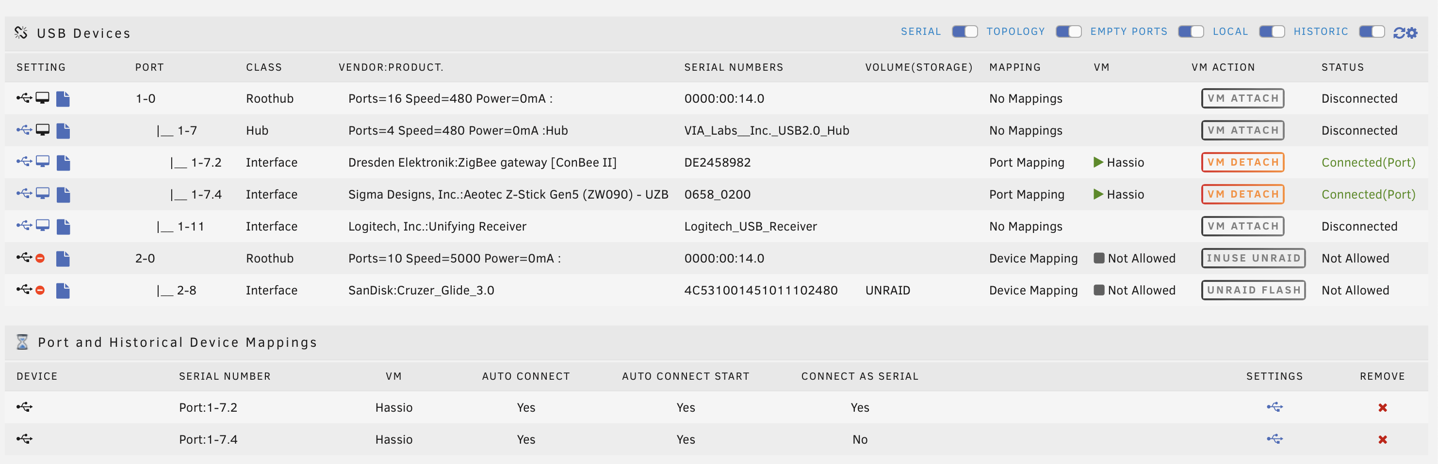

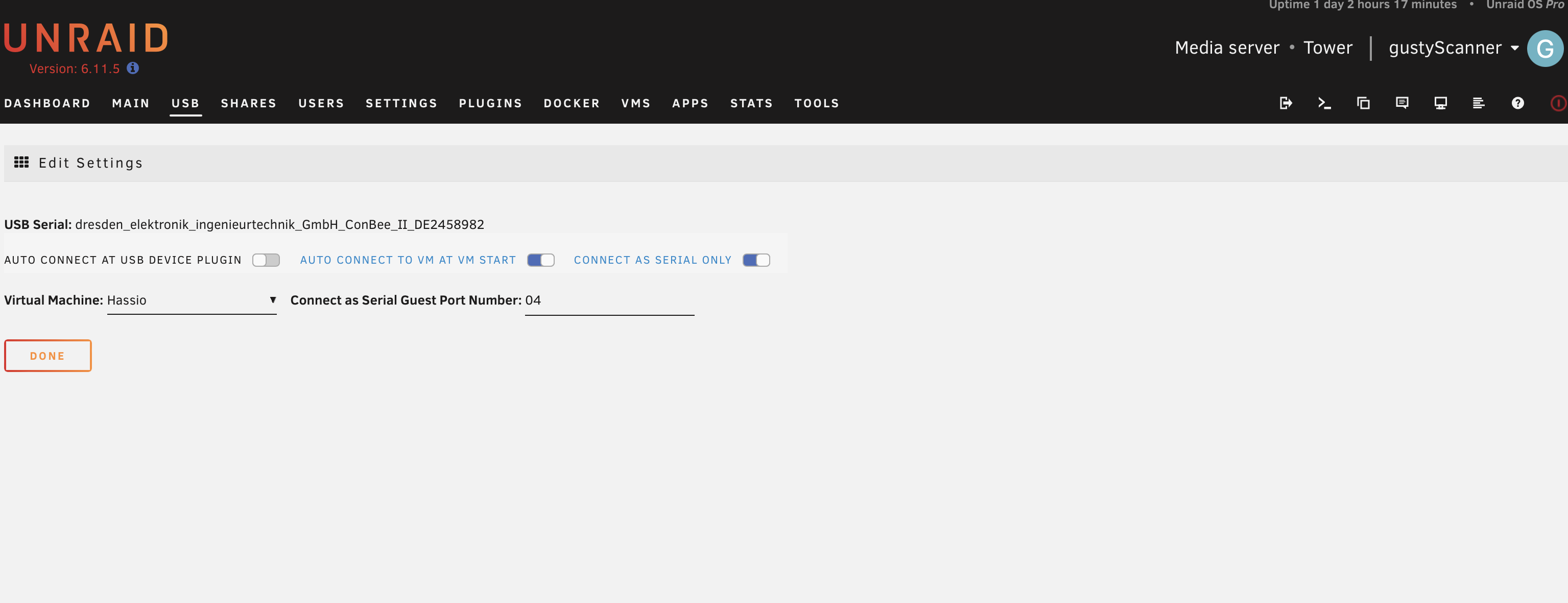

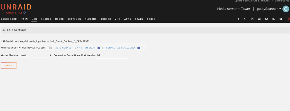

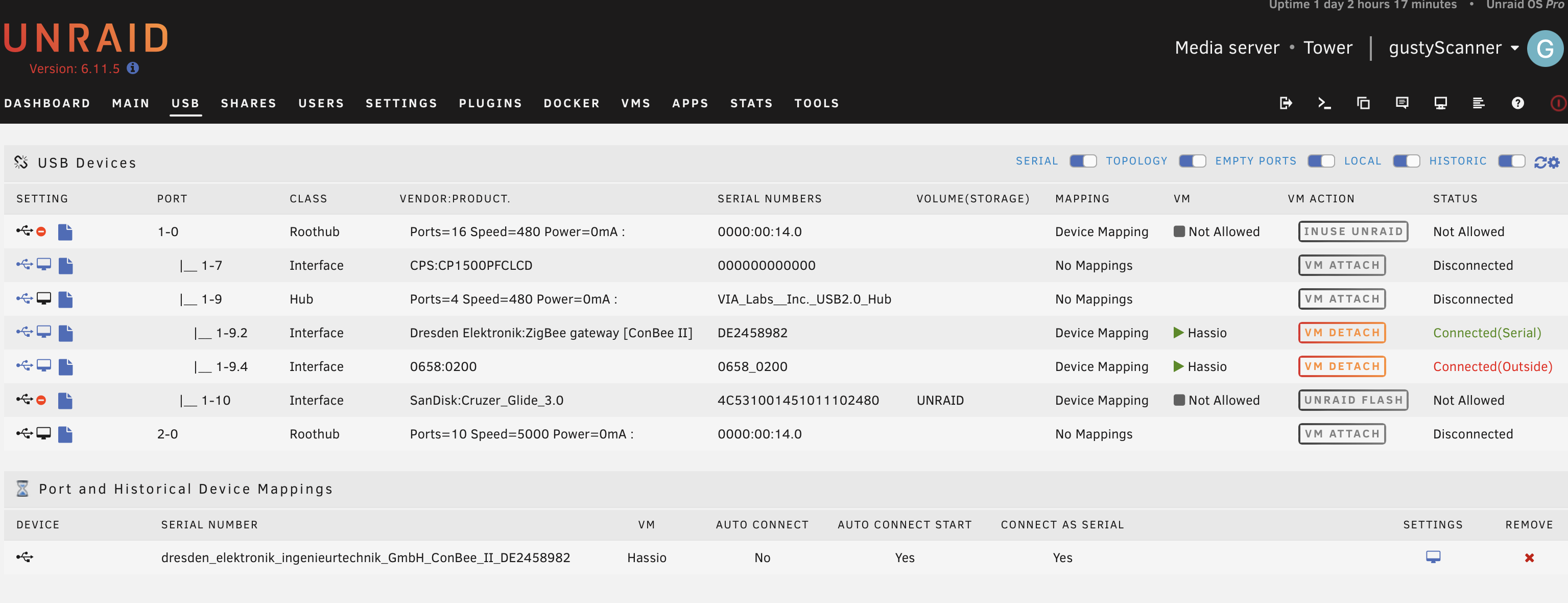

Hello,
I am having this issue. I am having some trouble following the instructions.
Right now in the "USB" tab via USB Manager I have this setup.
When going into the USB Settings there is both "Device" and "Port" settings. I do not think my Conbee is attached in "serial" mode.
Where are the "hardware" screenshots coming from? I am having trouble finding that.
3 hours ago, gustyScanner said:
Hello,
Should say connect(serial). Remove the port mapping and try as a device mapping to see it that resolves the issue.
Edited by SimonF
Thank you for the help. I do see connect(serial) now.

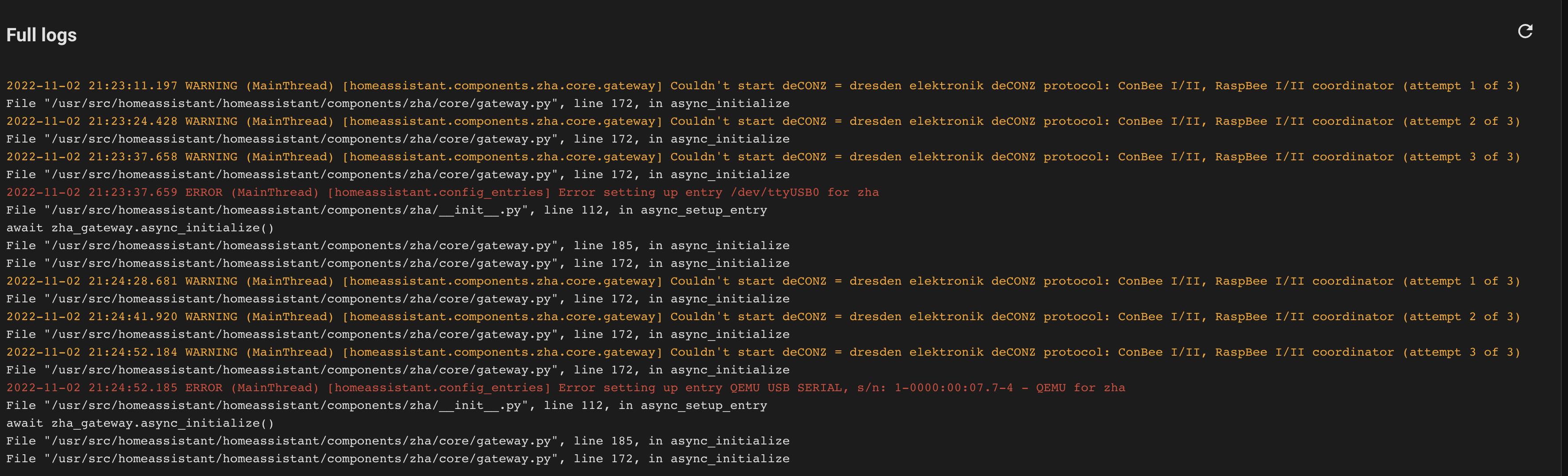

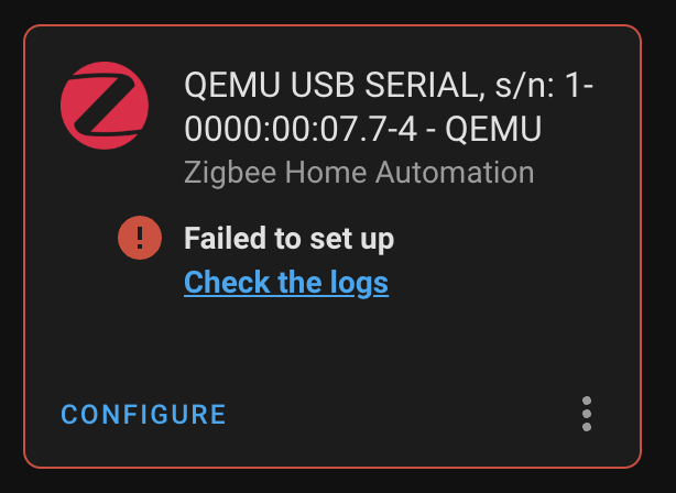

I wonder if I need to change a setting in HomeAssistant. I now see this error when the HomeAssistant Zigbee add-on starts. Note, I have removed the serial number from these logs:
Error setting up entry ConBee II, s/n: XXXX8982 - dresden elektronik ingenieurtechnik GmbH for zha
Traceback (most recent call last): File "/usr/local/lib/python3.10/site-packages/serial/serialposix.py", line 322, in open self.fd = os.open(self.portstr, os.O_RDWR | os.O_NOCTTY | os.O_NONBLOCK) FileNotFoundError: [Errno 2] No such file or directory: '/dev/serial/by-id/usb-dresden_elektronik_ingenieurtechnik_GmbH_ConBee_II_XXXX58982-if00' During handling of the above exception, another exception occurred:
File "/usr/local/lib/python3.10/site-packages/serial/serialposix.py", line 325, in open raise SerialException(msg.errno, "could not open port {}: {}".format(self._port, msg)) serial.serialutil.SerialException: [Errno 2] could not open port /dev/serial/by-id/usb-dresden_elektronik_ingenieurtechnik_GmbH_ConBee_II_XXXX58982-if00: [Errno 2] No such file or directory: '/dev/serial/by-id/usb-dresden_elektronik_ingenieurtechnik_GmbH_ConBee_II_XXXX58982-if00'
Seems closer, also seems like possibly the mount for serial/by-id is wrong? Here is what I see on my Unraid in CLI:
root@Tower:~# cd /dev/serial/by-id/
root@Tower:/dev/serial/by-id# ls
usb-dresden_elektronik_ingenieurtechnik_GmbH_ConBee_II_XXXX58982-if00@
Its very odd because the serial ID is the same, the paths I see in the error and in the above ls command are the same.
Hopefully this info is helpful, thank you again.

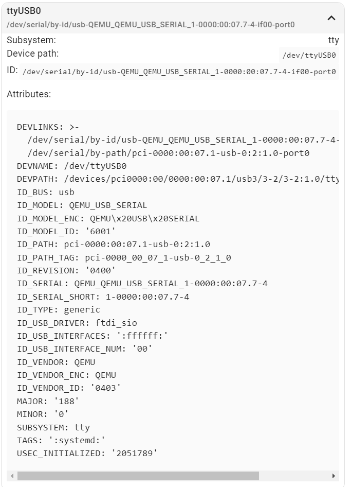

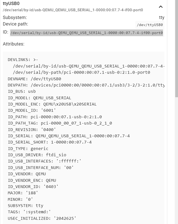

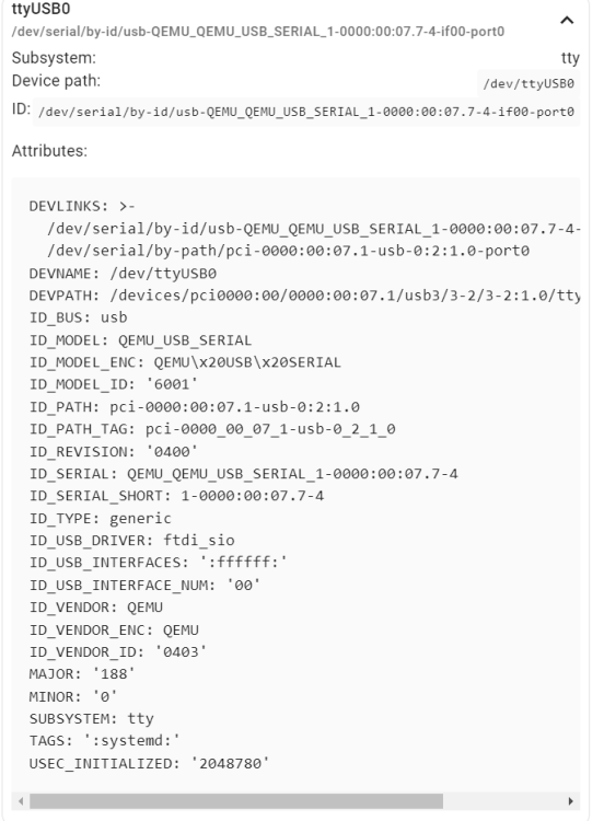

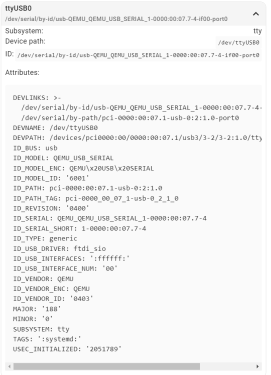

If you goto settings -> hardware and show all hardware then you will find the serial by id you need to use this one in your config not the host one.

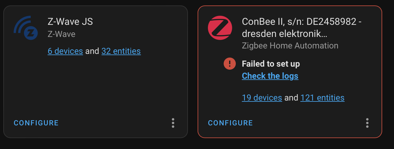

I'm sorry I must be blind. I do not see "Hardware" under settings on my Unraid server. In your screenshot is
I see Hardware in my HomeAssistant VM but it looks different from the screenshot.
I've attached screenshots of what I think are the relevant pages. I currently have a Z Wave stick passed through (working on the Wave integration), and the Conbee II for Zigbee

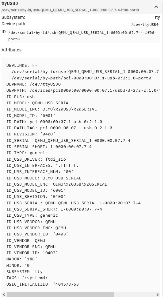

For anyone else running though this and struggling like i did, here are the Basic errors i made spelt out. in the hope it will help someone, or me if i ever need to go though this again in the future.
After spending several hours going through this forum and some home assistant ones - i undid everyting and restarted from scrach and found a basic error/assumption i had made on unraid that solved my issue.
I updated the conbee 2 firmware folling this - Conbee Firmware update
(this is the only change i didn't roll back.)
i plugged the conbee stick into a USB extension cable (2m) and moved it away from other elecrtical devices.
UNRAID:
in USB Manager - this is were my basic mistake happened...
i mapped the device NOT the port by clicking on the monitor not the usb symbol. -previously i was mapping the port instead of the device.
Made sure connect as serial only was selected, powered up the VM. USB manager showed "connected(Serial).

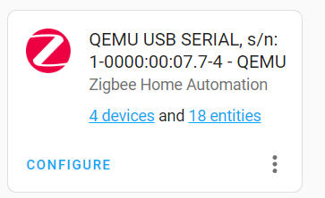

in HA: Version 2023.10.3 latest at time of writing.
HA Did not detect the conbee stick as being connected - attaching the via the port It was detecting it. - but failing
Settings --> System --> Hardware -->all Harware.
the stick now shows as
dont exactly know why but hey ho..
going back to device and services and adding the integration Zigbee home automation, and follwoing the promts set a new network up for me without any problems.
Hope this helps someone or future me...

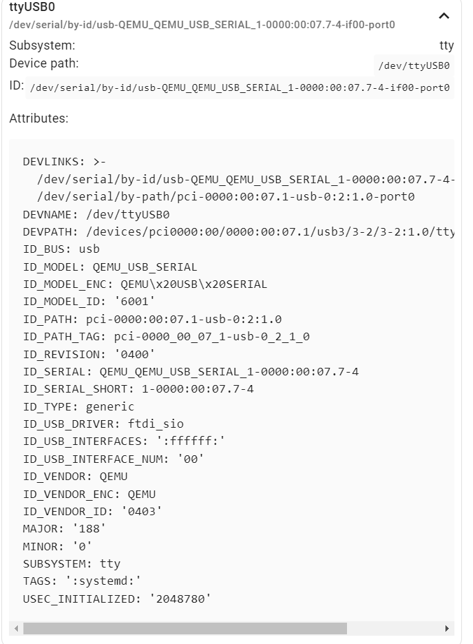

Thank you to everyone who has helped in this thread. Upgraded from 6.9.2 today and ran into the same issue.
Mounting as serial and updating the point to the new hardware address resolved the issue.
