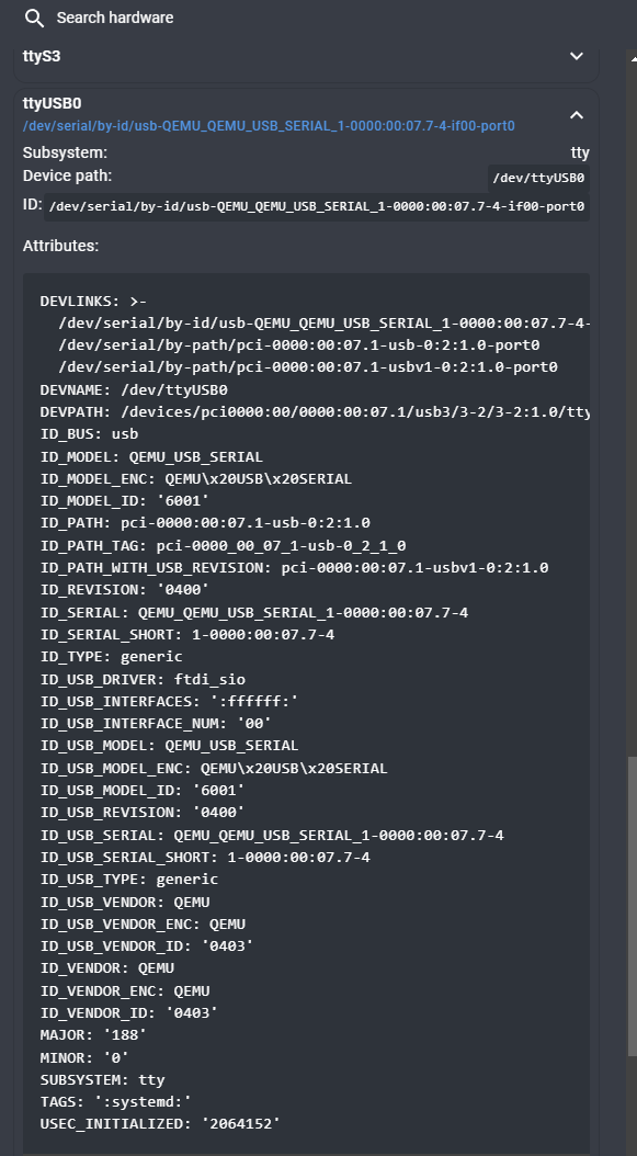

I think I have followed your instructions to the letter. This is the result in HA

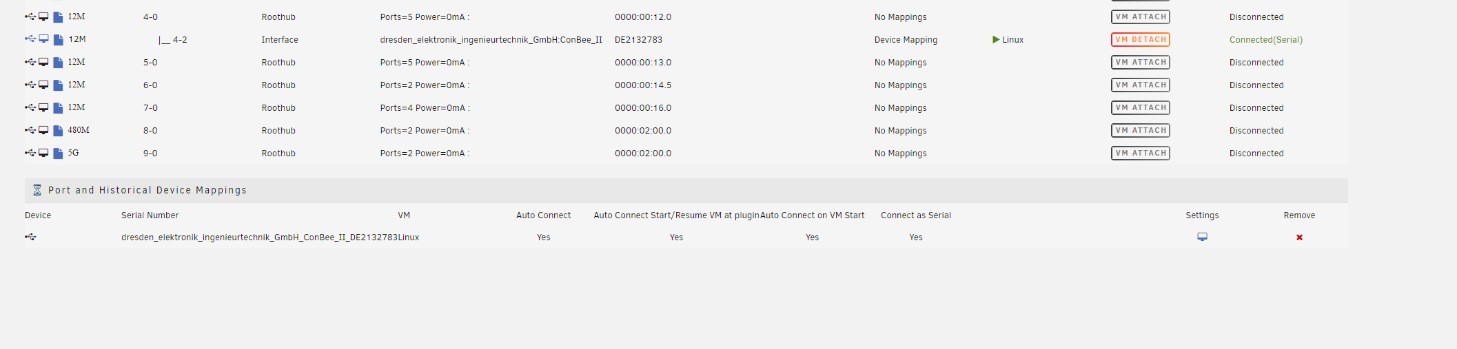

And this is the usb manger:
Anything I could be missing? I would hate to have to reset the entire network.

Looks to be ok to me. I would turn of start/resume VM as you will be unlikely to need it.
Which USB model are you using in the VM
