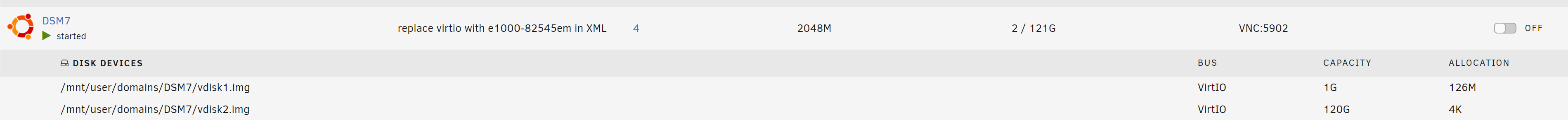

4. The VM Configuration:
4.1. Use Ubuntu as default Template
4.2. Set as Machine: Q35-5.1
4.3. Set the Bios to SeaBIOS
4.4. First HDD should be the Loader image
4.5 Second HDD should be a SATA disk.
4.6. Save the configuration WITHOUT starting the VM.
4.7. Go back to the edit page of the VM and switch to the XML view
4.7.1. Search the second HDD and change the Controller to 1.

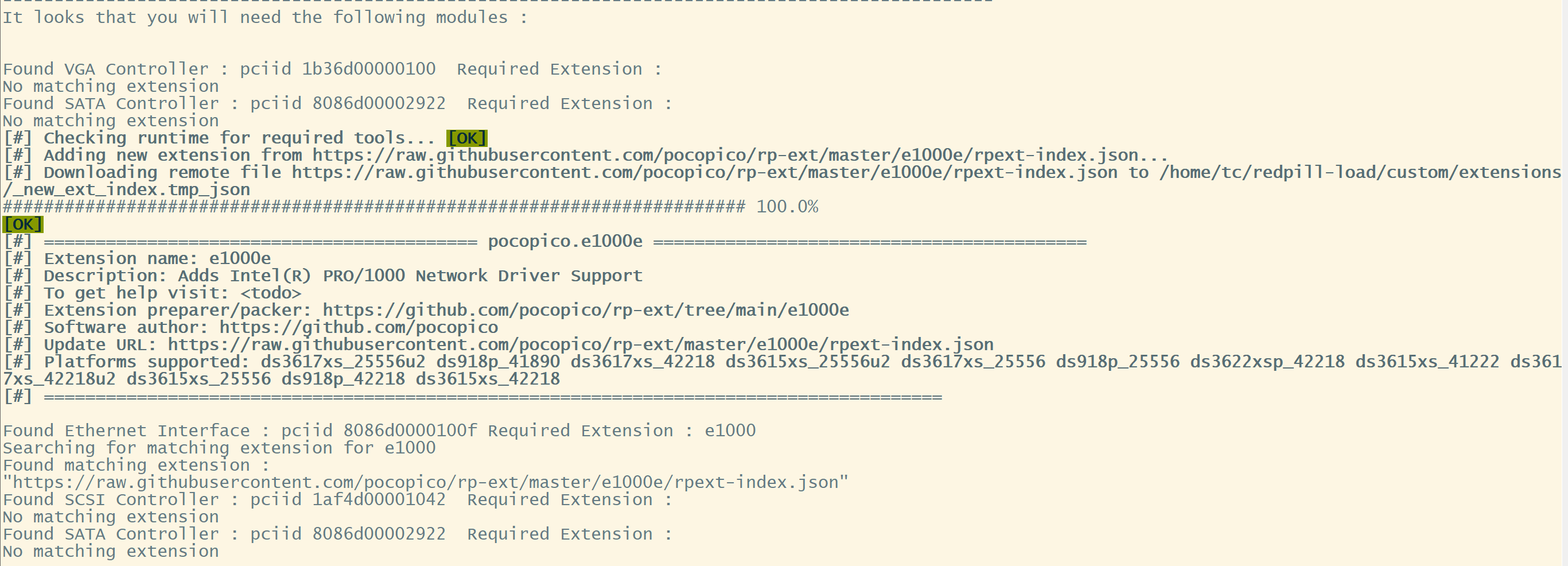

On 2/23/2022 at 5:32 AM, live4soccer7 said:
Yes, I can not get to the gui via the IP nor can I ping it, but I'm not convinced everything else went right up to that point.
Today I have succesfully migrated my testing DSM VM from 6.2 to 7.0.
Run shell on unraid, and run serial console on VM with DSM7
virsh console VM_NAME
you should see xpenology shell, You probably could log in using Your administrator account.
Check /var/log/synoupdate.log, is there any errors?
Check network configuration, is there any ip assigned?
For me e1000e doesn't work properly, it was flapping up and down.
I have added e1000 extension, and set e1000 virtual network card. (what I can see with e1000 down/up speed in GUI is looking properly, but with e1000e and DSM6.2 it shows not possible very high speed for download and upload)
Next thing that was not good in my config was usb device model. When I set it to 'qemu-xhci', everything goes very well.

Hey everyone,
I followed the instructions and was able to get to the find.synology.com and find the machine. But then it tells me, no disks detected. I tried several times, always with that result. Can anyone help and tell me how to fix this?
