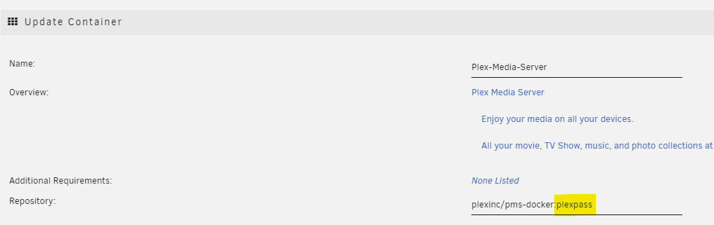

Or if you're using the official Plex container, you can also do this:

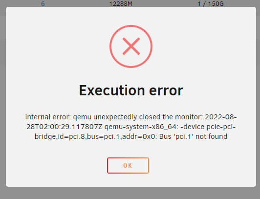

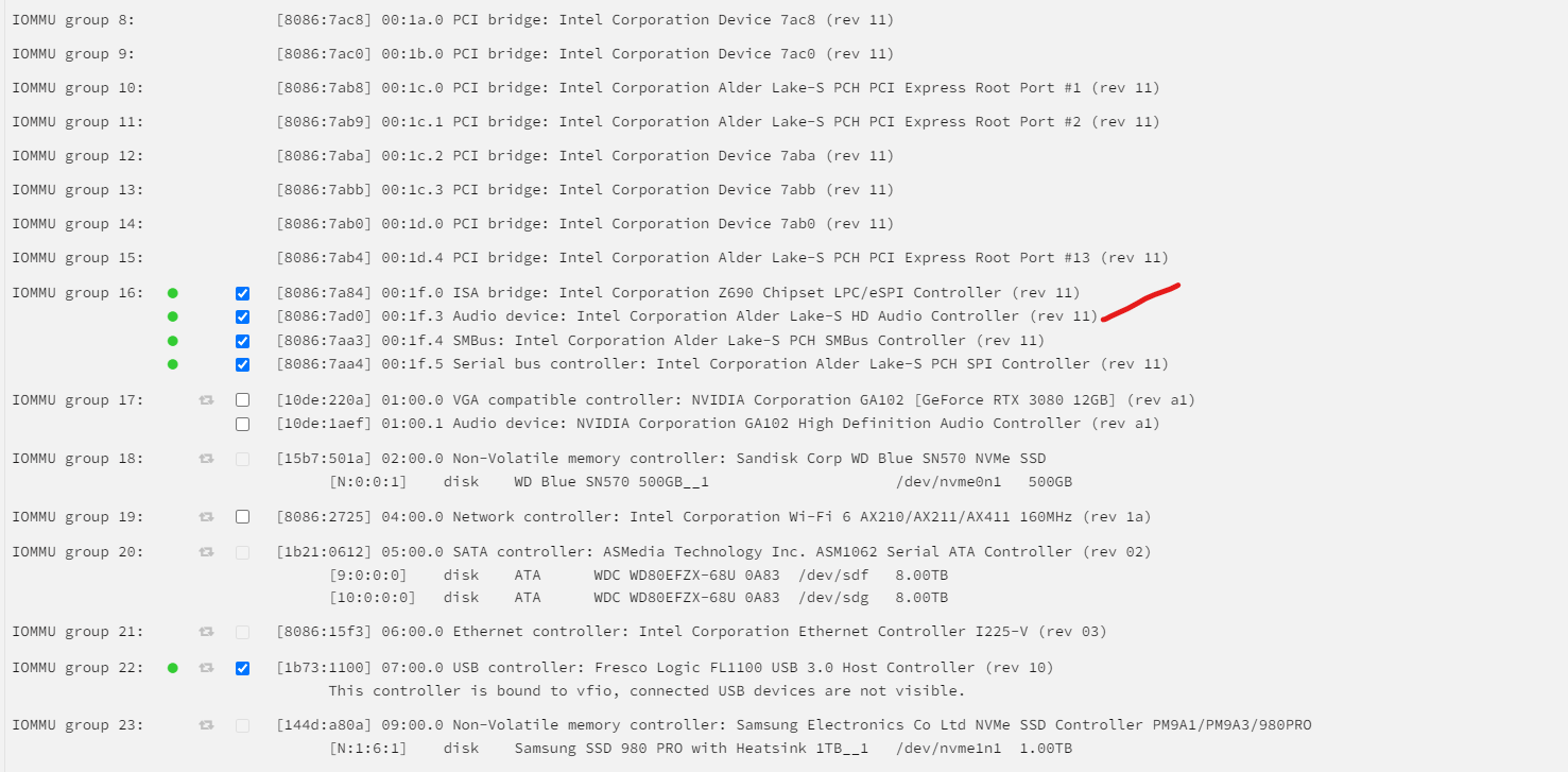

I have tried editing the Flash append:
append modprobe.blacklist=i2c_i801,i2c_smbus initrd=/bzroot but i get error 792246781_Screenshot2022-08-27220045.png.20908937b748b35093f2fbcbad63b47e.png

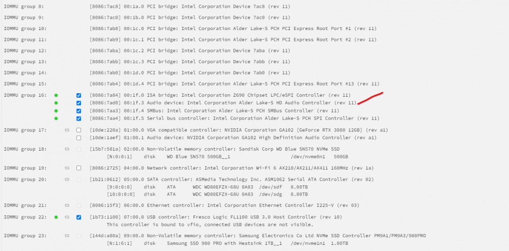

EDIT: I was able to isolate Audio & Mic using
pcie_acs_override-multifunctionvfio_tommu_typel.allow_unsafe_interrupts=1vfio-pci.ids=8086:7284,8086:7ad0,8086:74…modprobe.blacklistsi2c_1801,12c_smbusinitrd=/bzroot
but you shouldn’t use that method on 6.9+, although it did work. The mic was very quiet.
Maybe it’s just best to get a USB DAC for your gaming headset. I got the SoundBlaster G3 and it rocks.
