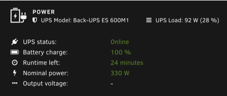

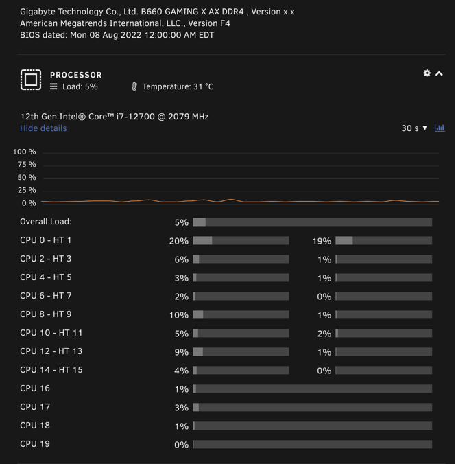

Pretty happy with the power usage on my 12700.   (non-K on purpose)
This is with a Windows 11 VM running with 8 cameras in Blue Iris going, about 20 Dockers, and all drives (4) spun up at the moment:

What do I need to look for in a UPS to pull this kind of data?
APC units are probably the safest bet, but I would imagine others might be supported.
More info here:   http://apcupsd.org/manual/manual.html
