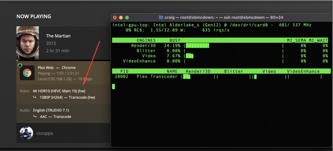

On 9/28/2022 at 11:45 AM, cscoppa said:
Working here too on the i7-12700.
NOTE:  You have to be on the Plexpass version.     ( plexinc/pms-docker:plexpass )
Using the correct image, having installed the intel-gpu-top plugin and gpu-statistics plugin allowed me to see plex hw transcoding. Im running Unraid 6.11.0 with i5-12500T Even ToneMapping works i think, because my test HDR Movie 4K movie i have never seen it this good. Always thought it was filmed in mono chrome cloudy overcast type shots but now i see so much more colors! Great job team!

On 9/28/2022 at 2:45 PM, cscoppa said:
is that capture taken when you first start watching the movie and it's building a buffer, or after?
it's not as staggeringly less burdened than my 7700K as I would have thought:
Still considering upgrading to a 12500/600 as audio transcoding can be a real CPU hog.
I believe I took that screenshot right after starting playback, so it is probably still building the buffer.
