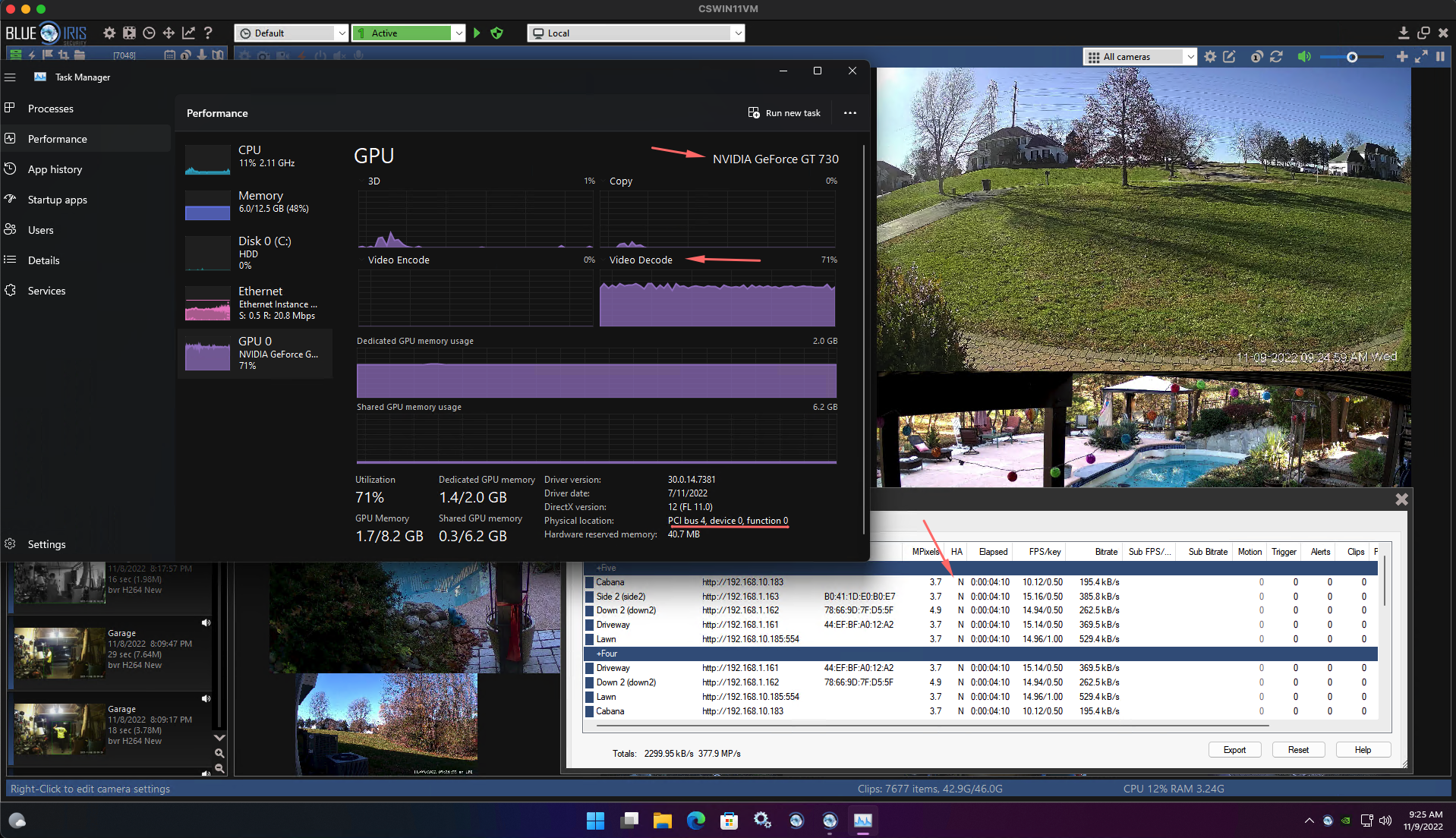

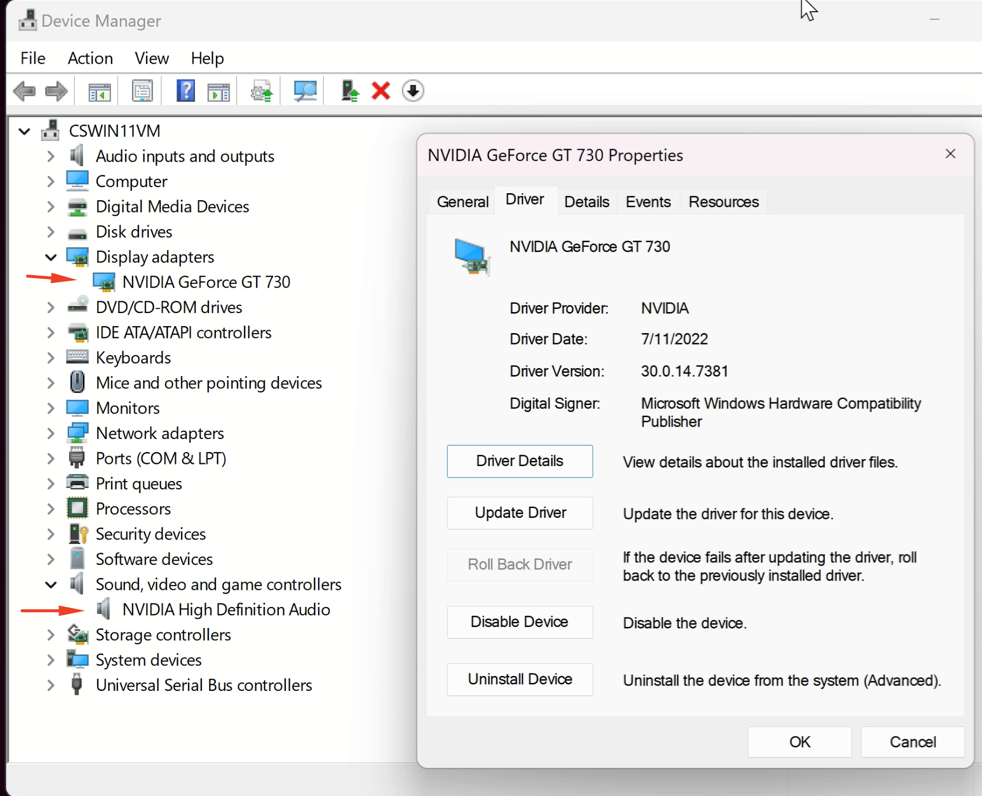

@cscoppa Blue Iris is the reason I want to passthrough the iGPU to a Win 10 VM. Since I haven't had much luck I tried a very old Nvidia Quadro 400 I had laying around for Blue Iris but that was even worse than the iGPU. Was it hard to passthrough your GTX730? I'm getting desperate and may buy a cheapy GPU but want one that will work.
It wasn't too hard, I just had to "force" the driver in by starting the installer, switching to Device Manager, and pointing it at the temp driver install folder to get the driver to go in.

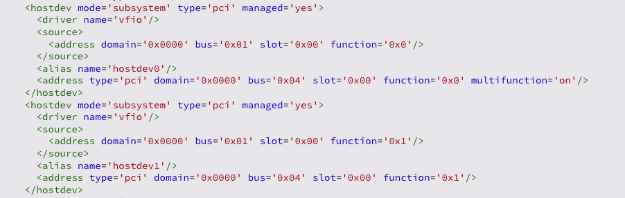

Step 1: Tools> System devices- Bind the GPU

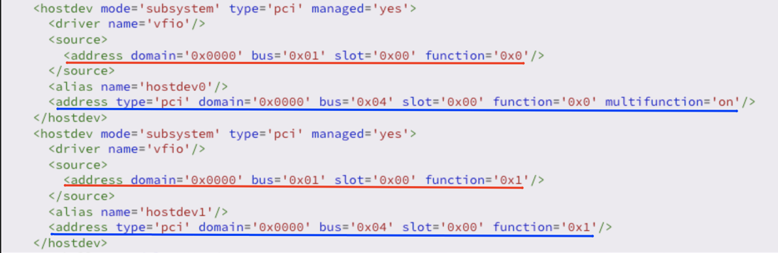

Step 2: VM- I just select the card, Do you modify the XML? Your screenshot doesn't show the GTX730 card..
Step 3: Start the Windows PC and remote in and run the installer then point to the temp folder? Are you saying update the driver for the GPU? Is windows detecting the GPU in your case?
Also, in your BI screenshot HA=N shouldn't it be Y when using the GPU?

I'm not using a ROM file, I don't believe it's needed with my card.  (too old to need one I believe)
For 2 I let the UI create the XML. (in basic mode) ... then I switched to advanced and modified the XML based on some guides / videos I've seen.  Not sure if this is required, as I believe it's mainly to get HDMI audio working.
From what I remember, Window sees the GPU, but it sets it at a Code 43 or something, so I had to force the driver in to get it working.  I downloaded the driver from Nvidia, ran the installer, and then when I knew it had extracted the files to a temp folder, I switched to Device Manager and installed the driver from there, then I just killed the Nvidia installer.
HA=N means Nvidia in Blue Iris ... the "HA" is Hardware Acceleration.  If it wasn't working it shows as a "-" instead.

PS, I color coded my previous screenshot.  The red lines are the "real" location of the GPU and HDMI audio devices respectively.  The blue are the virtual ones that are presented to the VM.  "vfio" is what gets created when you bind the devices in the Unraid UI.

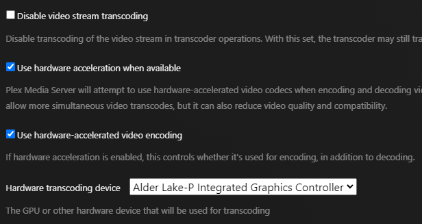

I am unable to get hardware transcoding working at all with an i5-1240P (Alderlake CPU in Framework mainboard). I am able to select the GPU in Plex web config, but it can never actually initialize or use it:

Have you followed the setup instructions and added the device in your Docker config?
Yes, it is in docker config and I am able to select the GPU in Plex web config, but it can never actually initialize or use it
I'm pretty sure intel-gpu-top is still required. Is that also installed?

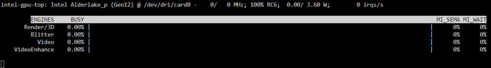

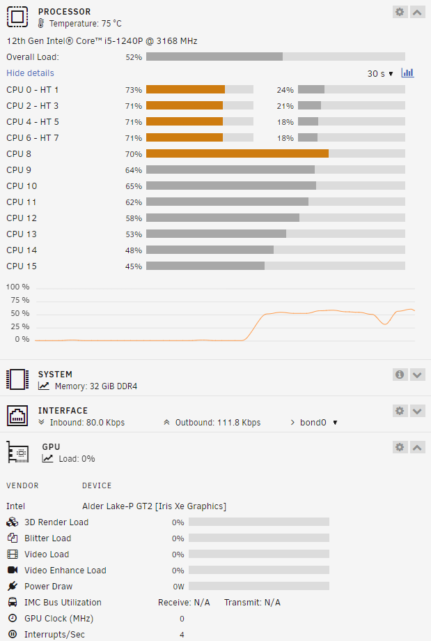

Running Plex with a single transcode, hits the CPU, no GPU usage:
