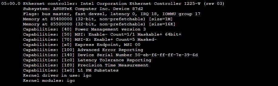

I'm running on RC4 and it doesn't appear to recognize that my nic is capable of 2.5gb. Is there something in particular I have to do?
Which motherboard and NIC type from lspci and the run -v -s and the ID to get driver info.

@SimonFFirst of all, thank you very much for taking the time to help (I'm new and confused). See the attached outputs from running the lspci command.

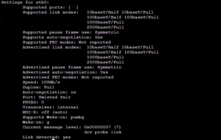

Ok so it looks like the driver is being used on the nic and I have the same nic on my MSI board.
What do you get if you run you will need to select the correct eth number.
