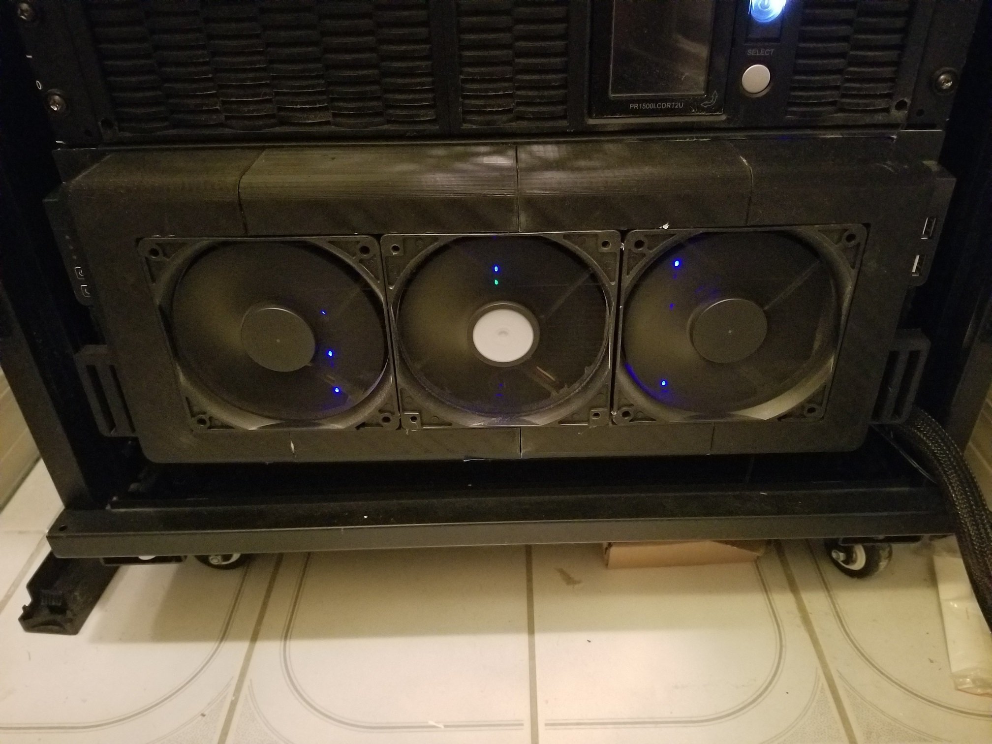

I printed a custom front fan shroud for my 4224, keeps my drives in the high 30's during parity checks (granted, my internal fan wall filled with Noctua fans is always at 100%, so can't help ya there)

That looks  like a great alternative for using when you are rebuilding the parity.  I looked on thingyverse but did not see it.  Are you able to share it? How did you attach it ? Looks like you just screwed it on to the rack.   My only issue would be how do you run power to it?

Here's the 4 STLs if you wanna print 'em. If I wanted to improve on it I'd probably include some interlocking tabs to help with alignment when gluing, but it works as is so meh

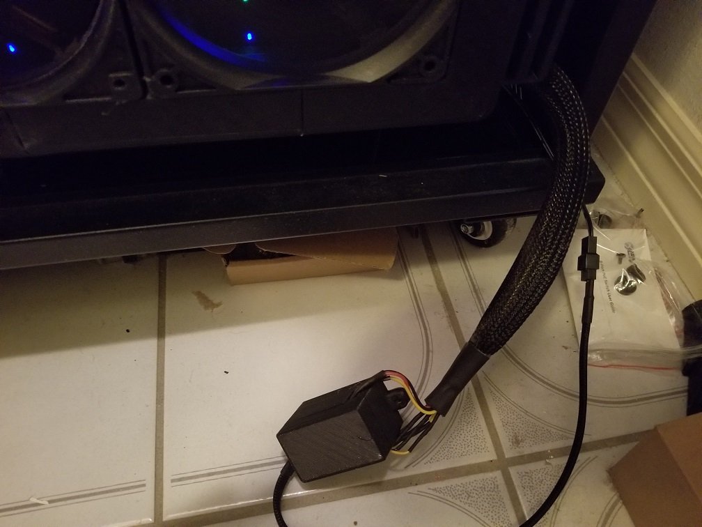

I added tabs on it so it lines up with the 4224's handles to either zip tie or velcro (I went with velcro), powered it via an umbilical cord to an externally powered fan hub

I was able to put in some better fans , however i think i should be sucking air from the outside into the case? I am currently blowing air out over the drives . How are you doing it?
Cool air in from the front, hot air out the back.
