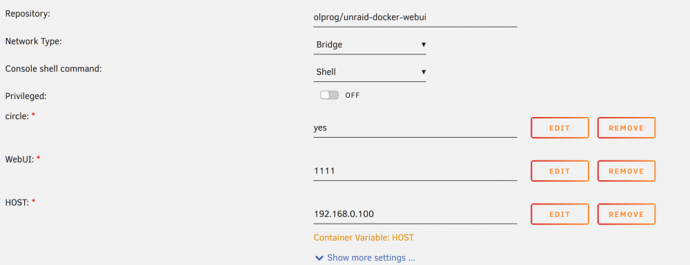

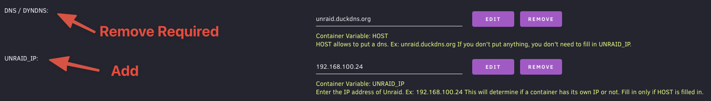

Hello,
I have added a UNRAID_IP variable. It will allow to set the IP address of the server by default.
So if a container does not have the same IP then it will not replace it with HOST.
The template has changed.

Hey, thanks for the active work on this Web-App
I would like to understand more on what these variables are doing internally. I have them both set to the local IP address of server. Some more context may be better for understanding.
Also, how can I change the title of your page "Docker Web UI" to what I want to? as I keep this tab open all the time and would like to rename to something I can quickly get to.
Thanks for the app again.

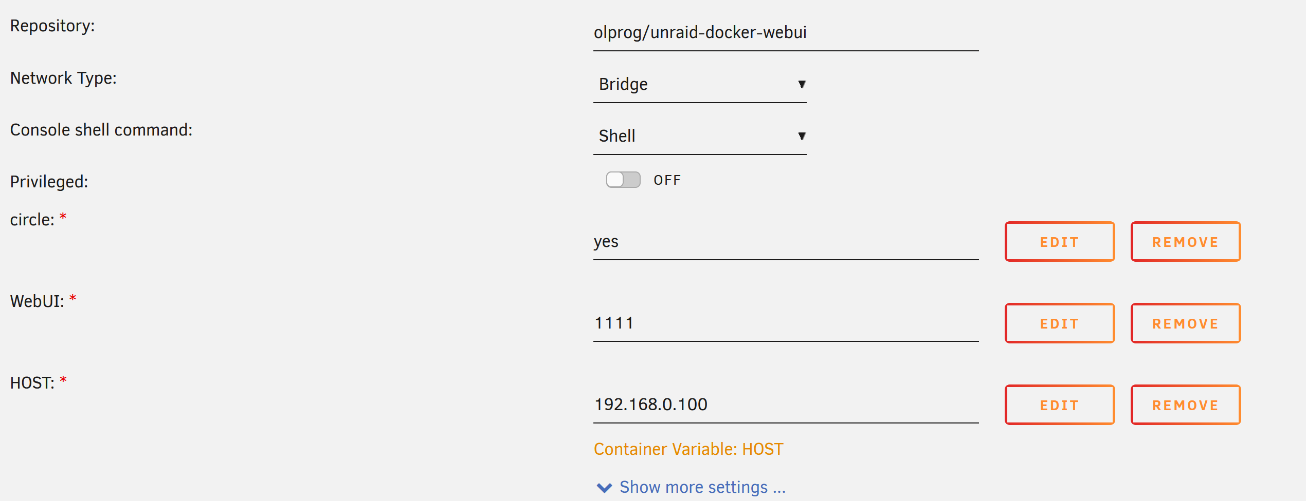

I'm watching this this weekend. I'll explain it a bit better and put another environment variable for the page title.

I added a TITLE variable to change the title of the page. By default, I left Docker WebUI. I also changed the description on page 1. I hope it will be newer understandable on how to use the variables.
If you want to see newer, go to the BitBucket
